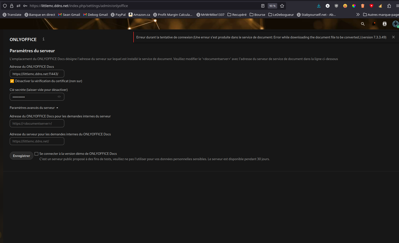

Well hello there. It seems I’m a bit of a pickle… I’m trying to connect my Nextcloud server (version 24 the latest) to Onlyoffice (latest) both running on the same server Inside a Ubuntu server 22.04 VM in proxmox but get this weird error everytime.
My nextcloud server runs natively on apache2 with ufw allowing all ports I need) but I decided to run OnlyOffice inside a docker using a different port than the default one since 443 is already used by my NC. I can access both server with my domain name and both can be accessed using SSL/HTTPS from outside my network. Using a rapidssl cert.
Whenever I try to link both server together, I get this error:
Error while downloading the document file to be converted.) (version 7.3.3.49)
Not sure what’s going on as both servers runs just fine on their own and can be accessed from outside. Heres what I get in logs.

Ok, I’ve been able to fix my issue. Always verify your SSL Certificate. Mine was missing the CA Authority and by not having it configured in Apache, blocked the connexion.
A good tools to check if your ssl certificates is properly installed and configured.

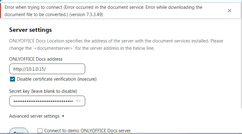

Hello, i upgraded onlyoffice-ds to 7.3.3-49 and postgresql version 13 on centos 7, but error not fixed yet. Kindly see some of my config and error screen.

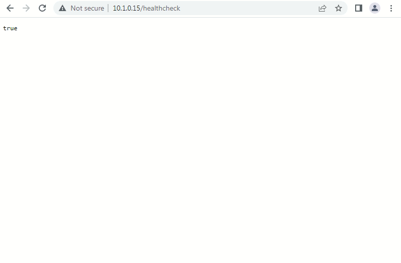

Please check http://<document_server_address>/healthcheck page and share the output.
Additionally, execute this command bash /usr/bin/documentserver-update-securelink.sh and check the situation again.

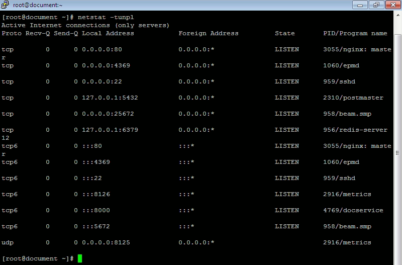

#Running Services and Ports on Document Server#
Regard with thanks

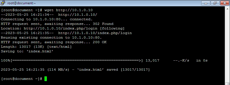

Also, run an accessibility test:
  • execute wget <document_server_address> from Nextcloud server;
  • execute wget <nextcloud_address> from the server where Document Server is installed.
After that share outputs of these commands.
Dear @Constantine , Nextcloud version : 25.0.6 and Connector Version: 7.8.0. Kindly see attached screenshot of wget cross test.
Regard with thanks
#wget from nc to ds#
Thank you.
Actually, this command is used for Docker installations to restart Document Server services. Did you use it after changing JWT header in local.json? If yes, then try systemctl restart ds-* and check if you can connect afterwards.
Dear @Constantine , i also used that command after changing local.json, systemctl restart ds-* and systemctl restart nginx, but error not fixed.
Regard with thanks
Please run another test and disable JWT token for Document Server and remove 'jwt_secret' and 'jwt_header' strings from config.php of Nextcloud and retry.
To disable JWT on Document Server side change next parameters in local.json:
      "token": {
        "enable": {
          "request": {
            "inbox": false,
            "outbox": false
          "browser": false
And restart Document Server services with systemctl restart ds-*.
Also, after attempting to connect and if it does not succeed, check logs of Nextcloud and provide them too.

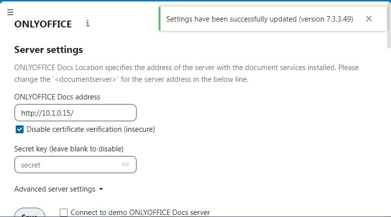

Dear @Constantine , after disabling JWT as per your instruction, NC connected to Onlyoffice Document Server.
Thanks you so much for your support.
Regard with Thanks
