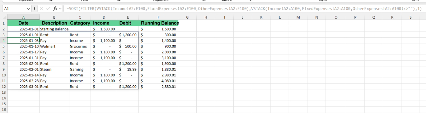

As for bug#1 I’ve recreated the file using only Excel (latest version of Office365) and it does not produce the #NUM characters. Below is a screenshot showing the formula is the same (except it has 3 tabs in the VSTACK vice 2. But as shown no #NUM are showing and no filter is appled. The source file is attached below. Hope that helps but let me know if I can provide any other information.
SampleVstackIssue - ExcelOnlyVersion.xlsx (13.4 KB)
