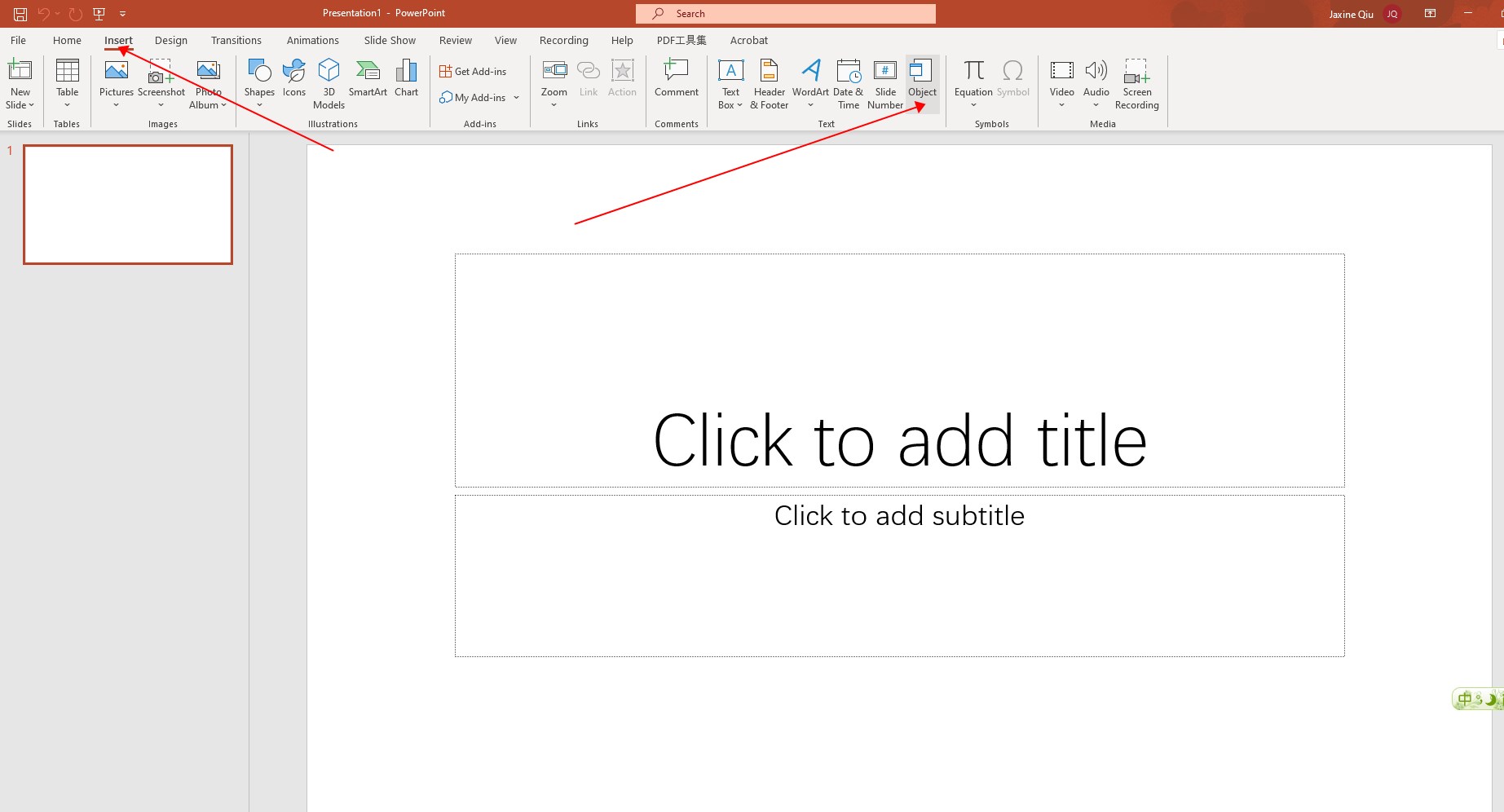

The Chinese name of the attachment is garbled in the ppt file, refer to below screenshots.
I created new PPT file by MS office , inserted the attachment file (pdf, xlsx) with Chinese name , saved it, and then uploaded to onlyoffice self-server.

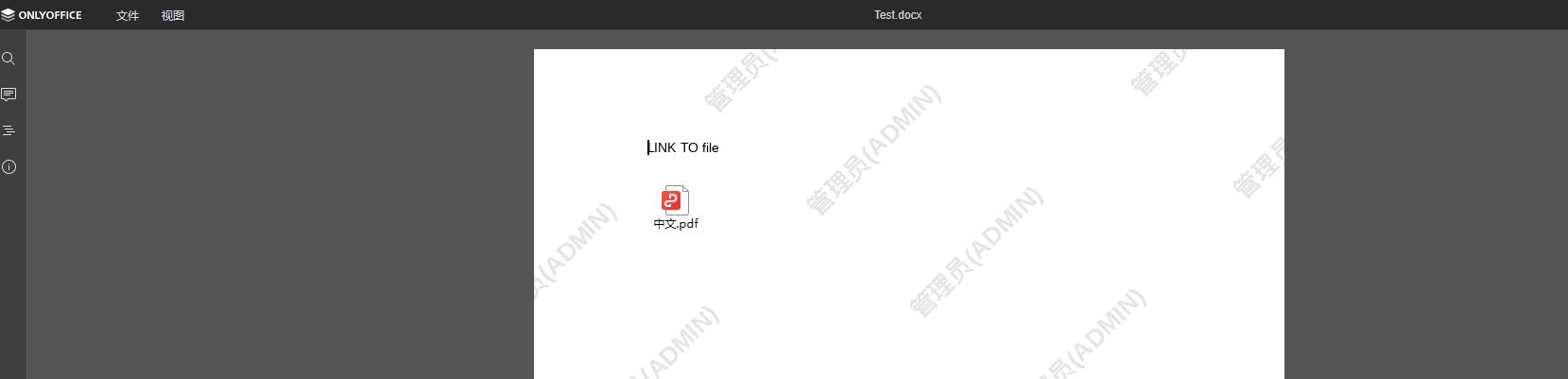

But the file with Chinese name was inserted to Xlsx or Doc file, , it could be displayed Chinese name.
So I don’t think it is problem of INSERT OBJECT feature.
Test.docx (39.1 KB)
test.xlsx (18.8 KB)
