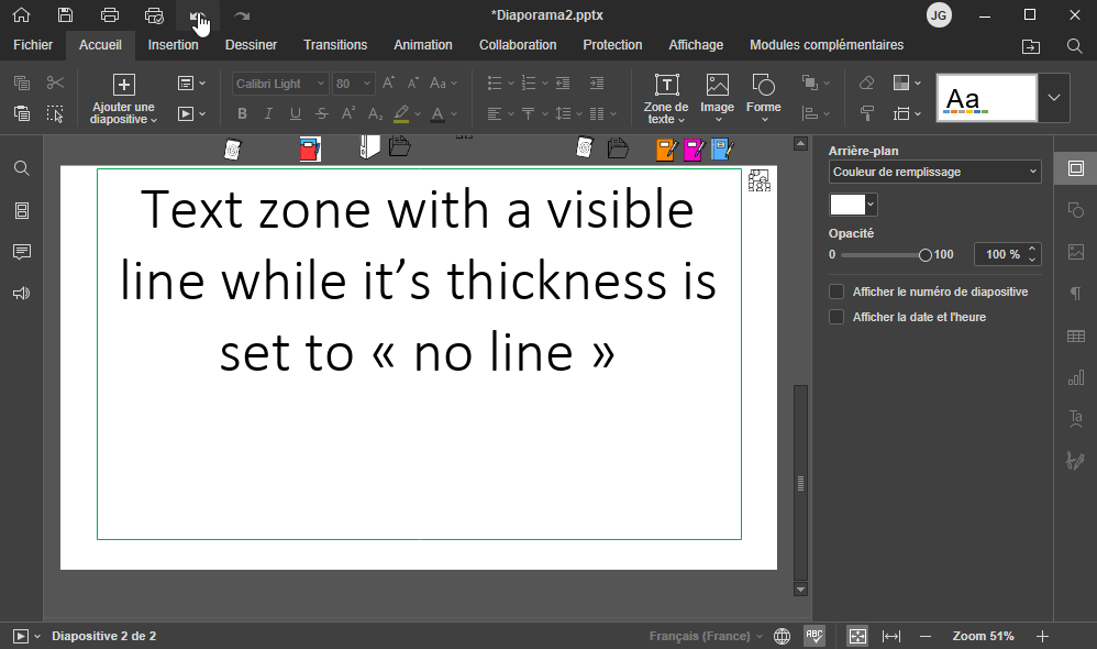

Presentation - despite thickness set to 0, a text zone with the border shows a border
Hi,
See below :
editors_20231015-14h01min00s
File with the issue :
OO- border thickness.pptx (27.7 KB)

This one is interesting, so interesting, I had to have a look.
It does seem to be a bug in OO shape rendering code, where it is failing to process this section correctly.
<a:ln w="0">
	<a:solidFill>
		<a:srgbClr val="00B050"/>
	</a:solidFill>
</a:ln>
The line width, w=ā€œ0ā€, set in the <a:ln/> tag, is obviously specifying a zero (or none) width line with a green (#00B050) colour.
The presence of a colour seems to be enforcing a minimum width of 1px with the shape renderer.
The line can be made to disappear, but one has to change the line width to a non-zero width, set it to a null colour and then it can be reset back to a zero width and it will no longer display, nor displace any space.
OO’s shape configuration will not accept a colour change unless there is a non-zero width specified. That too may be a bug in the UI controls.

Hello, @arcqus a couple of things in the file you provided are not entirely clear.
  1. Was the document created in ONLYOFFICE Desktop Editors?
  2. How was the border added (the sequence of actions to reproduce the issue)?
  3. In the GIF, it’s evident that after changing the line size from ā€˜no line’ to ā€˜0.5 pt’ and back to ā€˜no line,’ the line disappears.

The attached document was created in OO. BUT the slide was copied from a doc having the issue, doc created in MSO (without the issue), then copied/saved as a lot of times in OO (I create one file per day by copying the ones from the previous week). The issue is new to the last OO version.
The border was created in the original file (so back in MSO).
Then one day, OO decided that is should have this weird border.
Yes, it was to show you that it was no blocker, just a little pain being solved by changing border parameters.
