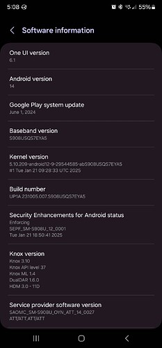

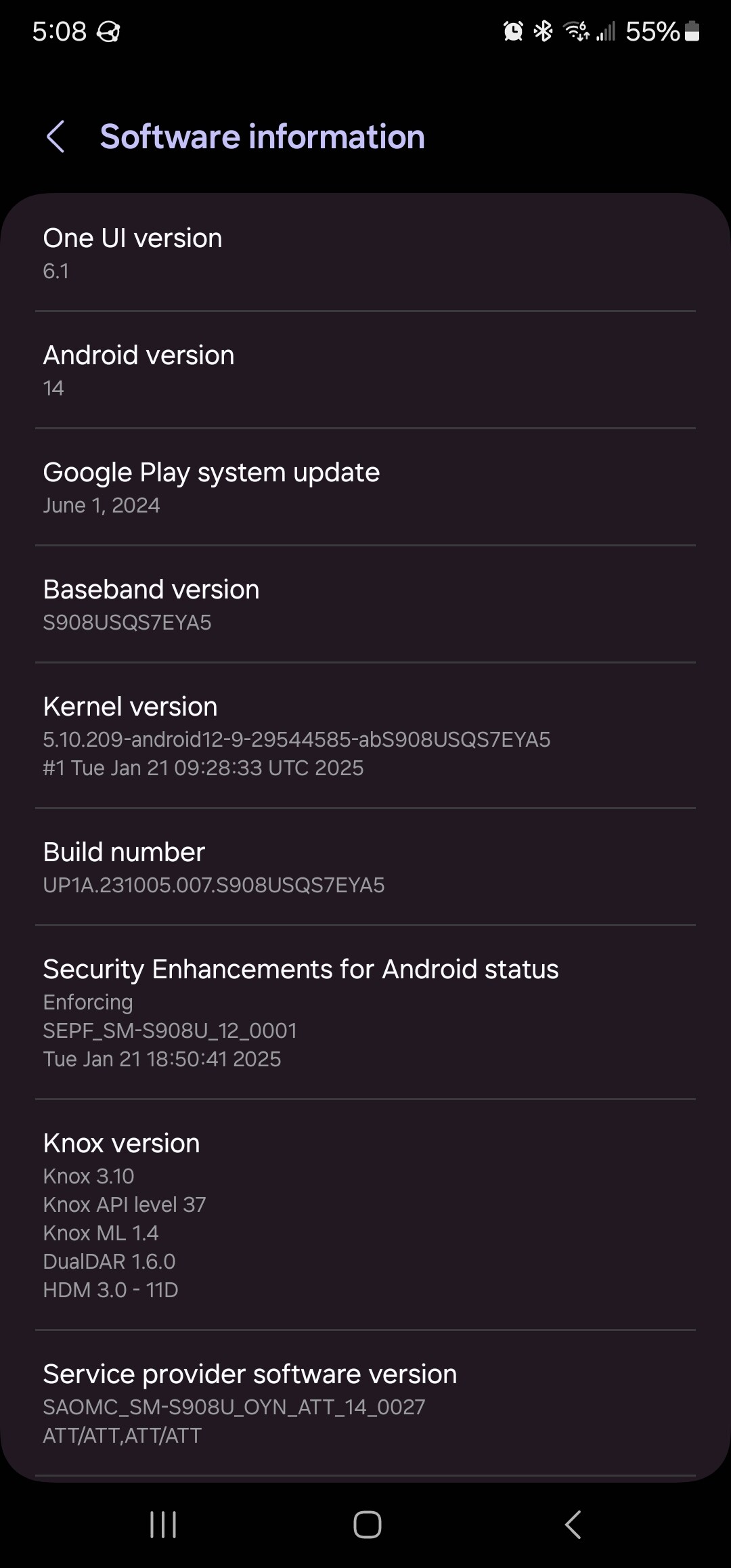

Hi Alexandre
I have attached a screenshot with the software info from the phone. Screen_Recording_20250313_164828_Messages.mp4 - Google Drive that’s a link to the video requested since the forum won’t left me upload it. Gboard is Version 15.0.10.717871796-release-arm64-v8a.
Please let me know if you need any further information. I really like onlyoffice and want to move to it across all platforms.
