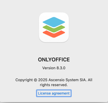

The original issue remains. The on-screen progress message during the update process still referred to v.8.0 and the Dock icon post-install still displays 8.0.
The correct version displays only within the app:

Can you please right click the Desktop Editor shortcut on your Dock, then go Options > Show in Finder and check out how the app is named there? It mostly seems that it was intentionally renamed previously as I was not able to reproduce the situation with older versions of macOS.
Thanks, the Finder also identifies v.8.3 as 8.0
