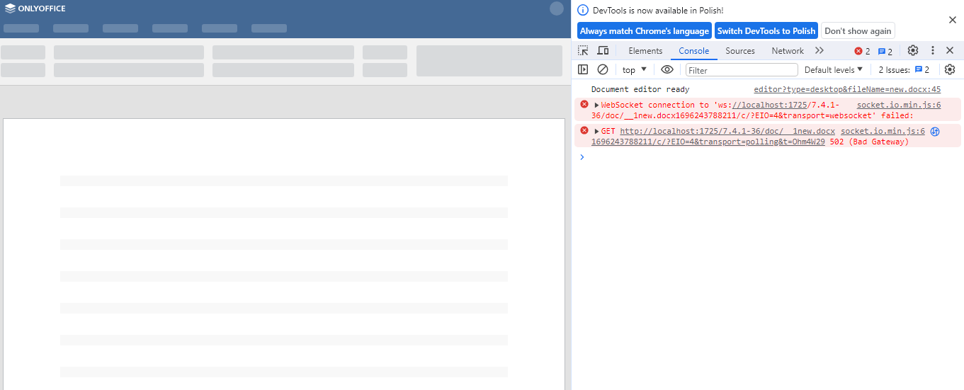

I installed OnlyOffice Community Document Server on Windows 10. When i try to run example i console log i get error
socket.io.min.js:6 GET http://localhost:1725/7.4.1-36/doc/__1new.docx1695889964353/c/?EIO=4&transport=polling&t=OhRICFA 502 (Bad Gateway)
socket.io.min.js:6 GET http://localhost:1725/7.4.1-36/doc/__1new.docx1695889964353/c/?EIO=4&transport=polling&t=OhRIF3p 502 (Bad Gateway)
My address is http://localhost:1725 , not http://localhost:1725/7.4.1-36 .
I don’t have folder 7.4.1-36 in my onlyoffice.
Where is the problem. What should i do?

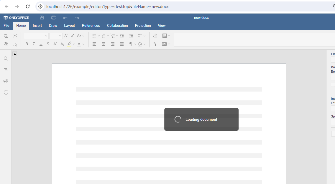

Now its work. I had to reinstall postgress. But i have another problem. Example document is loading incessantly.
I don’ get no logs in log folder and console.

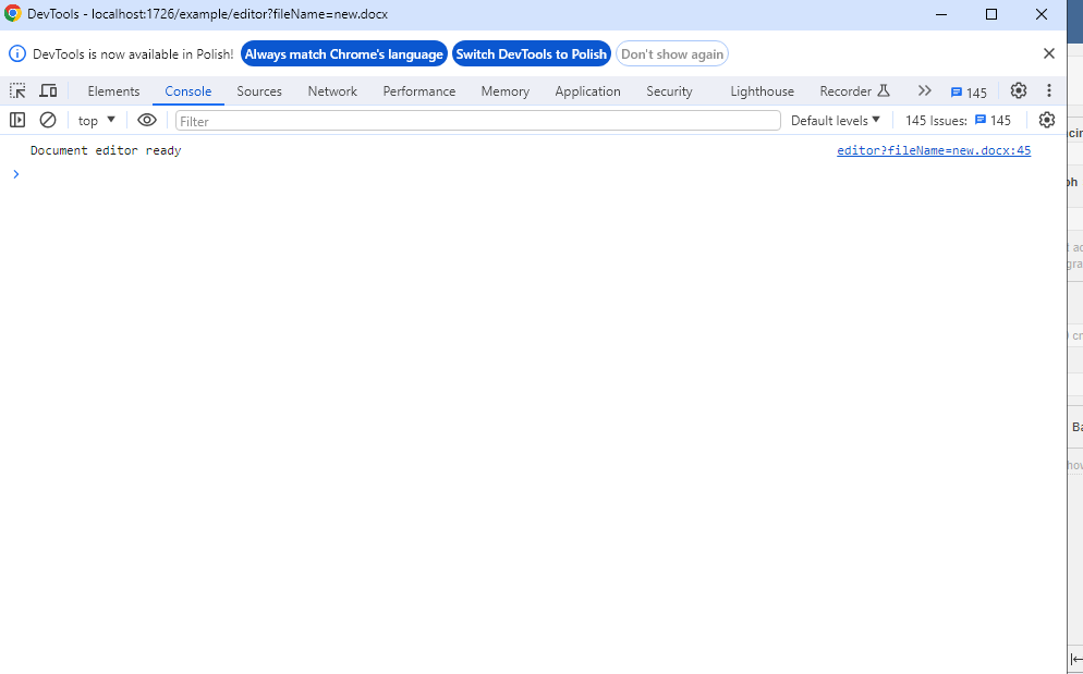

Have you checked Console and Network tabs? If haven’t, please show us if there are any error entries.
Here is screenshots from Consol. Logs on serwer are empty (0kB) .
Communication with Postgress (ver 16) is correct i think. I have data in onlyoffice tables.

I uninstall and install all applications and set configurations from Installing ONLYOFFICE Docs for Windows on a local server - ONLYOFFICE. Download onlyoffice community from Installing ONLYOFFICE Docs for Windows on a local server - ONLYOFFICE for Windows Server. Unfortunatly is nothin changed. Example document is loading incessantly.

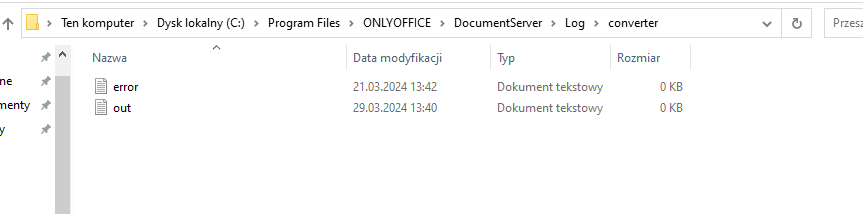

Logs are empty. Screenshots in attachments.

I dont’ have any errors during the installation process. I attach Log archive (you have to change odt extension to 7z extension . The forum does not allow attaching zip ,tar, 7z files).
After run first docx document (archive LogAfterFirstRunNewDocument.zip) in LOG/docservice/out.log i got :
