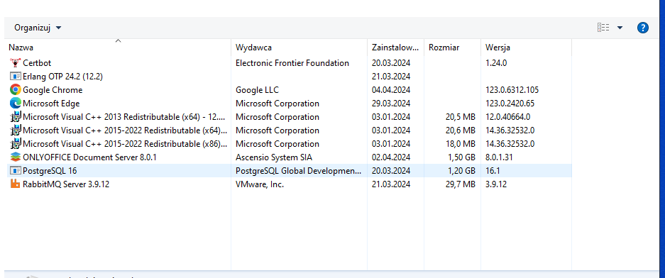

There have’n another application on the server except OnlyOffice and necessery applications (screenshot). This server is used to work OnlyOffice application only.
Processor : ntel(R) Xeon(R) CPU X5650 @ 2.67GHz 2.67 GHz
RAM : 7,99 GB
Increase RAM to 16G but it didn’t help

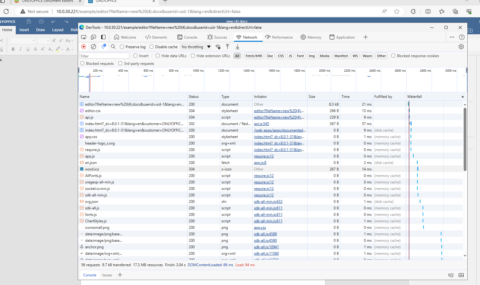

Logs are once again empty which is strange. To get more info please do the following:
  1. Open a document from integrated test example for editing;
  2. Once new tab with loading document is opened press F12 to open DevTools;
  3. Open Network tab and reload the page;
  4. See which resource is not loading and share a screenshot with information about it.
I attached screenshots

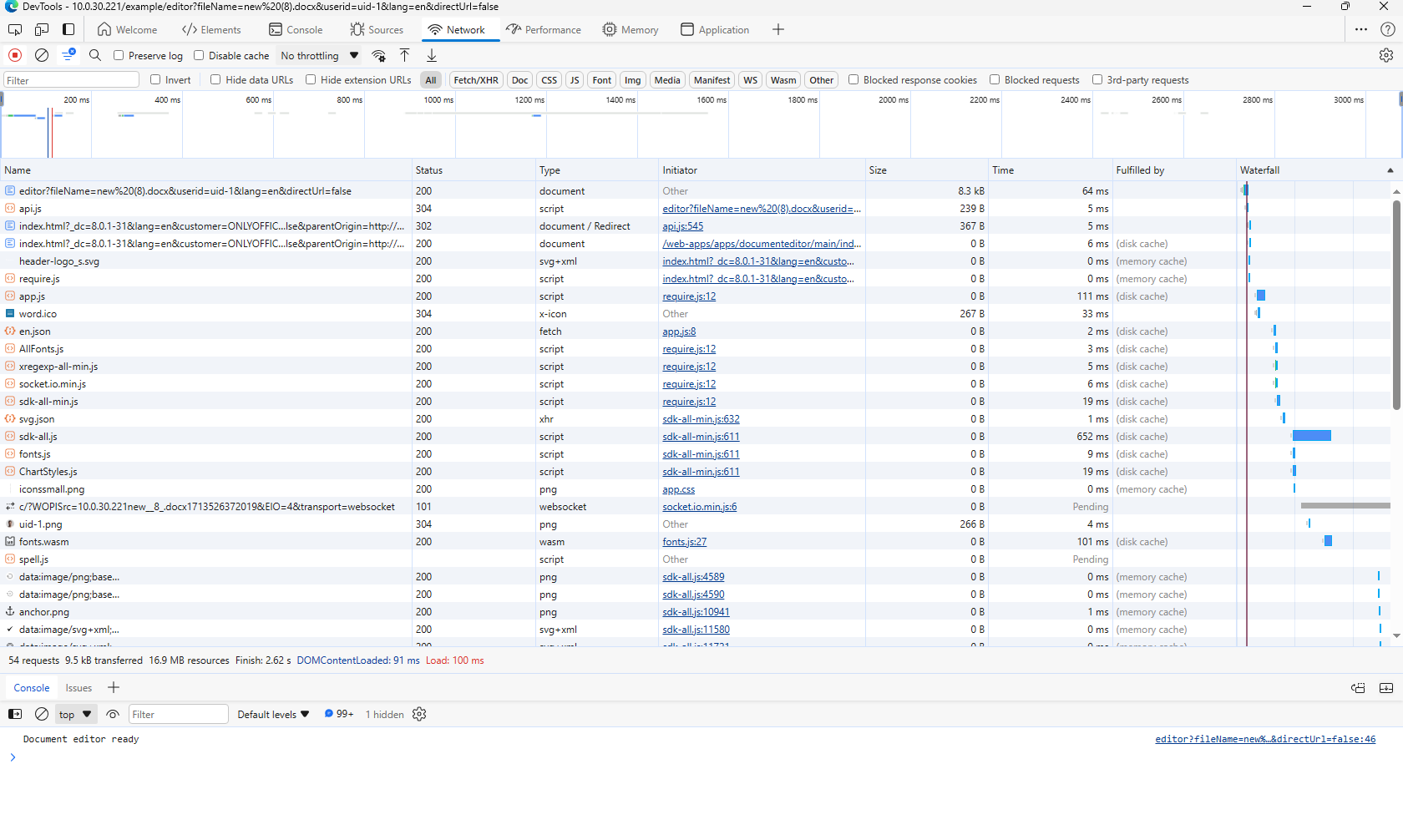

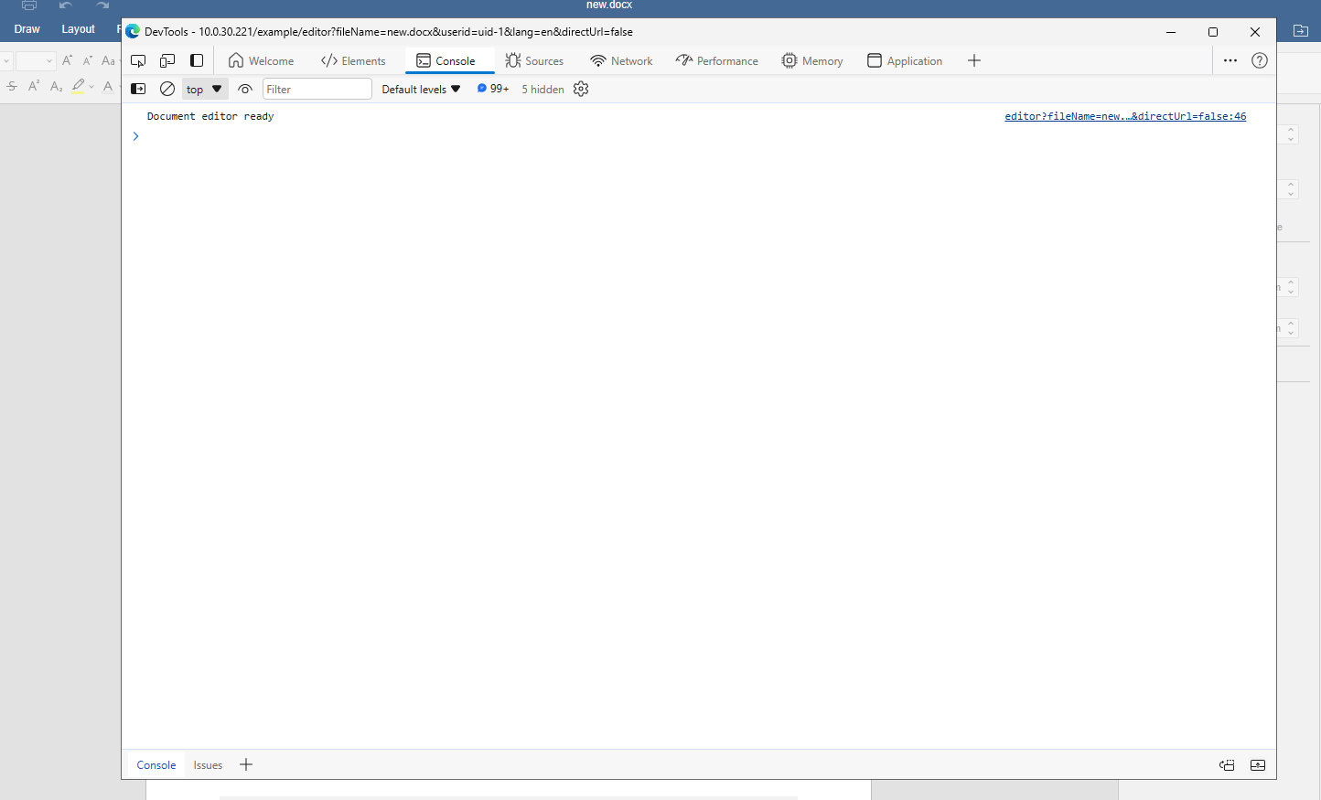

I think some details are missing from DevTools console. Try the following:
  1. Open a document for editing via integrated test example;
  2. Wait for the page to load;
  3. Open DevTools (F12);
  4. Reload the page with opened browser console.
After that provide a fresh screenshot with errors.
Below are attachents
Sorry, I forgot to mention to also provide screenshots of Console tab too.

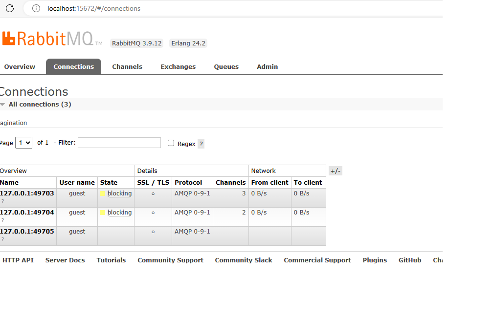

Editor is loading endlessly for new created and uploaded files. All ports are opened , but RabbitMQ blocks connection . I don’t now why ar blocked and i don’t know how to unblock connections .Firewall is turn off , OS is empty .Are installed OnlyOffice and necessary applications to Only Office work correctly.

Hi
It’s work correctly in default and custom port. My friend unblock RabbitMq connections by changed {rabbit, [{disk_free_limit, [500000000]}]} parameter from 0 to 50000000.
Thanks for help.
I’m glad to know that it works now, good job!
May I ask you to provide more details on how did you unblock connections to RabbitMQ? I’d be useful for others who experience same issue.
To unblock ports he changed parameter from
{rabbit, [{disk_free_limit, [0]}]}
to
in C:\Users[user]\AppData\Roaming\RabbitMQ\advanced.config file.
