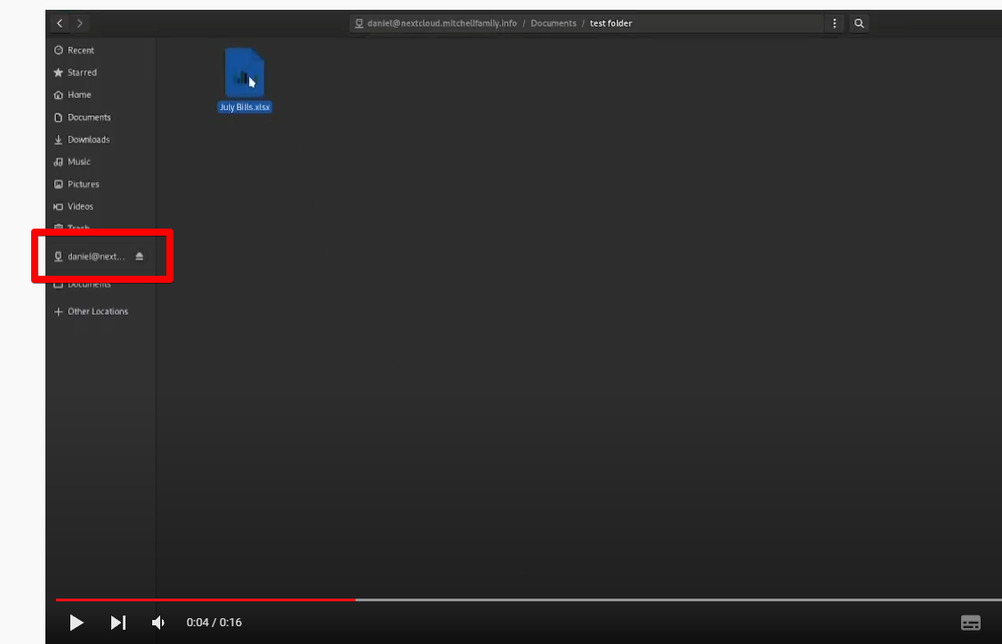

here is a video of the issue

Hello @D4vastu
How exactly have you mounted this path?
Do I understand it right that you have connected Nextcloud storage directly to Fedora filemanager system?
That is correct, I have my nextcloud account connected via the online accounts setting in fedora
I have connected Nextcloud storage via webDAV to my Fedora 36 machine, but unfortunately, I’m still not able to reproduce the issue:
Please let me know how exactly you connected Nextcloud storage to Fedora File manager system.
I went ahead and removed my nextcloud account from my machine from the online account section. I re-added it through the settings and experienced the same issue. I then took the spreadsheet file and moved it to my local documents folder and the document opened as expected. just let me know anything else you want me to try. I also sync my nextcloud with my win11 machine and that file opens as expected with the desktop editors program there.
