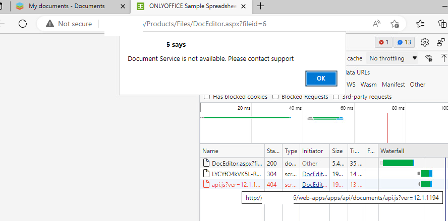

I read some of the article/forum that Community workspace is a ready to go server with document server built-in (i might be wrong). i setup the server changing the configuration file (web.appsettings.config) to include the same localhost information (i can’t use the GUI due to an error message “API URL : Service not defined”).
Try to open the sample document, then got an error message (i have attached the screenshot). Seem like DS wasn’t come in the Workspace package?
Hello @funmix
This is true that there is a Document Server built into ONLYOFFICE Workspace.
However, it is locked to be used only inside the Workspace bundle and cannot be used outside it.
We recommend you to revert the changes made to web.appsettings.config to avoid issues with access to it via Workspace environment.

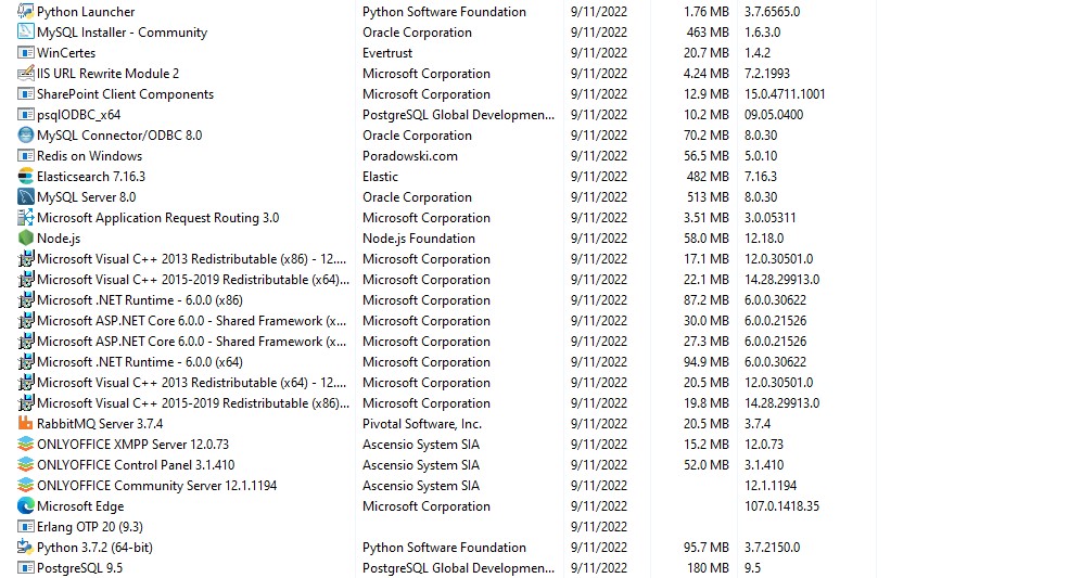

Could you please make a screenshot of the Windows control panel with installed ONLYOFFICE apps?
With admin account we can run some tests, so if it is possible please send me credentials to enter the portal with admin account via PM.

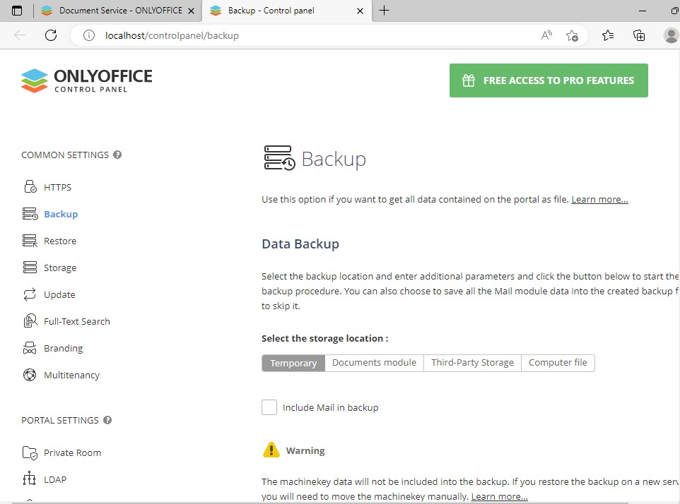

Hi @Constantine
Is this the Control Panel?
The portal is not publicly published, I believe you are not able to access it from external network.
Thank you.
You have sent the screenshot of the Workspace’s Control Panel.
I asked you for a screenshot of installed ONLYOFFICE apps on your Windows Server. Please open Control Panel on your server, navigate to ‘Programs and Features’ tab and make a screenshot of installed ONLYOFFICE programs.
Hi @Constantine
Apologize for that. I misunderstood the meaning.
Here you go.
Thank you.
As I can see the Document Server is missing in the list. For some reason it was not installed or was removed.
Please use this link to the installation .exe file and run it again to install missing components:
https://download.onlyoffice.com/install/windows/workspace/ONLYOFFICE_Workspace_Win-install.latest.exe?_ga=2.202603089.119941339.1667917247-771655801.1666685440
