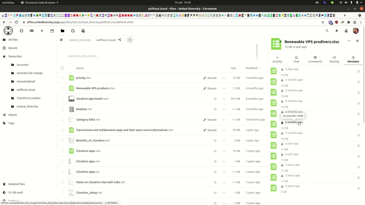

I just tried to restore a previous version of a file in Nextcloud and it didn’t work at all.
Even worse, the version I tried to restore is now no longer listed in the versions at all, so now I can’t even find the version I want to restore!
Document Server version: ONLYOFFICE Docs 6.4.2
Type of installation of the Document Server (docker, deb/rpm, exe): Cloudron package cloudron / onlyoffice-app · GitLab
OS: Ubuntu 18.04
Browser version: Chromium Version 97.0.4692.71 (Official Build) snap (64-bit)
Nextcloud 22.2.3
Nextcloud ONLYOFFICE connector app: 7.2.1

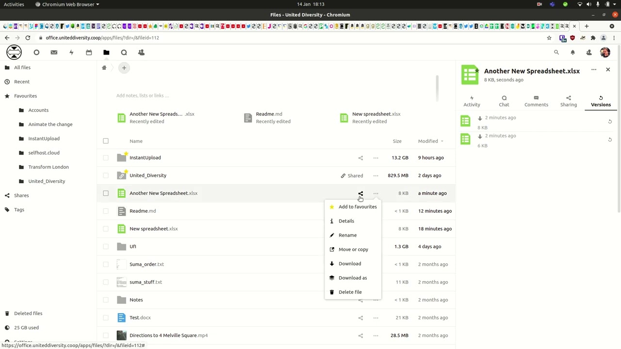

I just created a new spreadsheet and was able to reproduce this. I’ll do more testing to see if I can narrow it down a bit more too…

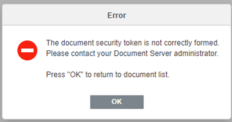

I’ve set up test server in Docker on my local machine (Nextcloud 24.0.5; Onlyoffice Document Server 7.2.1; Onlyoffice-nextcloud connector app 7.5.6; Groupfolders app 12.0.2), and here is what I’m facing. When I try to open the file from Nextcloud, I get such error:

This is different issue. We enabled JWT in v.7.2, so probably this error is related to it. You have to check that JWT secret matches on both sides (on the Document server side: /etc/onlyoffice/documentserver/local.json file and on Nextcloud connector app page: Secret key box).
Let’s focus on this issue first. When we solve it, we will continue troubleshooting version history situation.
Fixed that by adding secret from local.json to the secret key box, thank you!
