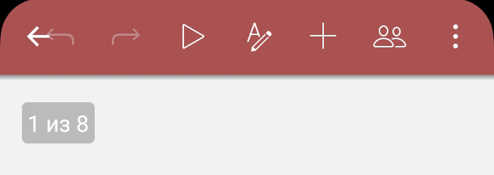

This issue with the ‘back’ buttons overlap still persists, yet. Both Redmi 5 and Redmi 12C are affected. This issue is easily reproducible on any device which screen is much taller than wider:
Screenshot_2024-02-09-09-48-35-815_com.onlyoffice.documents|690x244
Thank you for providing the feedback. We keep on analyzing the issue.

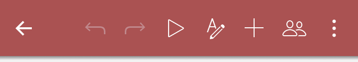

I updated the app today (to version 8.0.1 build 533), the buttons layout is good on the Redmi 5, too:
So the issue is now fixed on both devices. Thank you for the feedback.
