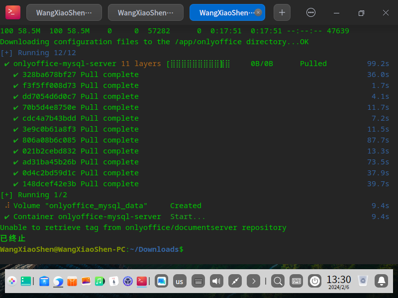

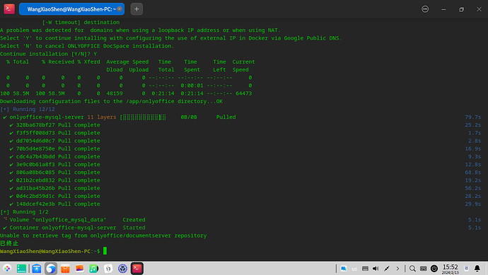

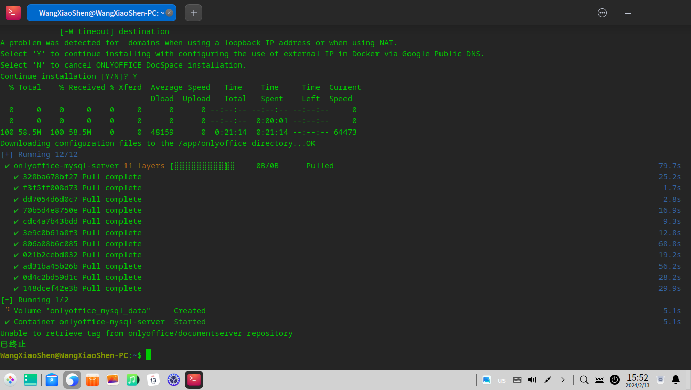

Unable to retrieve tag from onlyoffice/documentserver repository [China]

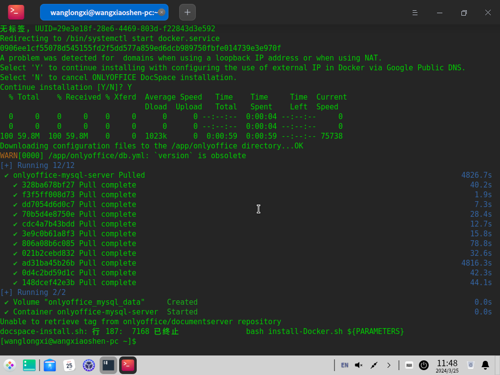

Go on with the Failed to install on my DeepIn(Linux) topic.
After I tried repeatedly, I finally installed Docker version 25.0.2 on my Deepin OS 20.9 successfully. Then, I tried to install ONLYOFFICE Doc Space Server using docker, but it came out a failure result, as shown in the snapshot attached here:
How to make it able to retrieve the tag?
hi @VincentYoung
Please execute the following command:
docker --debug pull onlyoffice/documentserver
It seems that there might be an issue with connecting to the repository.
我也出现了这个情况,目前还没有解决。

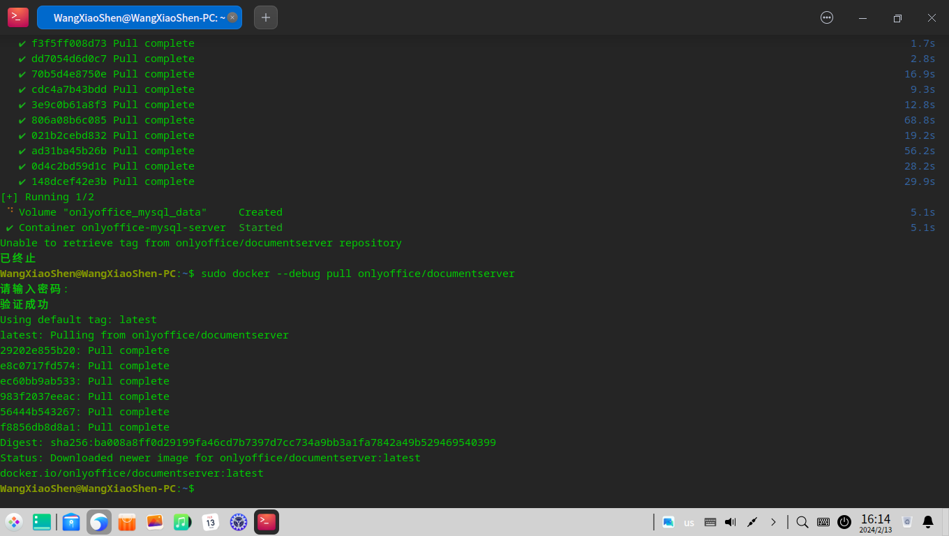

sudo docker --debug pull onlyoffice/documentserver
it seems all right, and then, I repeat the command before this:
sudo bash docspace-install.sh docker
and still got the error:
the same with @touma

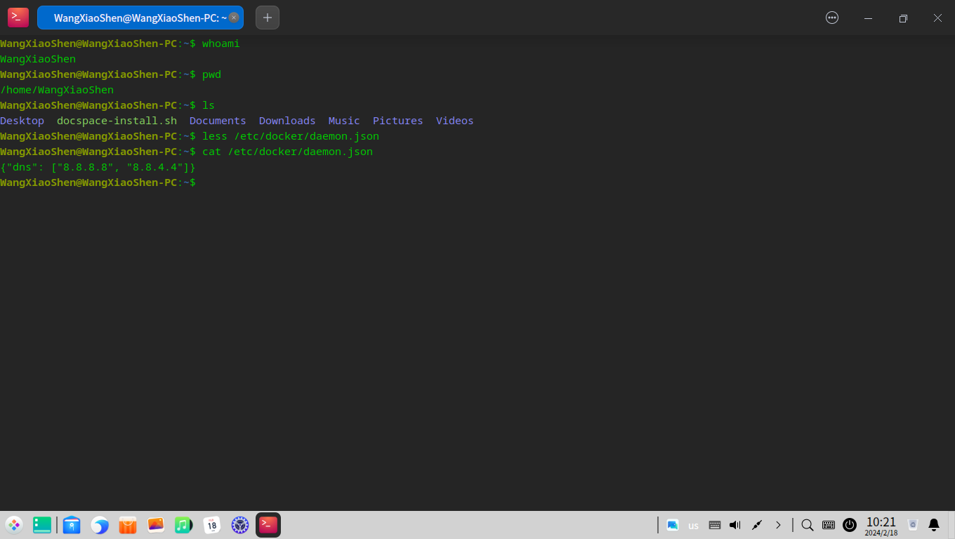

Hello, @VincentYoung @touma
Please provide some additional information about:
  1. Do you use mirrors for Docker, for example: https://docker.mirrors.ustc.edu.cn/?
    1.1. May I ask you to modify the Google Public DNS to the ones you are using in the file /etc/docker/daemon.json?
1, I didn’t use any mirrors for Docker
1.1, here is the snapshot of this file, how do I modify it to the G00GLE ones?
Hmm, it seems the issue might be due to our different locations.
Please run the following commands and show me the results:
  1. Run this command to retrieve the list of available tags for the ONLYOFFICE Document Server from Docker Hub:

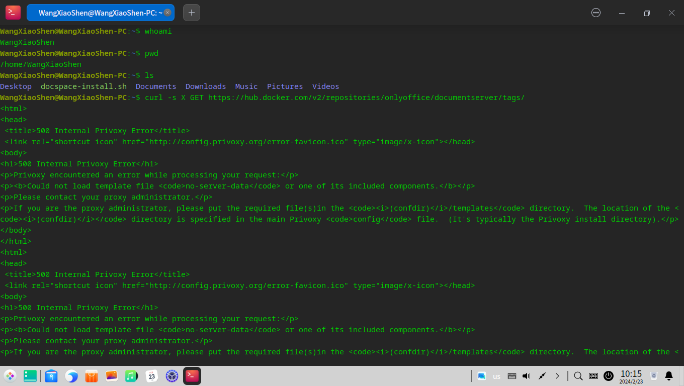

    curl -s -X GET https://hub.docker.com/v2/repositories/onlyoffice/documentserver/tags/
  2. Run this command to execute the installation script for DocSpace using Docker:
    sudo bash docspace-install.sh docker -x
After verification, it has been confirmed that configuring a proxy for the system enables scientific internet access, and the installation can be completed successfully
1,

There have been issues with the Privoxy proxy server.
It seems that when using the script, there’s an error when trying to make a request to https://hub.docker.com/v2/repositories/onlyoffice/documentserver/tags/ and it can’t continue executing the rest of the script.

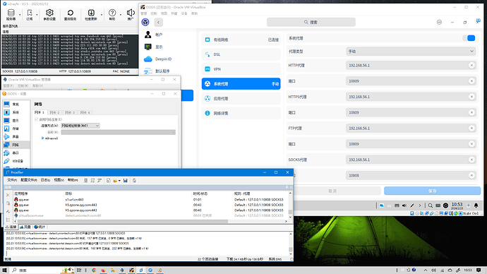

系统自带的系统Proxy设置
d1b72e360b274b8c9e42d79bde497d07
国产操作系统先在都可以淡化自己是从Linux修改而来的发行版的事实,而都在从另一个方面打出来大旗,Micro$aft! Windows的替代品,颇有十八路诸侯讨董卓的风范。
isomen
我只用一个VirtualBox虚拟机,反复重装各种版本的国产操作系统,然后咳血伤亡,总结一下一般常规的操作,最简单的就是,使用系统自带的系统代王里设置功能:
这可以免于在Linux系统下面额外安装什么小飞机软件了,毕竟我们真正生产力系统上面,安装的软件越少越好,越多越复杂就越可能引入不稳定不安全,并且在初始安装的Linux系统上面第一次咳血伤亡,只能使用这种方式,然后你再下载其它的更高级的专业小飞机软件,懂的都懂。

然而,这仅仅是在网页浏览器里面看开源代码可以顺畅了,这种设置系统proxy的方式仍然不能完美解决所有撞墙的问题,有很大的局限性。按照网络上搜到的很多Linux咳血伤亡攻略所说的配置profile文件的方式也是本质一样的,会有docker这样的漏网之鱼。
我安装生产力软件ONLYOFFICE协作空间服务器,在这种只设置了系统黛莉的环境下,安装执行过程中,确实能自动下载安装文件,但是下载后进入自动执行安装过程之前,它会报错退出:
这个截图是自己在国产操作系统深度Deepin发行版Linux下面,是用docker方式安装ONLYOFFICE协作服务器时候最后异常报错时候的样子
这个错误信息单纯的看是看不出来撞墙了的,并且此时的状态,是可以在网页浏览器里面看油罐的,就更加具有迷惑性了。Linux下面用docker方式安装或者执行什么操作,docker容器内的东西向外连接,它真的不一定能走linux系统所设置的系统范围层面的proxy,要把docker流量给咳血伤亡了,就不能是仅仅用摄制系统代王里的方式了。后来我又给虚拟机重新安装为龙蜥Anolis操作系统,同样这样撞墙了,这就说明,并不是深度操作系统的问题也不是龙蜥操作系统的问题,而就是撞墙了。

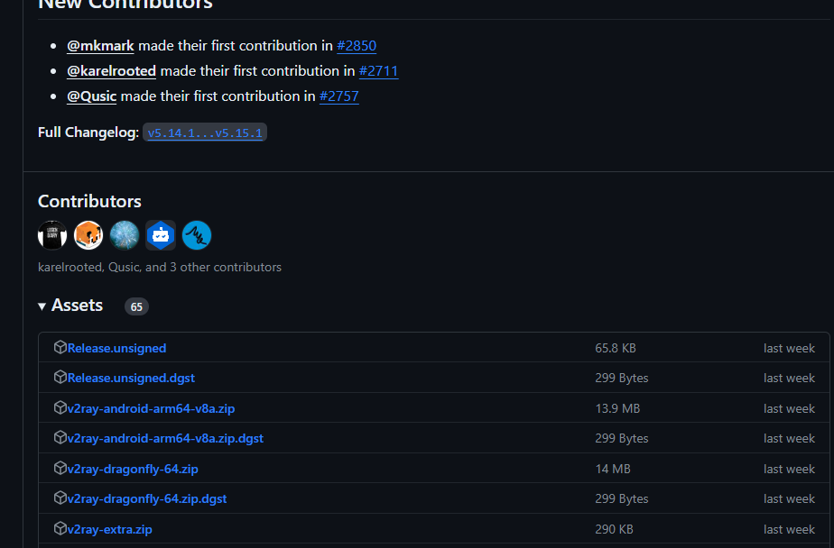

但这只是官方网站,真正要下载的安装文件存放的位置还是在世界最大同性交友网站的服务器上,你需要精心挑选适合你的操作系统的版本的安装文件,我这样普通家用台式机上virtualbox里面创建的虚拟机就选择下载vZray-linux-64.zip这个文件
VZray Core Releases
这很好,上周刚刚更新过,所有的私人飞机,都是越新越好,但凡断更半年以上的基本上都是一起飞就会被防空导弹打下来的,切记。

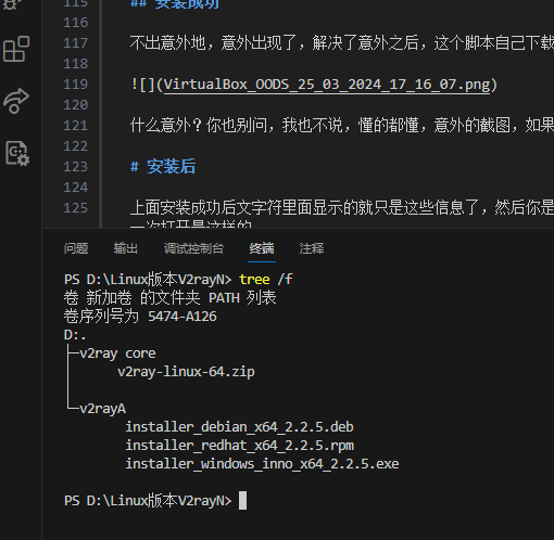

这并没有什么好办法来破局,对于我这样在真实主机里用virtualbox安装虚拟机的来说,在真实主机里先开一架引导飞机去把航空发动机、航电仪表搬运回来,这是一种很有效的方式了:
feijilingjian
上面这是航空发动机,下面是航电仪表,在真实windows主机下用一架私人飞机搬运回来后,拷贝进虚拟机里面的linux系统下面去手动安装这一架新私人飞机,个人拥有多架私人飞机,土豪啊,曹操曰过:生子当如卡拉扬
航空发动机的组装
下载到的安装文件不是安装包格式的,仅仅是zip格式的压缩文件,所以需要自己动手解压缩后拷贝相关文件到相应的路径里面去。

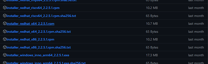

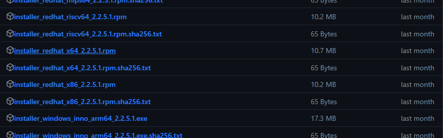

同样也在世界最大同性交友网站上面,用其官方安装手册所说的用各种网络直连下载安装文件的方式,都是属于死循环的,需要先用私人先导飞机下载回来再手动安装的。其下载页面:
vZrayA Release
这就很好了,不但很新,上个月刚更新过,而且提供编译好的各个发行版的安装包,不用自己编译了,直接下载安装包,然后拷贝到虚拟机里面去,非常方便,现在的Linux发行版本,对于自身的package格式的安装文件,在命令行里面直接sudo dpkg -i就可以安装了,在图形界面里面选择安装文件右键菜单里面就可以选择安装了也非常方便。

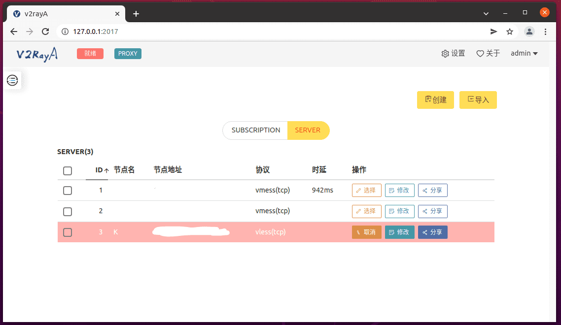

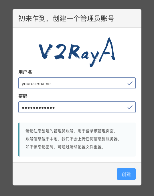

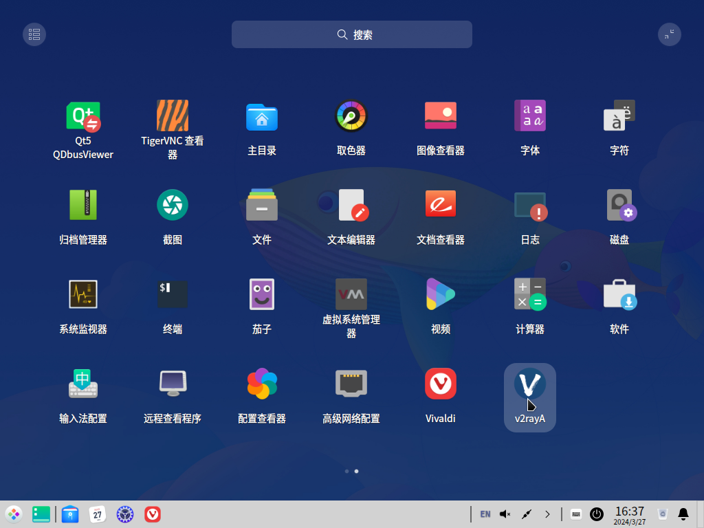

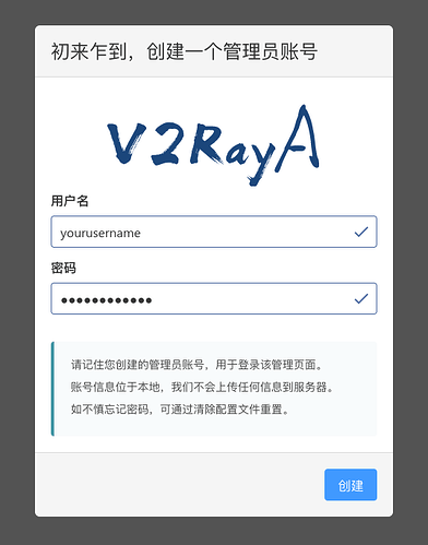

很简单,直接从linux系统的程序菜单里面找到新安装的vZrayA,点击运行即可,非常方便,这会自动打开linux系统自带默认浏览器打开本机的vZrayA的管理后台页面http://localhost:2017,远程登陆的情况下直接在命令行下敲入命令vZraya即可,在终端电脑里面用浏览器打开linux计算机的ip地址http://linux的ip地址:2017
初次安装第一次打开该页面会显示上面这个创建管理员账号的提示,然后就可以去添加飞机航额航线了,以及其它各种琐碎配置,比如是否开机自动启动,有的人为了方便而在Linux系统上采用服务的形式运行vZrayA,但是我不建议这样,在自己的电脑里面不让它自动起飞,而只是自己需要的时候手动档起飞,这样,如果把自己的电脑暂时临时性的给其他人检查使用的话,只要我不说,他就是正常的炖在墙内的状态,他就不会发现我擅自咳血伤亡这件事,比较安全一些,就像我之前给自己电脑写程序自动截屏监控一样,我自己用就会关掉它,而借给别人用自己的电脑,他的所作所为,事后我都能看到的一清二楚。

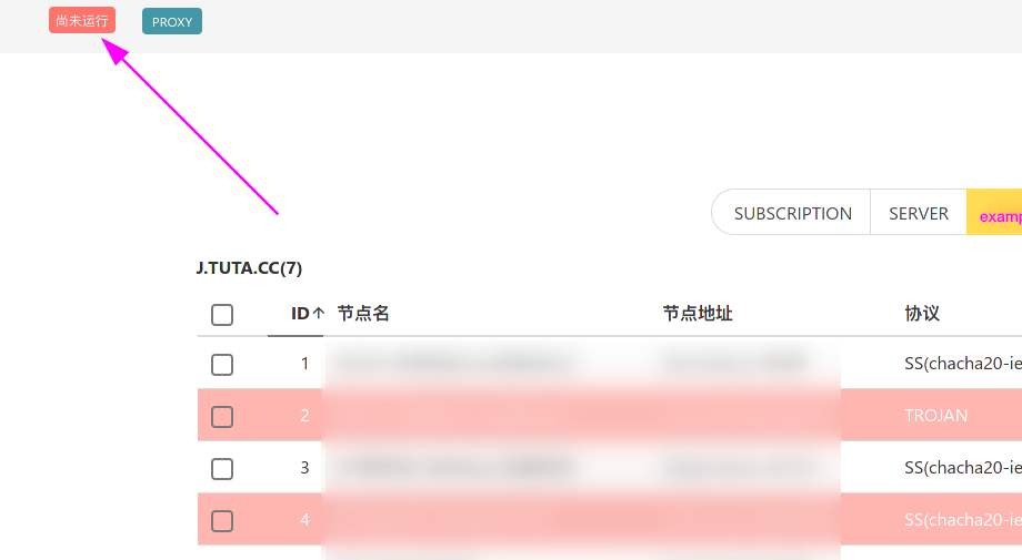

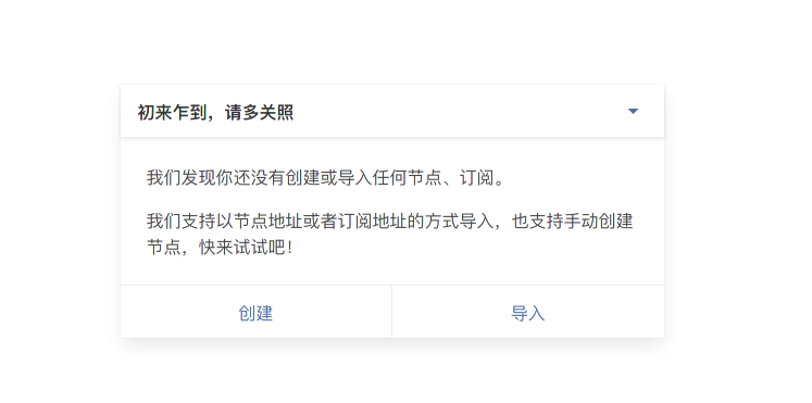

这只是你自己的私人飞机飞起来了,要想跨大洋飞行,你得上网寻找私人飞机场提供跨洋飞行的航线航额。全新私人机初次起飞会提醒导入节点:
选择导入,然后把私人机场主提供的二维码或者航额id字符串拷贝进来,就可以导入了,然后连接节点,

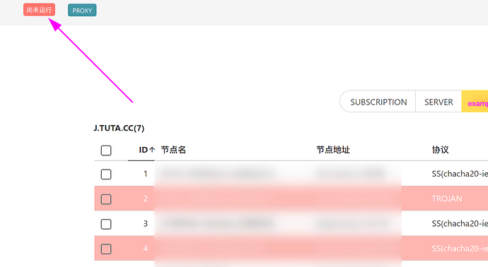

选择一个也可以同时选择多个连接,6个以内为佳,选中的航额会显示为淡红色,页面左上角红色按钮显示当前状态为“尚未运行
在未启动服务时,连接的节点呈现柚红色。我们在左上角点击相应按钮启动服务。

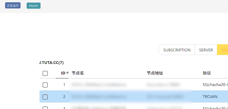

在启动服务后,所连接的节点呈现蓝色,左上角的图标也显示为蓝色的正在运行,代表服务启动成功。最关键的来了
小兔不再乱撞

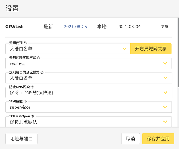

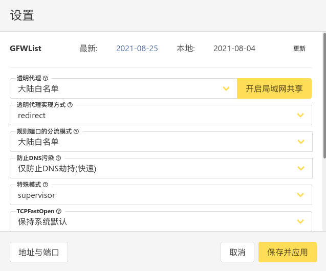

如下所示配置为透明黛莉:
这种方法是vZrayA推荐的方法。它相比于其他方法具有诸多优势,vZrayA可以一键开启透明代理,为几乎所有程序提供代理服务,这样就可以让Docker、ONLYOFFICE这样在安装时候逃逸简单木弟子的软件重新登基起飞了。

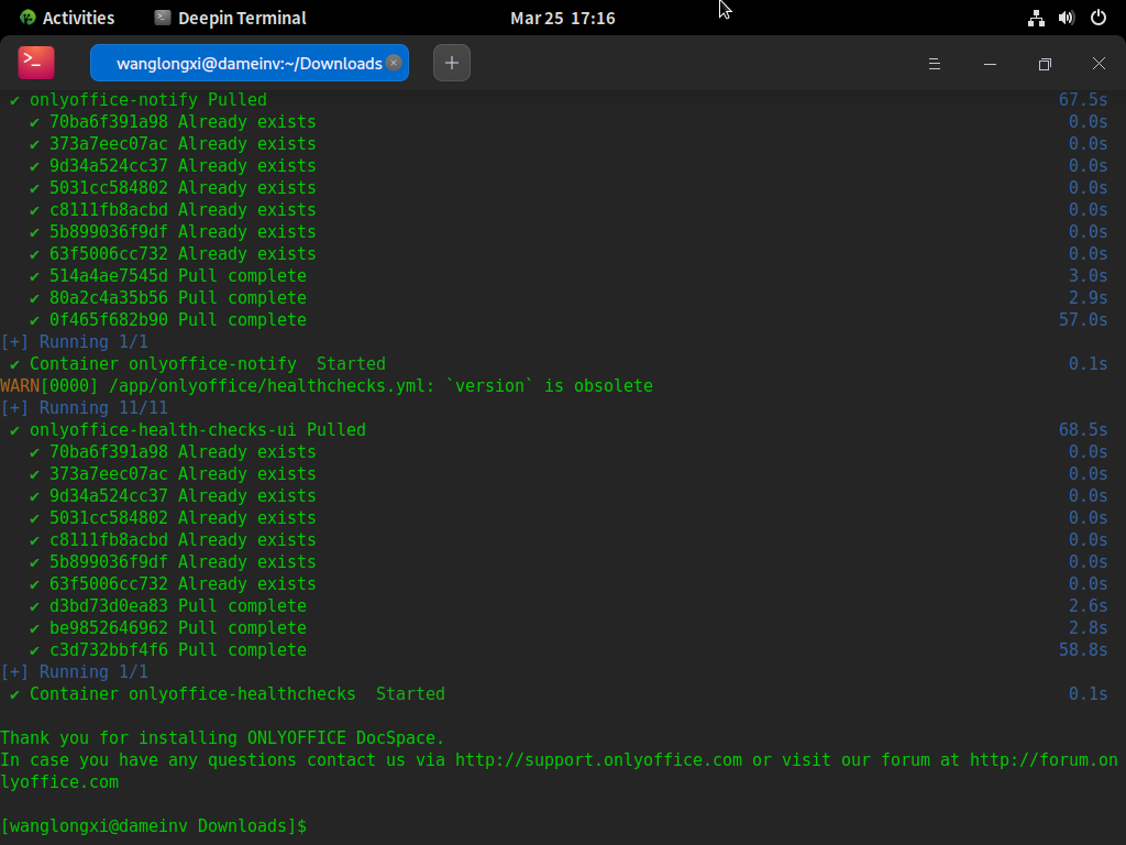

这飞机飞起来那就是“一桥飞架南北, 天堑变通途”了,然后再次安装ONLYOFFICE协作空间服务器,就可以得到最终安装成功的结果了:
