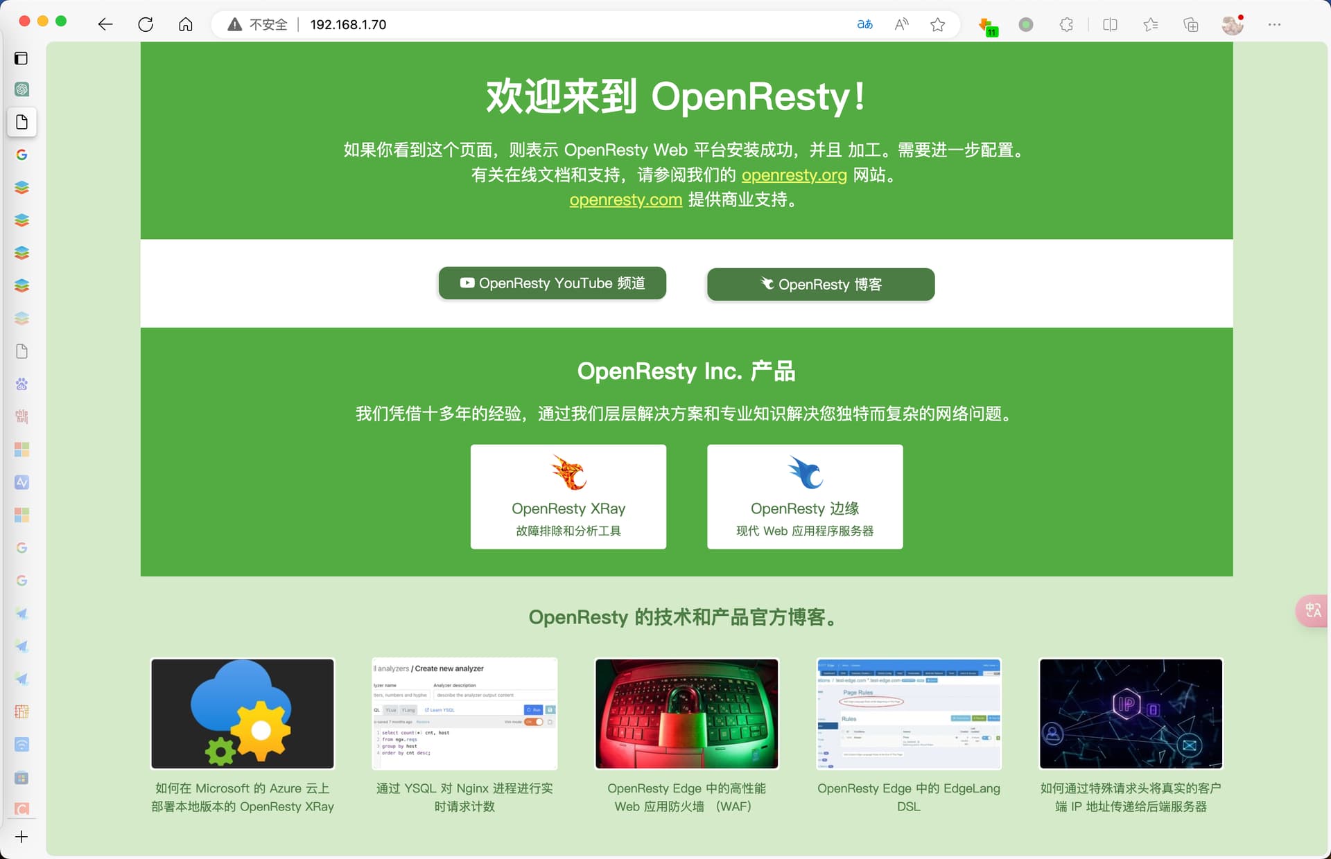

However, when I enter the IP address, it displays as

By configuring the system proxy, scientific internet access can be achieved, and installation can be completed normally through the script
Hi @touma
it seems like you need to use a proxy or VPN for installation DocSpace from China.
how did you get over GFW? My ladder could let me open G00GLE in browser and download files via curl, but can not let my docker pull and build OODSS. I have tested with my ladder turned off, the script will stop and exit at once started, it will not come to Unable to retrieve tag from onlyoffice/documentserver repository error, how to make everything in Deepin Linux get out of GFW?
I successfully completed the installation by configuring the proxy
