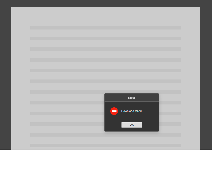

I found that one of the sockets was not correct. The result is that now onlyoffice is opening, but the documents are not, due to error Download failed.
What could be the problem for this? I can’t find anything in the logs for nginx, tuleap nor onlyoffice. Any hints what I should check and fix?
@xumepoc Apologies for the delay.
The Document editing service cannot upload the file for editing.
Check if the link to the file specified in the document.url is correct. The link must be accessible from the document editing service.
How to check if? I am using a ready plugin for tuleap. Could it be rights, certificate or something similar?
May I ask you send whole Document Server logs folder for check.
It’s located /var/log/onlyoffice/documentserver/
The issues is now solved. First I had to run bash documentserver-update-securelink.sh (Download failed... 403 forbidden) , but as this didn’t fixed the issue I noticed that for some reason the “set $secure_link_secret …” was commented out for https. After that was modified and openresty/nginx was restarted the service was available and is working just fine
