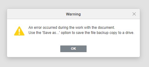

A document that I had last worked on version 7.3 now “dies” when the ToC is updated. I’ve had to delete the ToC to continue working on via OO.
Inserting a new ToC results in the same error.
OO Error
Despite the message text “Save as…” does not work.
I found OO’s logs, but the only readable text is “leveldb.BytewiseComparator” in a MANIFEST file which from my perspective is not helpful, at least to me.
Opening the same document with MS Word does not indicate any issue, in either creating or updating the ToC.
Are there any switches to turn on more reporting so that I can attempt to diagnose what is happening with OO and and the ToC?

Hello @DavidRGreen
As far as I understand, you’re describing the issue with table of contents. Would you mind providing test file and detailed description of scenario, so we can reproduce it. We would like to take a closer look at it.
