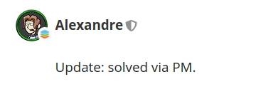

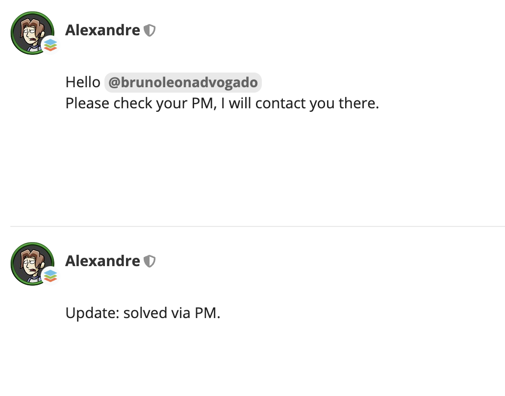

I agree, it’s not pleasant to see “Solved via PM” at the end of a thread.
Here’s the outcome:
We will make an effort to specify in such posts the exact method used to resolve the issue and the root cause.
Regarding the solution in the thread you referenced:
The mail server added CS to ban list.
It was decided to communicate via PM because the logs contained the portal address.
