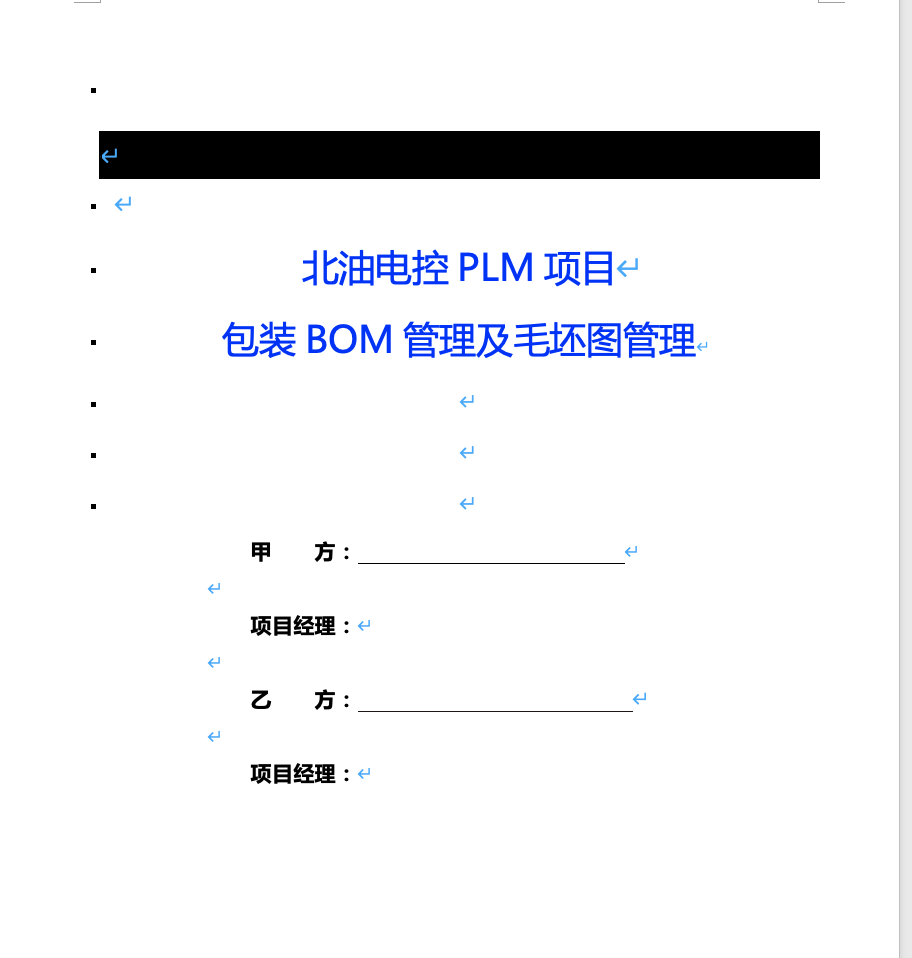

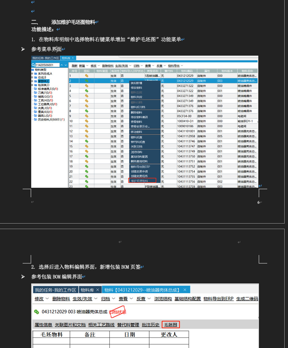

The source file screenshot looks like this.
The source file has a total of 7 pages, but OnlyOffice displays 8 pages. Additionally, when converted to PDF, it also shows 8 pages.
How should I resolve this issue?

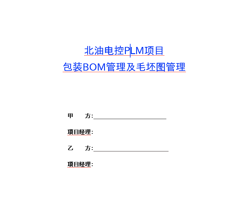

I believe the issue appears because several fonts are missing on Document Server side.
You can manually add your fonts to Document Server according to this guide and then compare the way document is displayed again:
thank you very much.I added the font library, but there are still some differences compared to the source file。
the picture display in next page

I open the file with office 365. Is OnlyOffice fully compatible with Windows Office?
Thank you very much
May I know which fonts did you add?
This is the download link.
As I can see, two fonts that are used in original document are not in the mentioned repository.
Please double check the fonts that you’ve installed and the ones that are used in documents and compare them.
