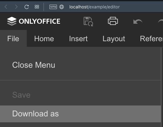

Extra question.
When I go to localhost:80 should I be able to create new documents? Because right now all I can do is to generate test example which kinda works but “Save” button is inactive for some reason (volumes are mounted properly):
save
Thanks for any hints.
Do you mean integrated example? This is expected behavior for integrated example. The ForceSave mechanism is disabled by default there. This is related link: ONLYOFFICE Api Documentation - Saving File
