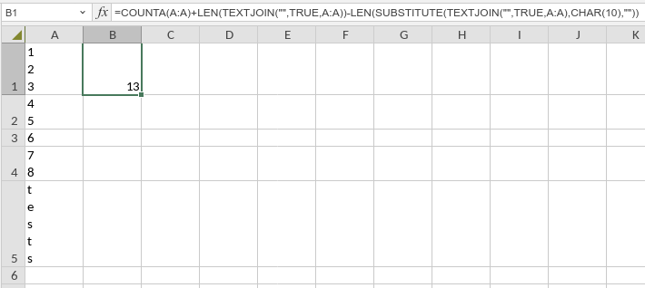

@IanY
Also, you can try the following formula: =COUNTA(A:A)+LEN(TEXTJOIN("",TRUE,A:A))-LEN(SUBSTITUTE(TEXTJOIN("",TRUE,A:A),CHAR(10),""))
I’ve attached the file.
count_rows.xlsx (8.0 KB)
@Nikolas,
Thank you! That works!
