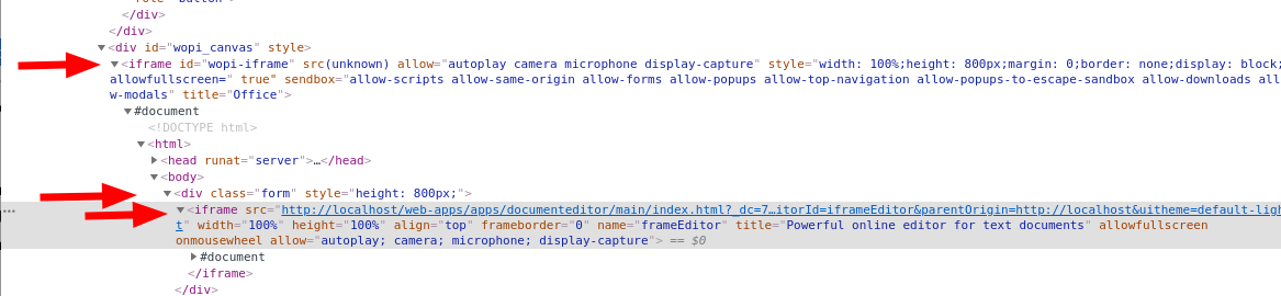

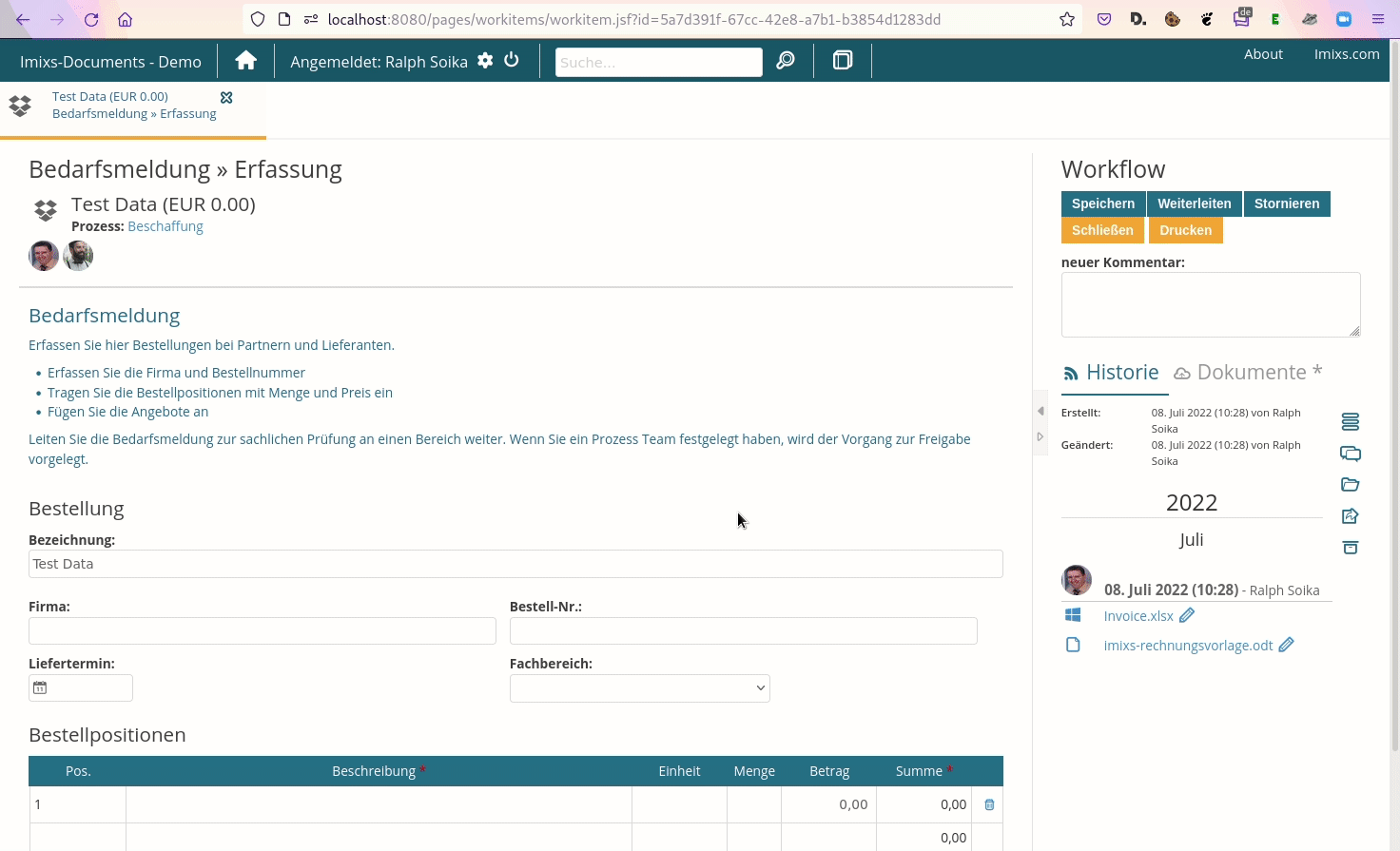

Hi @Alexandre ,
I think our WOPI host is working just fine. We can open the OnlyOffice Editor in a iframe and the GET requests for FileInfo and FileContents are send correctly from OnlyOffice to our host. As a result the document is shown correctly:
Peek 2022-07-08 10-29
But what did not happen is the WOPI POST Call back to our wopi Host. I would expect that on each save inside OnlyOffice a POST request is send back to our WOPI Host so that our application can store the data (instead of this OnlyOffice caches the data which is also very simmilar to Collabora).
The problem I see, is the call back POST from OnlyOffice to our App. In the nginx log files of OnlyOffice Document Server I can see this message: (see the full log file above)
onlyoffice-app | 2022/07/05 10:33:21 [error] 967#967: *14 connect() failed (111: Connection refused) while connecting to upstream, client: 192.168.128.1, server: , request: "POST /hosting/wopi/word/edit?&%3Crs=DC_LLCC&%3E%3Cdchat=DISABLE_CHAT&%3E%3Ce=EMBEDDED&%3E%3Cfs=FULLSCREEN&%3E%3Chid=HOST_SESSION_ID&%3E%3Crec=RECORDING&%3E%3Csc=SESSION_CONTEXT&%3E%3Cthm=THEME_ID&%3E%3Cui=UI_LLCC&%3E%3Cwopisrc=WOPI_SOURCE&%3E&WOPISrc=imixs-documents:8080/api/wopi/35ae501d-ac67-4a1a-99ac-930587800671/files/imixs-rechnungsvorlage.odt HTTP/1.1", upstream: "127.0.0.1:8000/hosting/wopi/word/edit?&%3Crs=DC_LLCC&%3E%3Cdchat=DISABLE_CHAT&%3E%3Ce=EMBEDDED&%3E%3Cfs=FULLSCREEN&%3E%3Chid=HOST_SESSION_ID&%3E%3Crec=RECORDING&%3E%3Csc=SESSION_CONTEXT&%3E%3Cthm=THEME_ID&%3E%3Cui=UI_LLCC&%3E%3Cwopisrc=WOPI_SOURCE&%3E&WOPISrc=imixs-documents:8080/api/wopi/35ae501d-ac67-4a1a-99ac-930587800671/files/imixs-rechnungsvorlage.odt", host: "localhost", referrer: "localhost:8080/"
What I expect is a POST request against our application which is in this szeanrio:
POST https://imixs-documents:8080/api/wopi/..../imixs-rechnungsvorlage.odt
But - if I understand the log messages correct - onlyoffice sends a post request to localhost:8080 (which is the referrer host)

@Alexandre I try to figure out how set the correct parameter and I wonder if I can use the WOPI PostMessage for this?
After I receifed the App_LoadingStatus during loading the document, I tried to send the request like this:
iframe.postMessage(JSON.stringify({"c": "forcesave","key": "Khirz6zTPdfd7","userdata": "sample userdata"}), '*');
But this did no work.

I analysed the situation in more detail. And maybe we are talking about different things.
Remember, I am in the WOPI Situation, which means my web application generates an iframe element to load the OnlyOffice editor based on the WOPI Discovery URL result. This works fine.
My iframe contains a document with again an iframe containing the OnlyOffice app.
Don’t you think, that my postMessage is going to the WOPI API and not to the command service?
This is the script I am using out from my web app to post the message:
function setOnlyOfficeForcesave() {
	console.log('setOnlyOfficeForcesave.....');
	var iframe = document.getElementById('wopi-iframe');
	iframe = iframe.contentWindow || (iframe.contentDocument.document || iframe.contentDocument);
	if (iframe) {
		console.log('post message to localhost...');
		//var result=iframe.postMessage(JSON.stringify({"c": "forcesave","key": "Khirz6zTPdfd7","userdata": "true"}), "*");
		var result=iframe.postMessage(JSON.stringify({"c": "forcesave","key": "Khirz6zTPdfd7","userdata": "imixs-workflow"}), "http://localhost:80/coauthoring/CommandService.ashx");
		console.log('post message completed! result='+result);
	} else {
		console.log('iframe not found!');
No errors, but I did not get a result (undefined) and I can’t see anything in the debug log.
Do you expect that in case of a WOPI integration it should be possible to post normal OnlyOffice Command Service in parallel to the WOP PostMessage commands? Even if they have different formats?
What I mean is that I fear my JavaScript function has the wrong implementation for that what we want to achieve - setting the forceSave flag?
