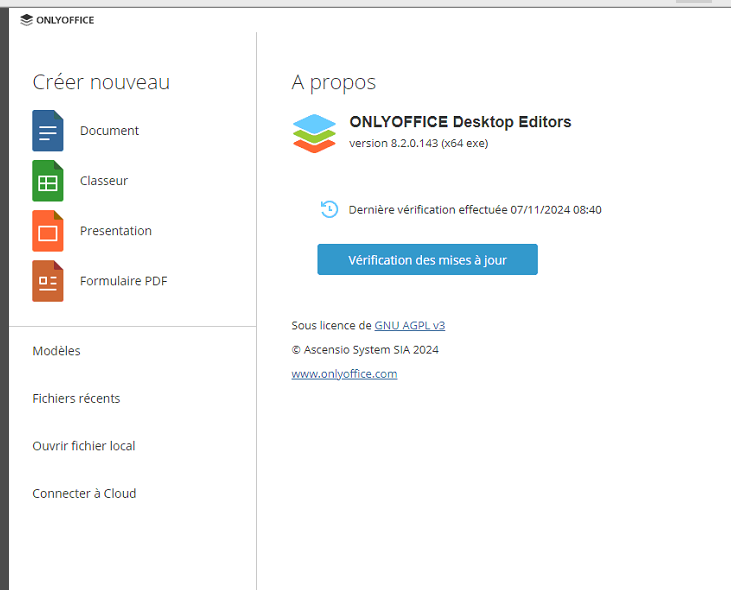

The version of ONLYOFFICE Docs:
  • ONLYOFFICE Desktop Editors: version 8.2.0.143 (x64 exe)
    Sub-license under GNU AGPL v3
    Ascencion System SIA 2024

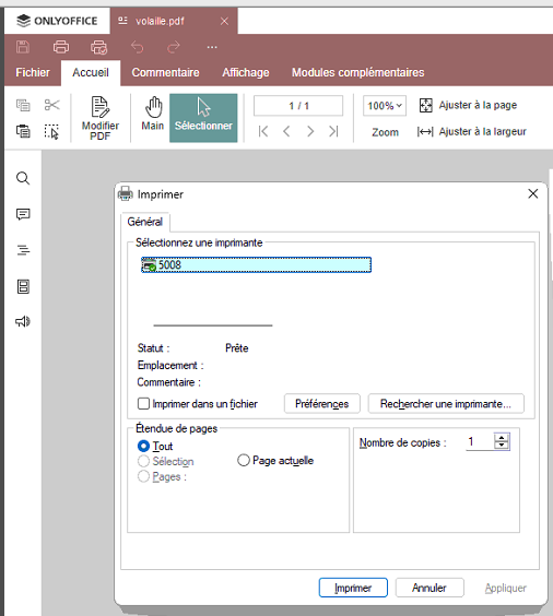

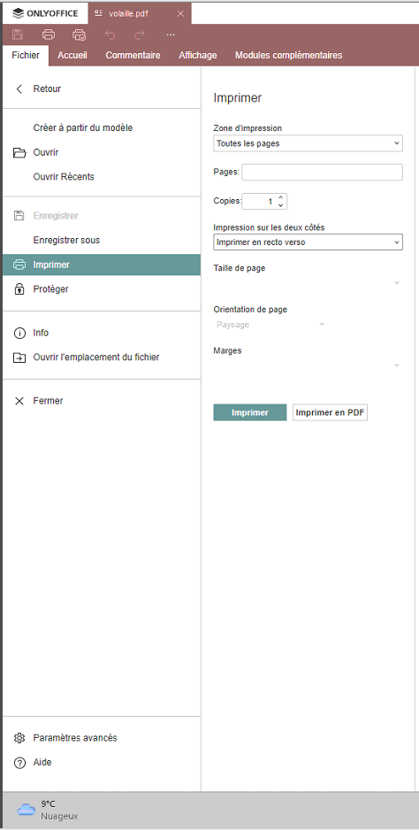

A manual action is required by the printer to start printing, and this only occurs when using ONLYOFFICE.
You will find attached the screenshots of the printing options for documents on ONLYOFFICE.

We have released new version of Desktop Editors recently. Kindly asking you to update your app and check the situation again.

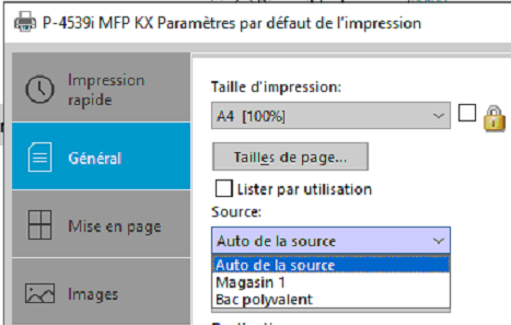

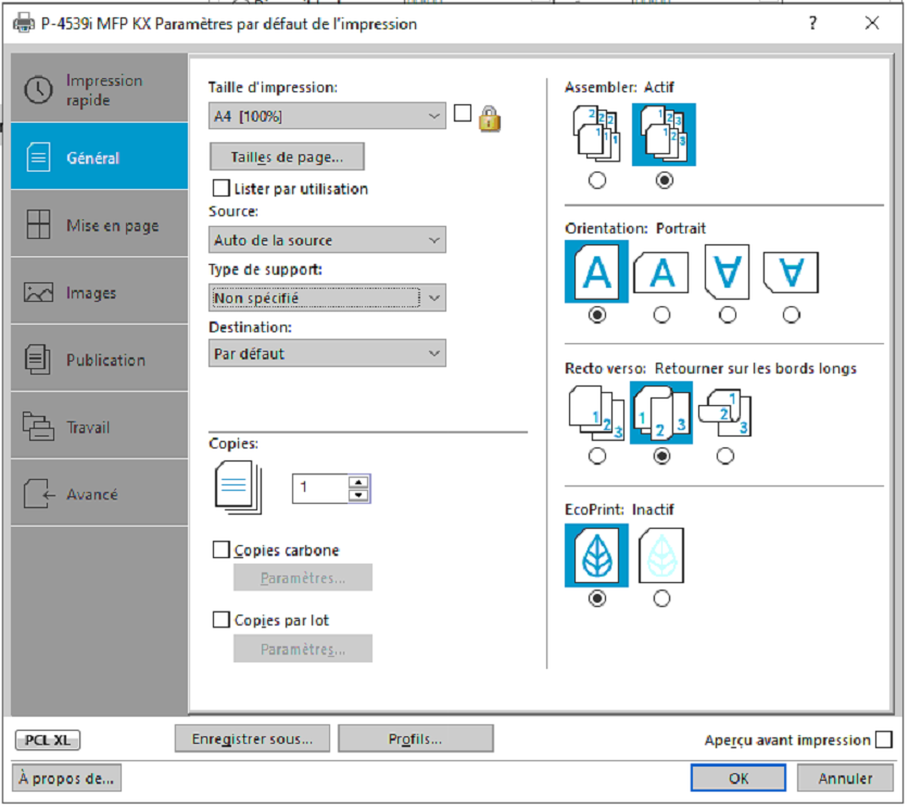

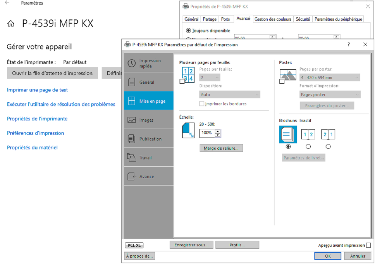

Can you please also share some additional system settings of the printer? Interested to see Printing defaults and Advanced settings, which you can find by:
  • Open Start > Settings > Printers & Scanners.
  • Click your printer, then click Manage.
  • Click Printer properties.
  • Go to the Advanced tab (make screenshot).
  • Click Printing Defaults (make screenshots of Layout and Paper/Quality tabs).
Looking forward to your reply.
You will find the screenshots below, thank you.
Can you send these images as an archive please? Attached are barely readable.
P-4539i MFP :
Capture d'écran 2024-12-27 113956
