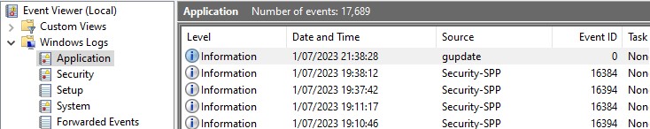

Hi.
It doesn’t matter if I open an existing document or create a new one, the result is the same.
There is an error in the event log when starting the application, but the description is not informative:
Of course, I tried to reinstall the application in various ways, the result is the same.
If you need to throw off the info from somewhere else, tell me, I’ll throw it off.
Has no one had such problems?
Hopefully that will help diagnose the issue. Trying to find some meaning from those error codes may be a starting point. That should help the technical support people, and they may even recognise the issue from the codes.
But, that’s a little out of my scope I’m afraid. :smiley:
I tried. There are many errors with similar codes, and they appear in different cases and with different applications. I haven’t found a specific solution yet.
