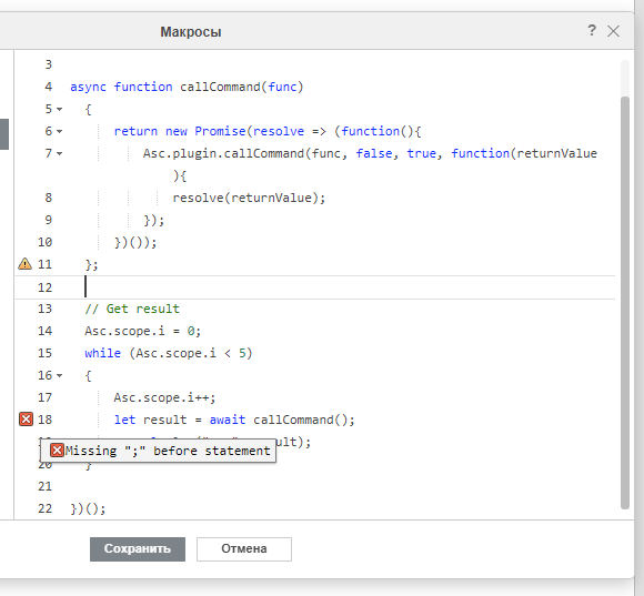

callCommand is a synchronous method already. To get result like the one you are describing you need to call it asynchronously instead. For instance, in a way like that:
  async function callCommand(func)
      return new Promise(resolve => (function(){
          Asc.plugin.callCommand(func, false, true, function(returnValue){
              resolve(returnValue);
  // Get result
Asc.scope.i = 0;
while (Asc.scope.i < 5)
    Asc.scope.i++;
    let result = await callCommand(...);
This is just a demo, you should fit your code accordingly.
When calling a function callCommand (after await), I can specify my function with the necessary actions (which will be executed inside the editor and will have access to the document data), right?
I don’t know JS well (I’m trying to translate my VBA macro to onlyoffice) and to check the syntax - I just pasted your code into the macro editor in onlyoffice. It gave me this:
For the first one (line number 11) - remove “;” right ?
But how do I resolve the second warning (line number 18) ?
