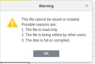

I am facing a problem after updated my Opensuse Tumbleweed with KDE Plasma 6.0. Whenever I try to open an Excel or Doc file in OnlyOffice it opens as read only. I tried to Save as that file with new name & location but nothing works. Even I tried to create new file but not able to save that too. I am getting the message that " This file can not be saved / created due to following possible reasons -
- The file is read only.
- The file is being edited by other users.
- The disk is full or corrupt."
![image](https://forum.onlyoffice.com/uploads/default/original/2X/a/a0698fccdfcb463afa88d531619594a014e1c566.png)
Kindly suggest any solution for this problem.

I have uninstalled and reinstalled Onlyoffice Desktop editor through Discover app in Opensuse Tumbleweed. But the result is same.

Got the solution. I removed it from Discover app and reinstalled through Snap. Now it is working properly.
