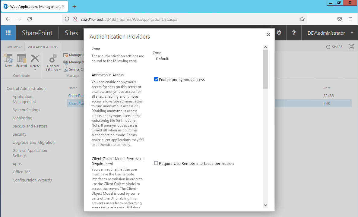

Hello Ank.
The error looks like a problem with Default zone. Please double check it. ‘Enable anonymous access’ should be ON. The rest of the settings on this page (Authentication Provider) do not need to be touched.
Also, you can make screenshots of your Authentication Provider and Anonymous Access Restrictions pages and share them with us.
Hello Alexandre.
Authentication Providers Settings:

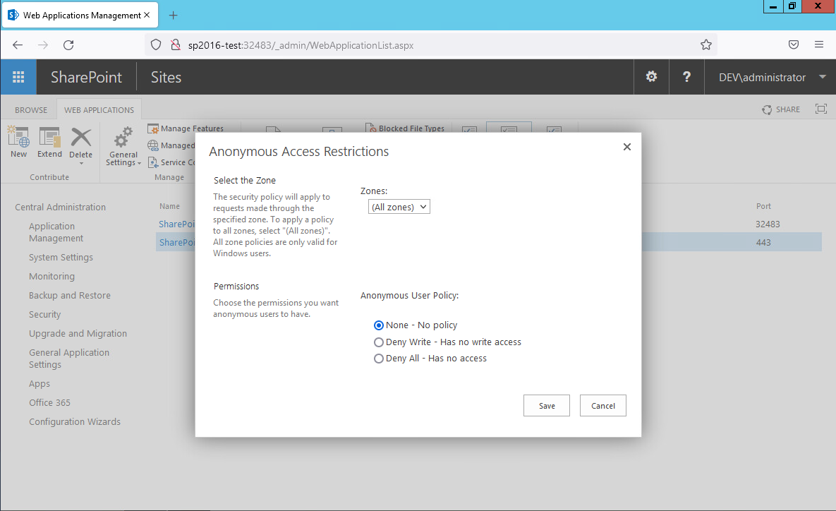

Anonymous Policy Settings:

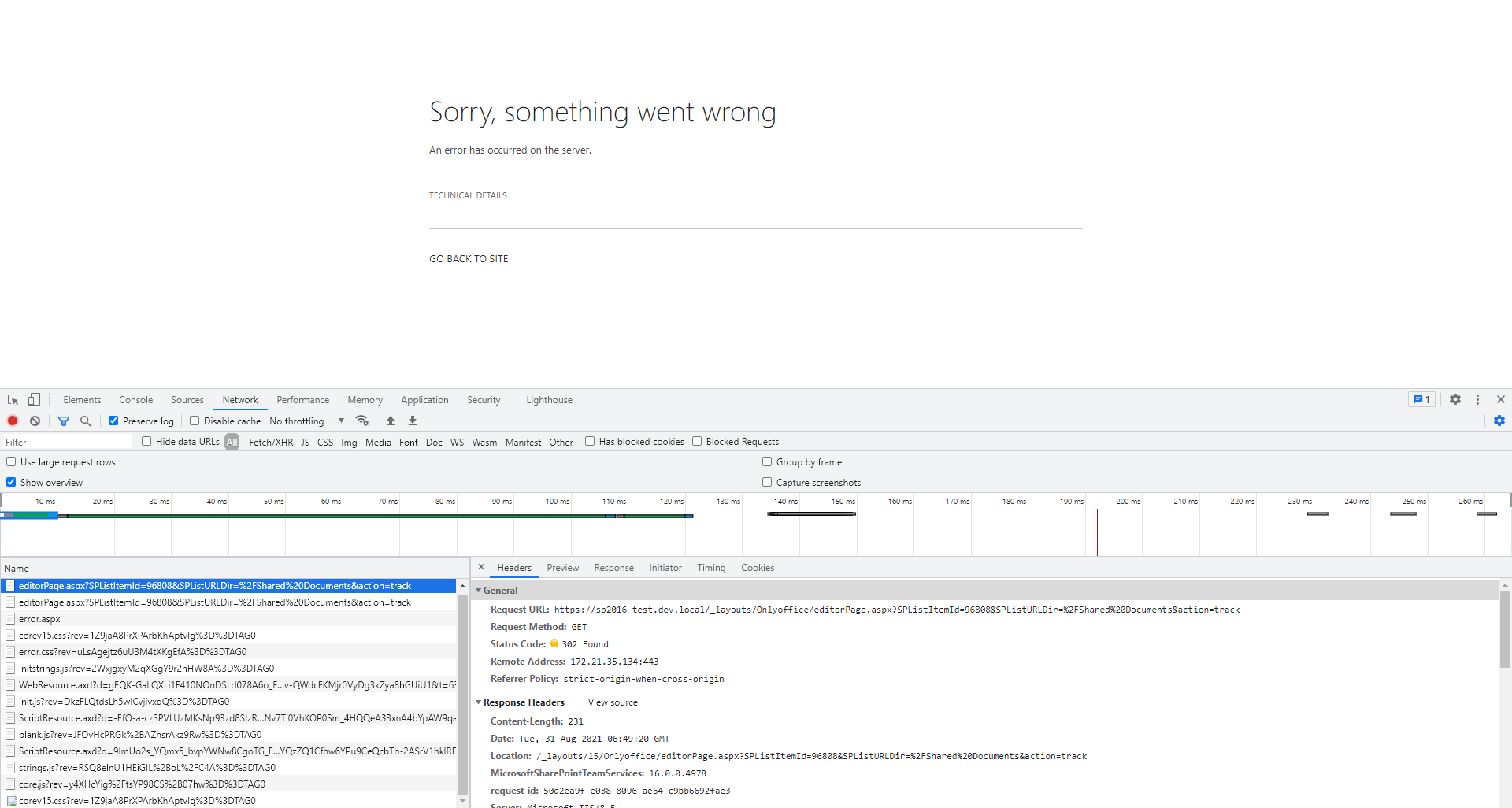

But if I click on the Button “Open in Onlyoffice”, I get:

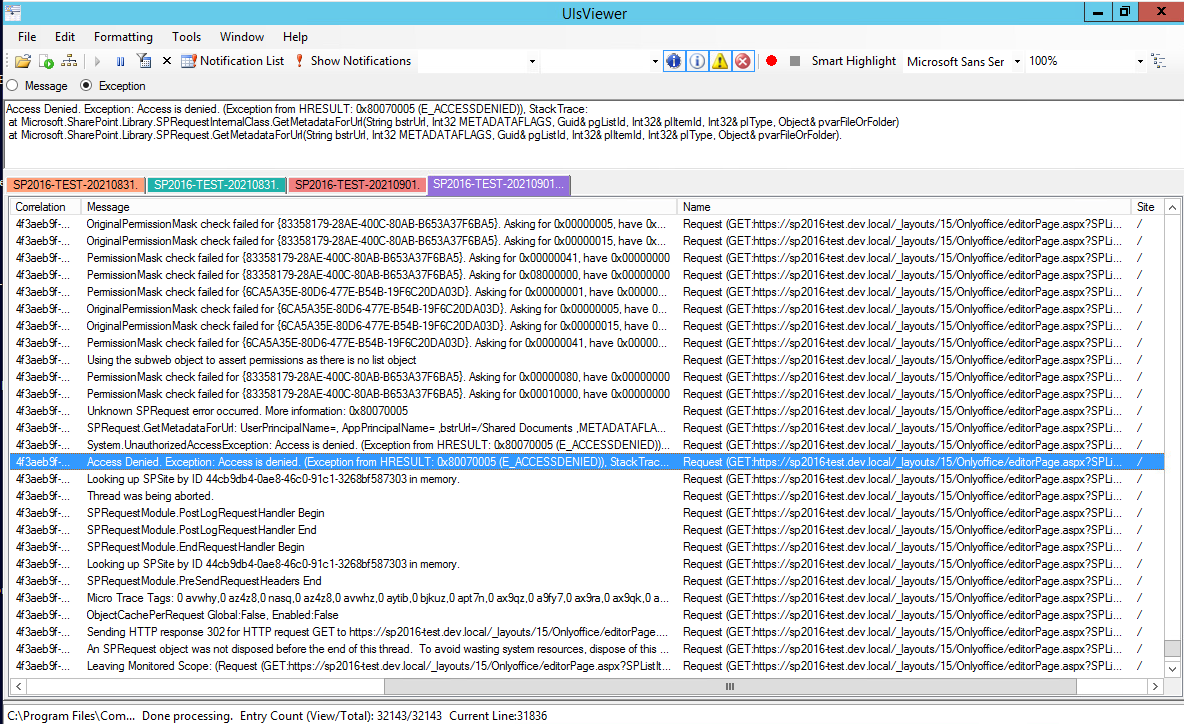

and in the logs you can see:
As you can see, it gets an 0x80070005 error when attempting to redirect the page.

Go to Anonymous Access Restrictions and choose Default zone in drop-down menu. Anonymous User policy is left as it is (None - No policy).

Even if I select default zone and save this configuration. If I then open Anonymous Access Restrictions again, “All zones” is selected again.

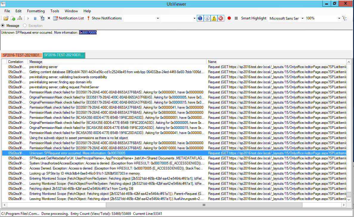

Here are the logs observed by UlsViewer:
