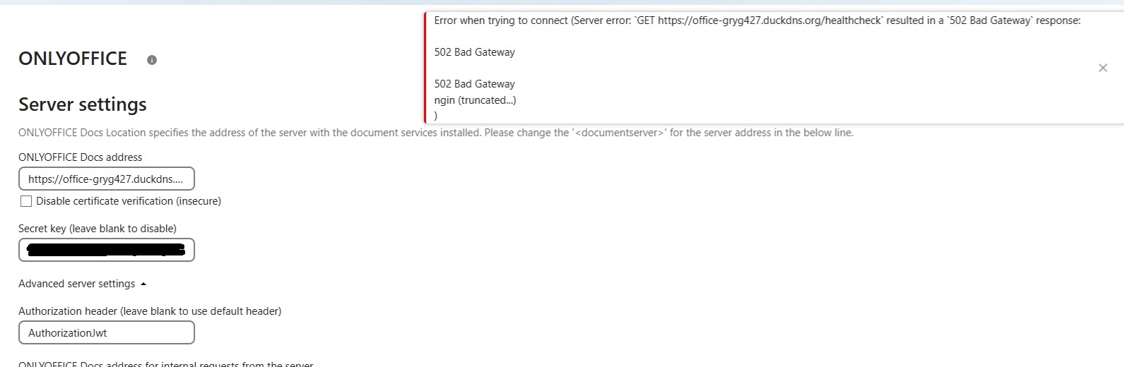

Unfortunately, I still got this message.
I think, there is some problem with NGINX. Isn´t it? What to send to you to suggest the right solution?

I was able to reach your OO-service, based on the server address from your screenshot.
Did you tried out the integrated test example to see if OO is working correctly?
Check the logs from OO first to see what is going on. Could be an issue with other services blocking ports.

Thanks a lot. I put the snippet into nginx.conf and I see an alert “Error when trying to connect (cURL error 6: Could not resolve host: office-gryg427 … (see libcurl - Error Codes) for https://office-gryg427.duckdns.org/healthcheck)” on OO configuration page in Nxtc, and domain is not reachable from outside.
healthcheck depicts 502 Bad Gateway …
So obviously something is wrong :-/. Any other idea? Thanks again

What have you put in for the internal addresses in the connector server settings?
Your screenshot doesn’t show that part.
The upstream directive is obviously wrong, since you have set up the virtual hosts according to the instructions in the wiki. It was just a guess of mine, since you asked for help with your nginx config. But the hosts are configured and your nextcloud and OO service is reachable from outside (tested it myself)

in the “ONLYOFFICE Docs address for internal requests from the server” is put HTTP://“internal_address”:81 (“internal …” is in correct form x.x.x.x)
in the “Server address for internal requests from ONLYOFFICE Docs” is the domain name you already successfully tested
I hope they are both ok :frowning:
The situation is pretty same in case I leave both fields empty or fill in with HTTPS://“domain …”

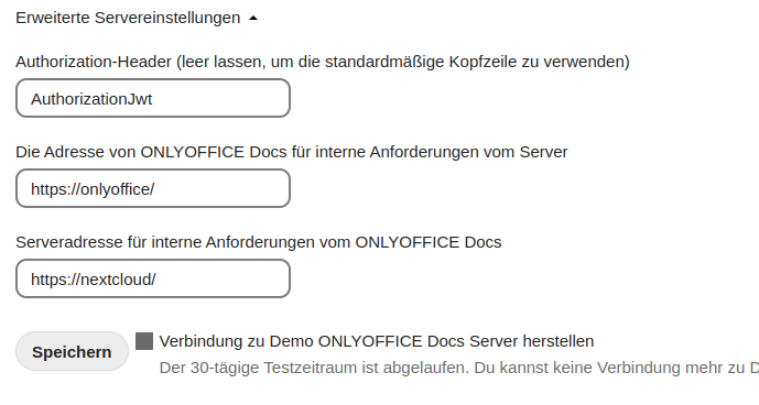

Since my setup is virtual in a docker environment, my settings looks like this:
NC
This defines how both are resolved internally. This is just to understand where OO and nextcloud are supposed to be.
Don’t mind my secure connection. I simply configured it this way initially.

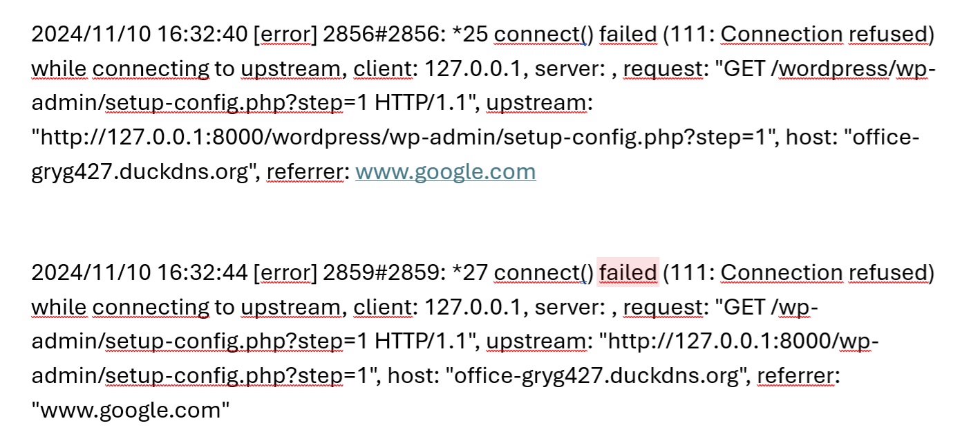

this is the log I got. Is there any clue which can help us?
may be, but I always don’t give affairs up without fight :slight_smile:
When this is your log from onlyoffice, then there is some mixup with “wordpress”.
I guess “127.0.0.1” really redirects to your own PC :slight_smile:
Put in your internal OO/NC server ip back under server settings in the connector-app and try again. But put also the internal ip for your nextcloud connection, not the external. Then restart you nginx and after press “save” in the connector-app again. Then provide the log.

This is the log nginx.error.log output now.
2024/11/13 11:00:23 [error] 2593#2593: *69 connect() failed (111: Connection refused) while connecting to upstream, client: x.x.x.x, server: , request: “GET /healthcheck HTTP/1.1”, upstream: “http://127.0.0.1:8000/healthcheck”, host: “x.x.x.x:81”
x.x.x.x is my right internal IP I hid (don´t know exatly why but I feel safer now :-)))))))
Do you need anything more for investigation? Thx
Well, the log says the connection is being redirected to “http://127.0.0.1:8000/healthcheck”, which in your case should be “http://<your internal IP>:<port>/healthcheck”.
Everything goes by your proxy. In my opinion configuring localhost in the connector makes sense, since everything is on the same host, but for the sake of not making a mistake, you should be also able to put your hostname in here too or his IP (generally speaking, in my opinion, 127.0.0.1:8000 is not wrong here)
