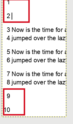

And ODT document with “do not add a line spacing” does not survive a save and reopen. Two things that happen.
  1. empty line get the extra line added back
    Screenshot_2024-07-23_15-48-19
  2. lines with writing get clipped and the remainder gets added to the next line
This is what LibreOffice 24.8 loads the saved file as:
Screenshot_2024-07-23_15-56-27
You will note that the extra empty lines were not shown in LibreOffice, but that the wrap around lines still got clipped and added to the next line.

Very cool. Thank you. Also, this is an odt problem . It does not occur with docx files.
This is an issue with conversion to ODT, bug on this behavior was registered earlier. We will inform you once this issue is resolved.
