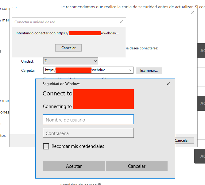

Anytime I try to connect to Workspace through Webdav I get a login loop. I enter the correct details and it asks me for login over and over. Tried on Windows Server/Windows 10/macOS over the Internet and also locally, same result.
Community Server/Control Panel version: 12.7.0.1936 / 3.5.3.538
Type of installation of Workspace (docker, deb/rpm, exe, please point us to the installation guide that you used as well): Docker
OS: Ubuntu 24.04
Any relevant details about the situation. If you’ve modified configuration files or are using a proxy server that might affect the situation, please mention it. You can also attach images and videofile to the post (or to place them to external storage):
I’m using an Apache2 reverse proxy but whenever I try locally without going through the proxy I get the same result. Stuck on login prompt:
