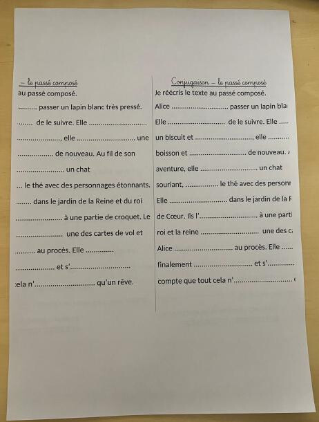

Using linux mint for a week, I face a bug which I don’t face with LO.
Page format is not taken into account when printing.
Here is a test document (but it is the case with any doc in landscape) :
MHF - P3-S3 - Atelier 3 CM1.docx (30.7 KB)
Open it and try to print page 6.
The landscape orientation is not taken into account:

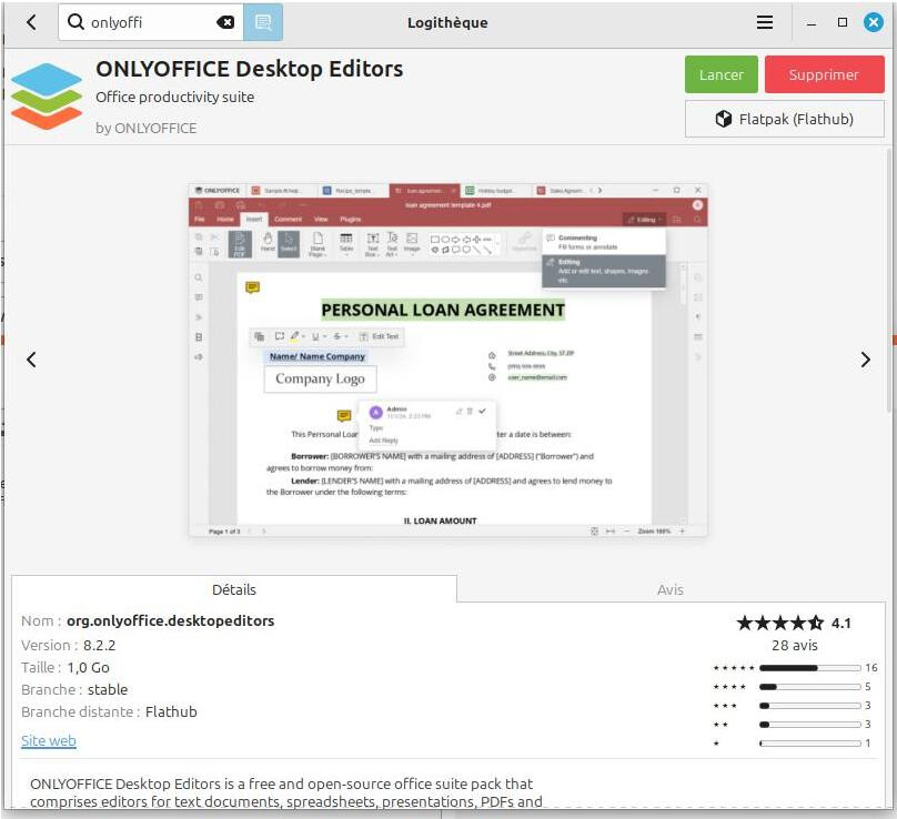

I was not able to find info on the installation type of Desktop Editor on your new OS. Could you please elaborate on this? Is it package installation or, for instance, snap?
Hello
New OS : linux mint 22.1 (last version)
Package : flatpack (from the software center of the distro.

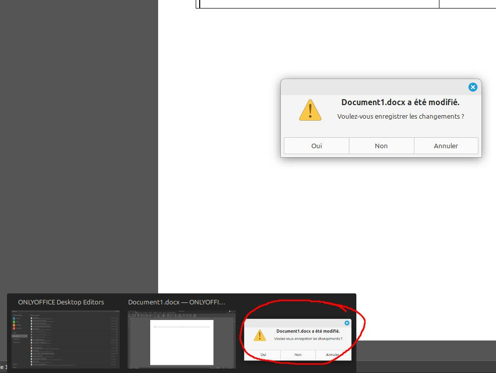

Otherwise, a small remark regarding the .deb setup.
Am I wrong to say that with this kind of setup, dialog boxes are not managed the same and are considered as a new window, not as “the same”:
(I’m not 100% sure of what I say here)
Window manager works differently with package installed apps, so this is expected.

Thanks for the info. May I also ask you to try printing it into a PDF file? Will it also have portrait layout in resulting PDF?
Just tried.
PDF : OK, landscape layout for a landscape file.
Printer : KO, portray instead of landscape.
