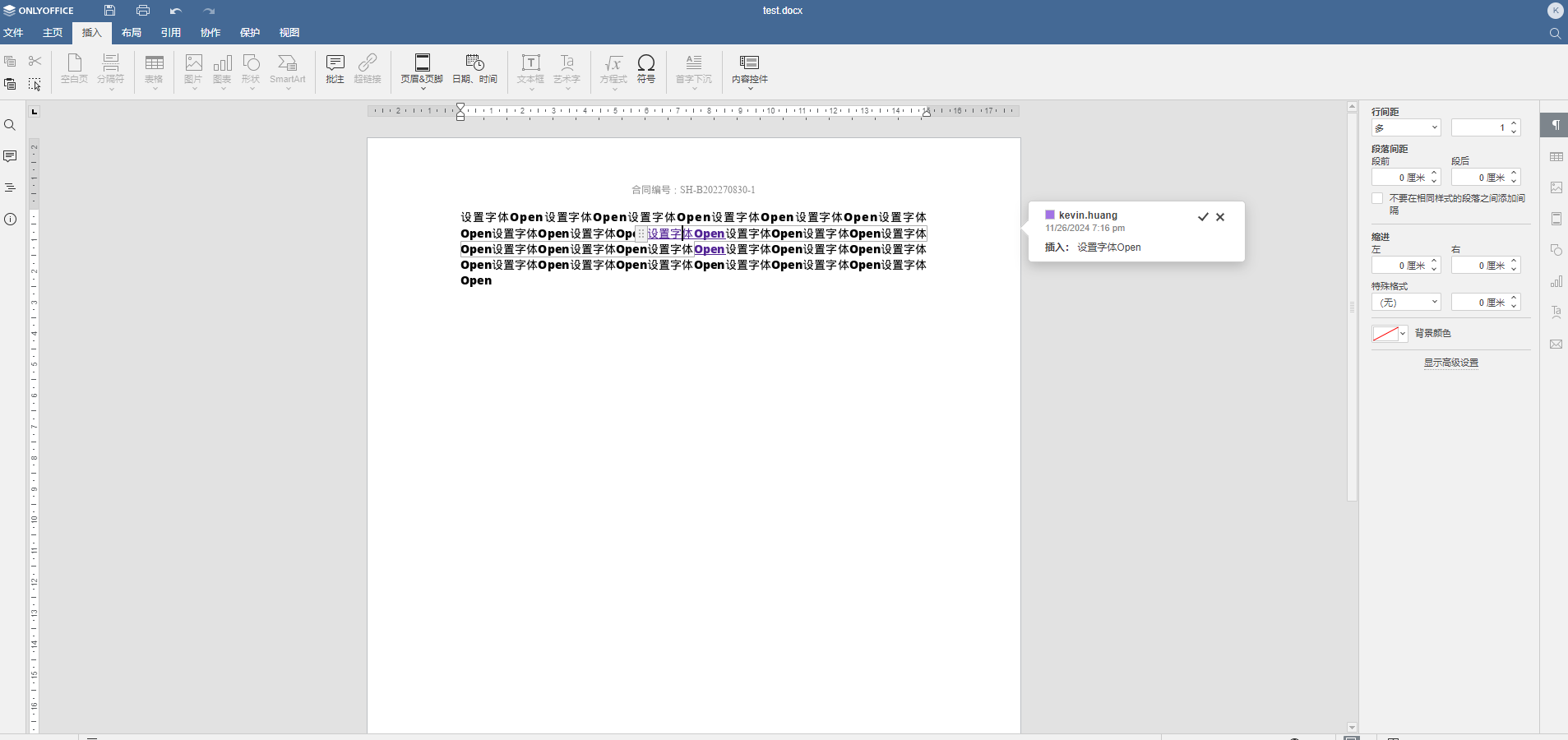

Hi, @DmitriiV ,thanks for your reply.
This is the image where I reproduced the issue.
steps:
  1. Enable revision mode.
  2. Select a piece of text.
  3. Insert a plain text content control.
    At this point, two revision records will be generated as shown in the picture.My version is 7.3.3.
this is the original document
test.docx (28.0 KB)

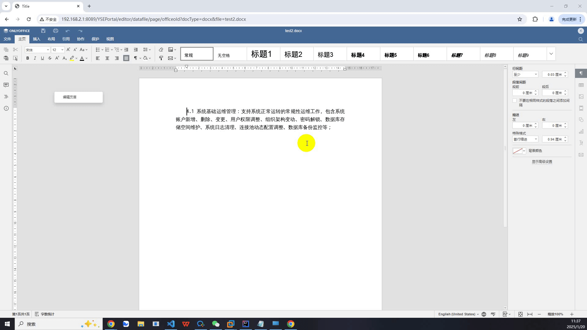

hi@DmitriiV ,
I also found that the revision records seemed to have flaws in many scenarios. When I set the line spacing and indentation for a paragraph, information about the font settings was displayed additionally, even though I did not actually modify the font.Here are the screen recording of the step-by-step issue and the original document.
1sezy-jwis8
test2.docx (10.7 KB)
Hello, thank you for sharing, we are currently analysing. Please create new forum topics for new issues
