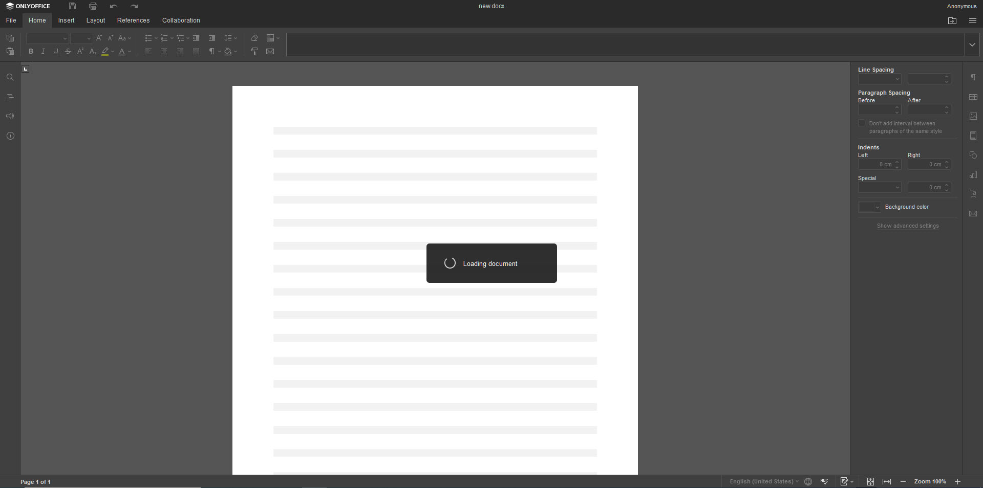

Issue loading documents within DocumentServer
Good Evening
I have installed DocumentServer on Windows Server 2012 R2, but i get stuck “Loading Document” and no errors on Console or Network, how can i resolve this
Thanks

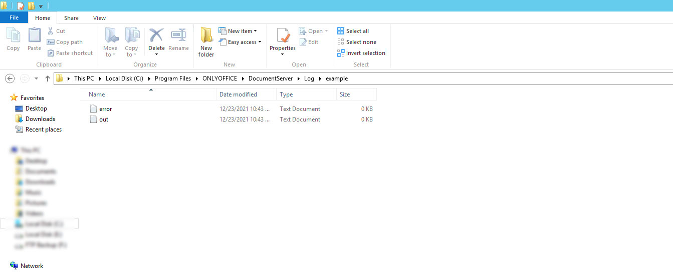

Could you please reproduce the issue and provide us with whole Document server logs folder. It’s located here: Program Files (x86)\Ascensio System SIA\DocumentServer\Log

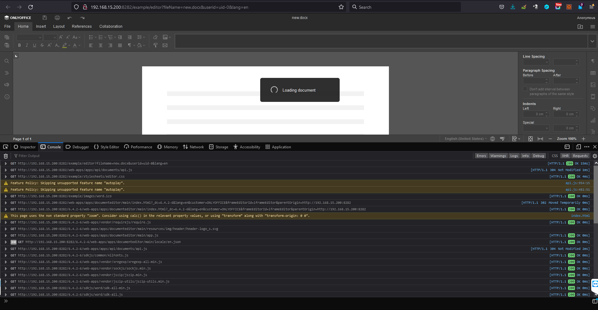

There is nothing within the log , always 0 byte, attached browser console , installed same steps as OnlineOffice shows in the following link :-

Please check the folder one level up (not example folder). You should see folders: converter, docservice, nginx.
Also, please check the path which I mentioned before: Program Files (x86)\Ascensio System SIA\DocumentServer\Log
