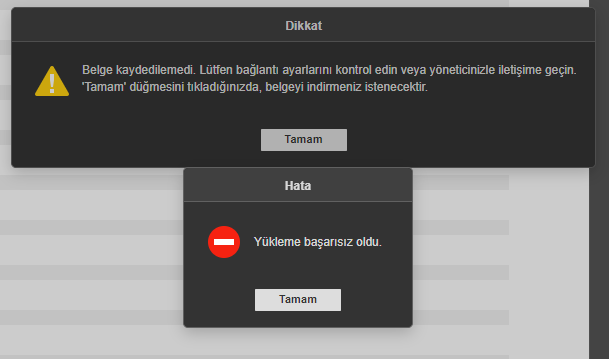

Hello, after doing this, I get the following error. Can you help me on the issue?
The document could not be saved. Please check the connection settings or contact your administrator. When you click the OK button, you will be prompted to download the document.

This is surely related to the token. Did you change all three values * token.enable.browser, token.enable.request.inbox and token.enable.request.outbox to false and then restart Document Server services? Command to restart services is systemctl restart ds-*.

This is different issue, please create separate post with detailed information about the issue to avoid mixing up topics. Make sure to provide at least following information in new post:
  • version of Document Server;
  • type of installation of Document Server;
  • logs of Document Server after reproducing the issue.
Logs are located in /var/log/onlyoffice/documentserver for DEB/RPM packages installation and the same path for Docker but inside container with Document Server.

@fkeles, please create new separate post from this one so that it’d be easier to focus on one user at a time. Thank you.
