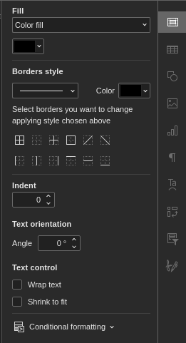

I want to set the cell size to 40x40px. In Excel, it can be done through the Format option in the Home tab. How can I do that in the OnlyOffice Spreadsheet?
The Format Cell option on the right-side pane doesn’t have the option change Row Height or Column Width like Excel has.

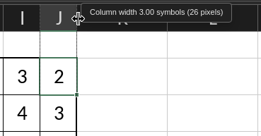

I keep entering values for 20 pixels, but it keeps setting it pt or sym and the pixel measurement keeps changing. Why even measure it other units when it can show in pixels when dragging? Or, why not let the users enter in pixels when it’s going to show the measurement in pixels like this anyway??
I entered “20 px” for height and “3 sym” width, but it keeps setting it to 26 pixels like this.

1 sym is roughly 7,5 pixels.
Because pixels are used to reference the width in your exact set up that depends on the density of pixels of your monitor. This is a standard practice. For instance, Excel does the same thing:
