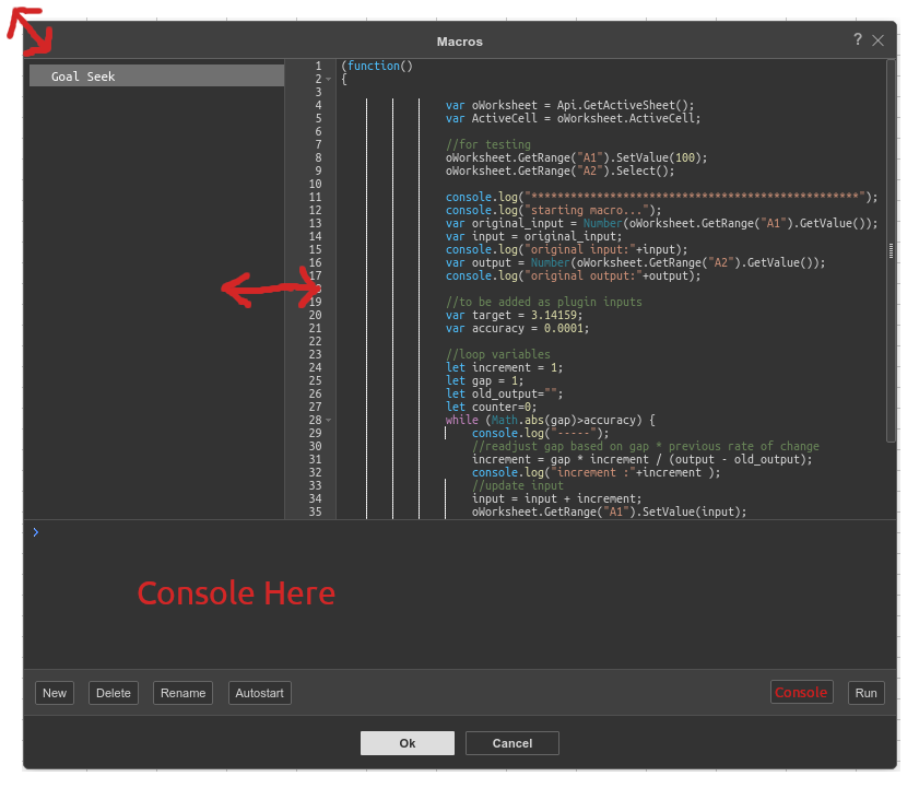

ok so, I had a look at v7.3 and couldn’t spot any difference.
Regarding the first page on Debugging, this has more to do with app debugging which isn’t what I was trying to do so that’s my mistake and we can ignore.
On the second page regarding macro debugging, again, no change as far as I can tell. DevTools is a very useful tool but for some reason it is burried quite deep and hidden behind this right click → Show DevTools. Pressing F12 still does nothing for me and quite frankly, even if it did, there should be a button so the user knows it’s there. A debug console is a critical tool when writting macros, I really think that this DevTools window should be made more visible.
Ideally, it should be integrated directly in the Macros window. It doesn’t need to be massive, perhaps a split screen at the bottom of the code like in VS Code would do. In any case, please add a button to show DevTools (e.g. next to “Run”) of people aren’t going to know it’s there.
Also, the window can’t be resized and 1/4 of the screen size is too small for some decent code, would it be possible to allow resizing so it can be made full screen and allow hiding/resizing the left panel? the left panel is taking too much valuable real estate in this window at the moment.

About Macros tab screen re-size, we have noted your requested and will discuss it internally.
