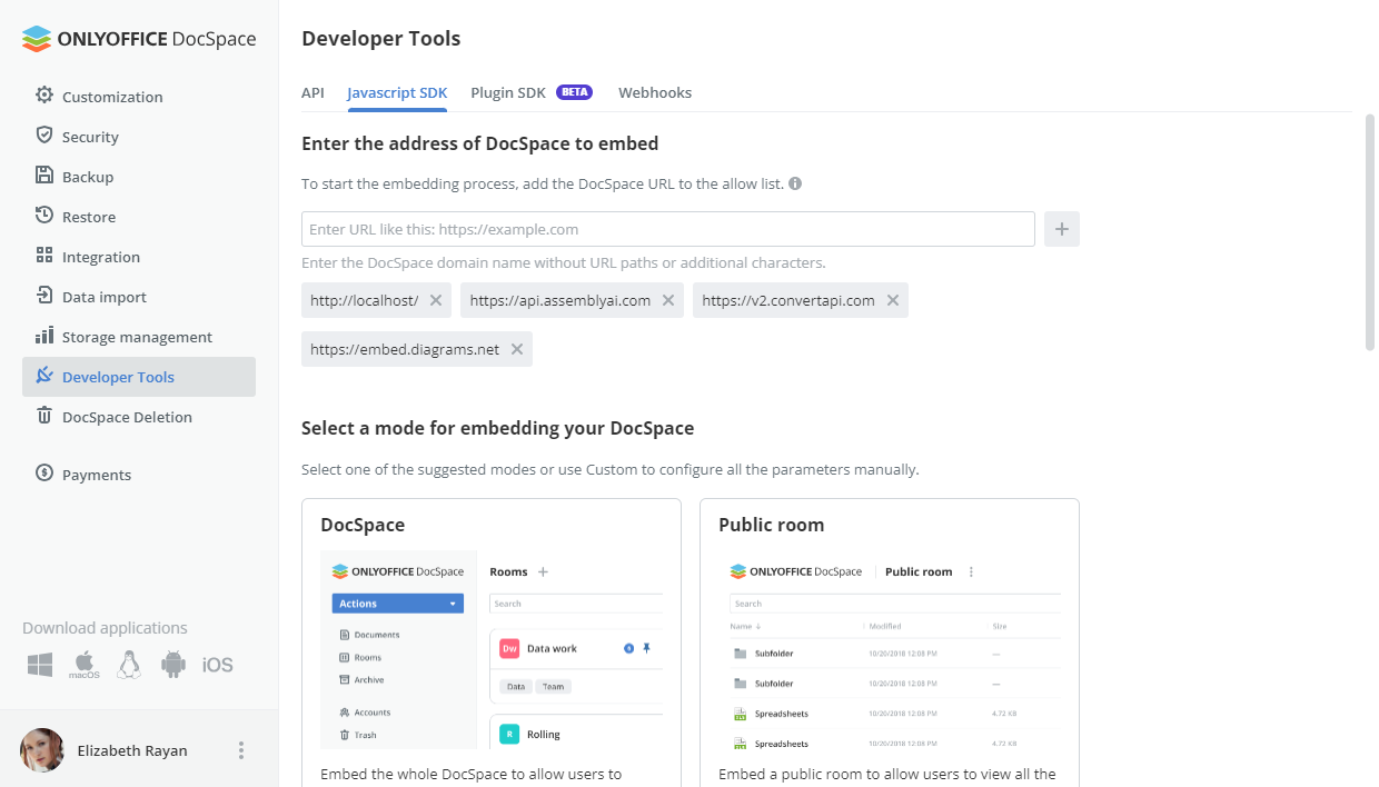

  1. We’ve released ONLYOFFICE DocSpace 2.5.
In this release, we’ve added ready-to-use presets that allow you to seamlessly embed your DocSpace or its parts into any web interface. You can embed the whole DocSpace, Public room, Editor or Viewer, Room or File selector, as well as use Custom mode to configure all the parameters manually.
Where to find: Settings → Developer Tools → JavaScript SDK
