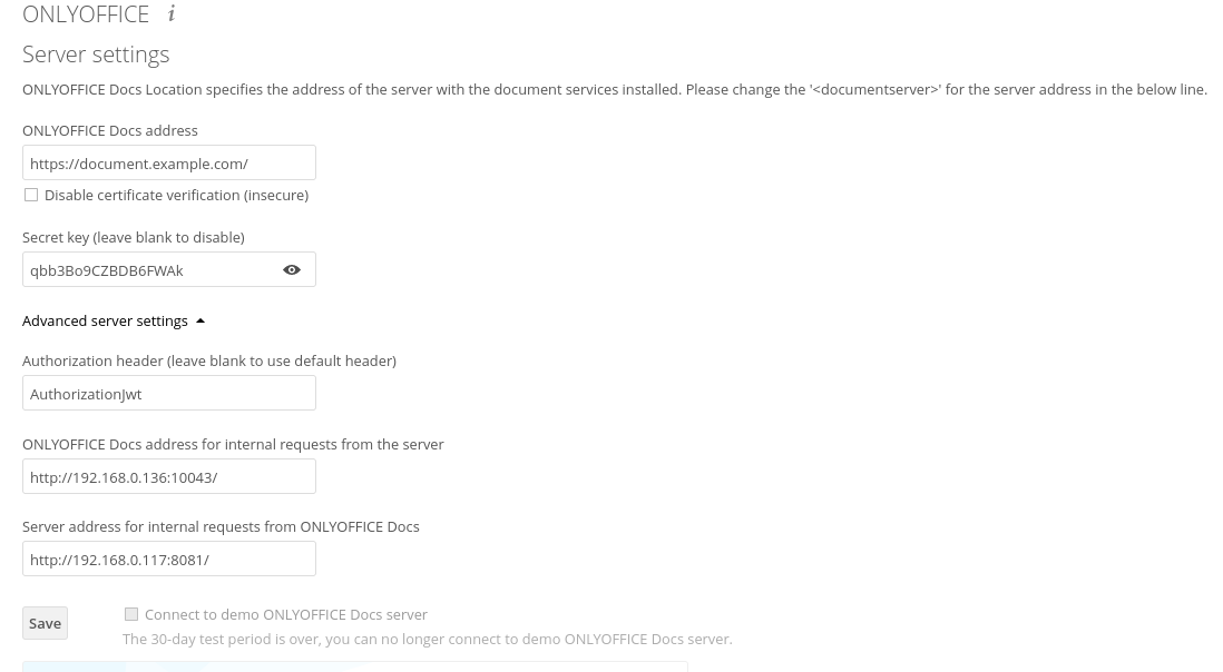

Owncloud Dashboard Settings:
I’ve looked at a lot of other issues posted on here and none seemed to solve the issue. The issue only begun when updating Owncloud Document Server App from v7.8.1 to v8.2.1. Would this be an issue with the Owncloud app? I have uninstalled the Owncloud app using the web interface, should I try wiping the directory as well then reinstalling?

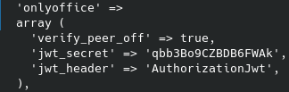

Owncloud config.php:
Owncloud-config.php

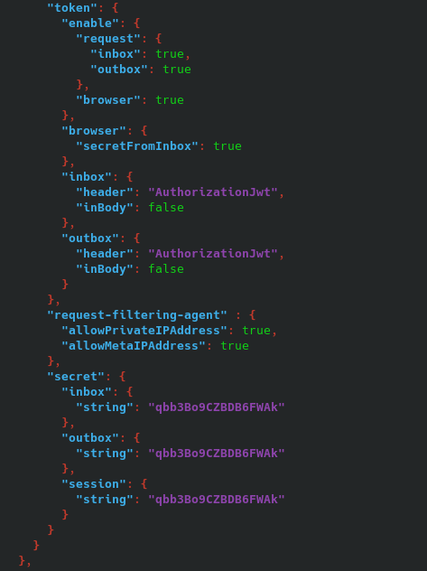

Document Server local.json:

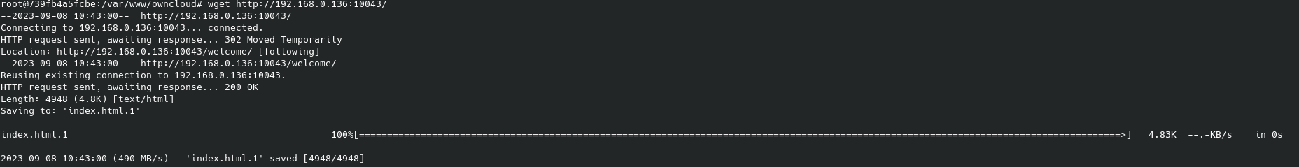

Document Server to Owncloud wget check:
Owncloud to Document Server wget check:

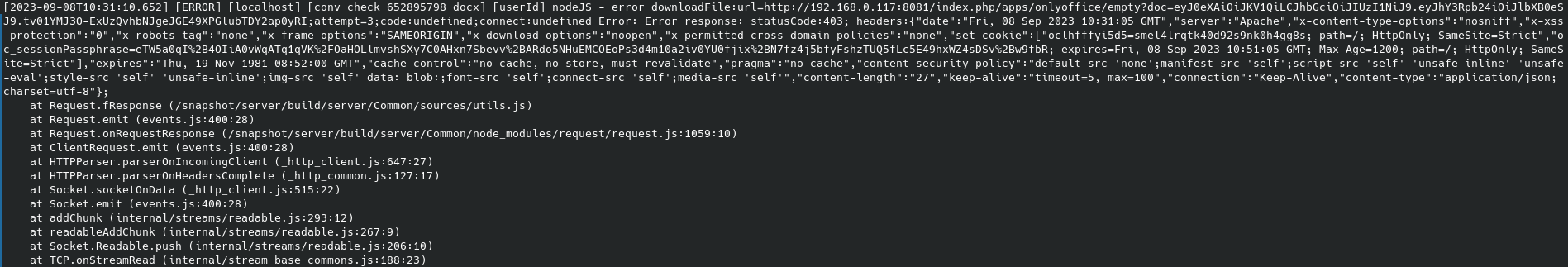

This is the dump of the logs from the document server:
==> /var/log/onlyoffice/documentserver/converter/out.log <==
[2023-09-27T09:15:22.330] [WARN] [localhost] [docId] [userId] nodeJS - update cluster with 1 workers
[2023-09-27T09:15:22.341] [WARN] [localhost] [docId] [userId] nodeJS - worker 7333 started.
[2023-09-27T09:15:22.344] [WARN] [localhost] [docId] [userId] nodeJS - update cluster with 1 workers
[2023-09-27T09:15:38.470] [ERROR] [localhost] [conv_check_470244802_docx] [userId] nodeJS - error downloadFile:url=https://owncloud2.example.com/apps/onlyoffice/empty?doc=eyJ0eXAiOiJKV1QiLCJhbGciOiJIUzI1NiJ9.eyJhY3Rpb24iOiJlbXB0eSJ9.CbpqRTsIEeTKdzM17Ki-XFzfgKWt5_7gfSifKMMWPt8;attempt=1;code:undefined;connect:undefined Error: Error response: statusCode:403; headers:{"cache-control":"no-cache, no-store, must-revalidate","content-length":"27","content-security-policy":"frame-ancestors https//doc2.example.com https//office.example.com https//office.local.example.com https//owncloud2.example.com https//nextcloud2.example.com","content-type":"application/json; charset=utf-8","date":"Wed, 27 Sep 2023 09:15:26 GMT","expires":"Thu, 19 Nov 1981 08:52:00 GMT","pragma":"no-cache","referrer-policy":"strict-origin-when-cross-origin","server":"Apache","set-cookie":["oclhfffyi5d5=cr008m64sng8snmug7uqmdttdd; path=/; secure; HttpOnly; SameSite=Strict","oc_sessionPassphrase=OEjPgCy4c7e%2B8arsH13llEclBNxIjr%2Bo6vqWJoRdYiw6DRxGdEPeOSe5VmqRbh%2B3fq67kkAWQseQVUZlTVnLvIKwTo6qTjsCeGViDbzZ1kzpD3eY%2F6H9OrrXHmZN6LTL; expires=Wed, 27-Sep-2023 09:35:26 GMT; Max-Age=1200; path=/; secure; HttpOnly; SameSite=Strict"],"strict-transport-security":"max-age=31536000; includeSubDomains; preload","vary":"Accept-Encoding","x-content-type-options":"nosniff","x-download-options":"noopen","x-frame-options":"SAMEORIGIN","x-permitted-cross-domain-policies":"none","x-robots-tag":"none","x-xss-protection":"1; mode=block"};
    at Request.fResponse (/snapshot/server/build/server/Common/sources/utils.js)
    at Request.emit (events.js:400:28)
    at Request.onRequestResponse (/snapshot/server/build/server/Common/node_modules/request/request.js:1059:10)
    at ClientRequest.emit (events.js:400:28)
    at HTTPParser.parserOnIncomingClient (_http_client.js:647:27)
    at HTTPParser.parserOnHeadersComplete (_http_common.js:127:17)
    at TLSSocket.socketOnData (_http_client.js:515:22)
    at TLSSocket.emit (events.js:400:28)
    at addChunk (internal/streams/readable.js:293:12)
    at readableAddChunk (internal/streams/readable.js:267:9)
    at TLSSocket.Readable.push (internal/streams/readable.js:206:10)
    at TLSWrap.onStreamRead (internal/stream_base_commons.js:188:23)
I removed part of the message to make it more readable. Please do not post logs in such format, you can archive logs and share them that way.

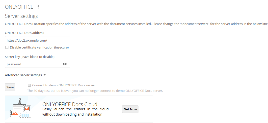

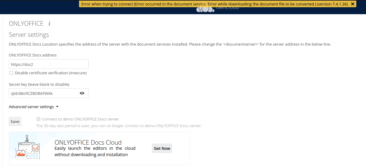

Can you make a screenshot of the connector app page with the settings?
