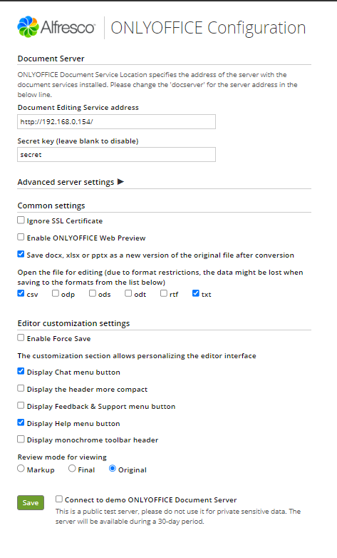

and the connector settings:
  1. Yes, hitting 192.168.0.154 returns http://192.168.0.154/welcome/

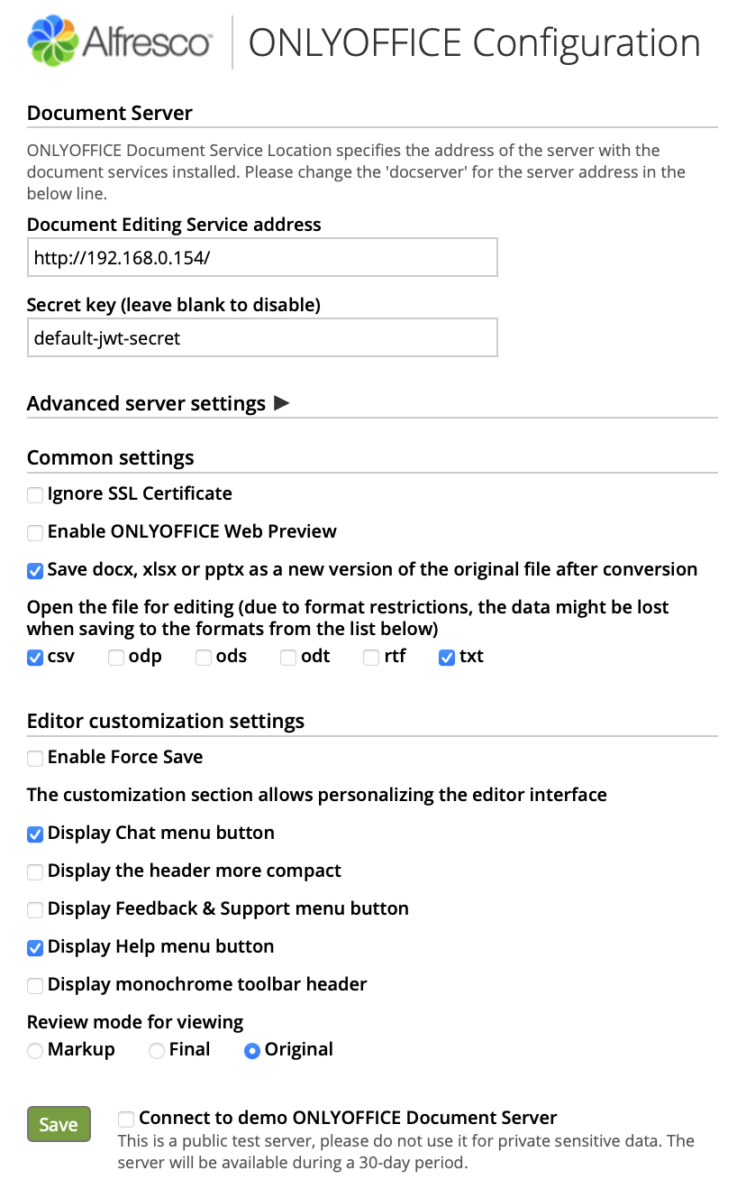

I noticed the JWT Error in the error.log, so I changed the field on the connector settings to match the local.json, but that threw this error:
“The document security token is not correctly formed. Please contact your document server administrator. Press ‘OK’ to return to the document list.”
So now I’m more confused about how the JWT should be configured. Is it just a plain text string in both places?
Thanks,
Ah ha! So running sudo snap get onlyoffice-ds onlyoffice.jwt-secret and pasting the result into the ‘secret key’ field gets me further, but I’m still getting the first two error messages.

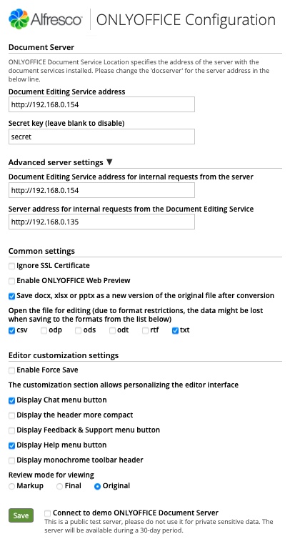

It’s possible that the problem lies here:

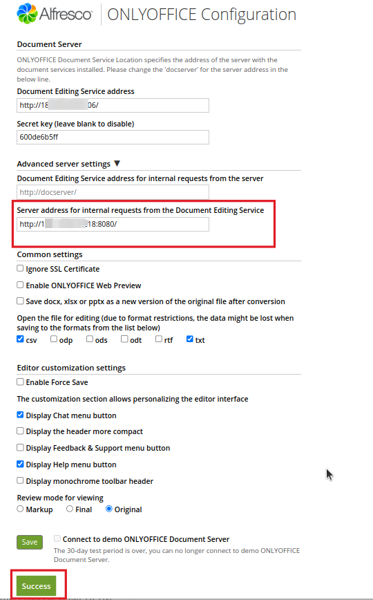

  • Document Editing Service address for internal requests from the Alfresco server - specify the address that is used to access Document Editing Service from Alfresco server.
  • Alfresco server address for internal requests from the Document Editing Service - specify the address that is used to access Alfresco server from Document Editing Service.
And you still haven’t sent a screenshot of a successful connection check after pressing the ‘save’ button).
This is strange. I added the URLs to the advanced section, and it seems to be working now, but I still don’t see a ‘Success’ on the configuration page. And there are no more errors in the log file. Does this mean it’s working properly?
Update:
With these settings I see ‘Success’ at the top for about five seconds (It’s just under the Alfresco logo) but I still can’t edit or save and I get the same error messages as originally reported. I set the secret to ‘secret’ on the configuration page and in the local.json file.
@Iain
Please open the ‘advanced server settings’ section and show it to us.
