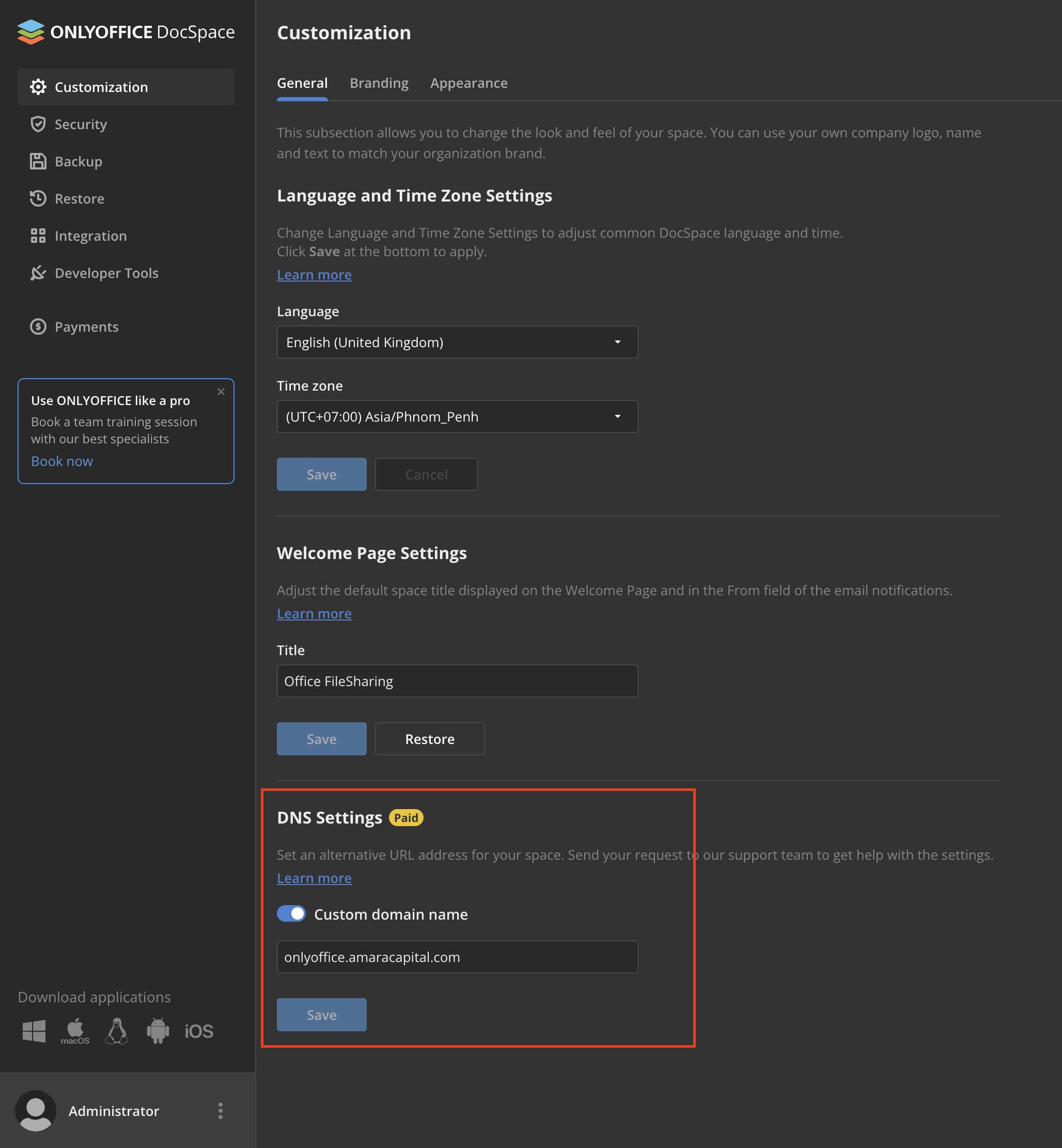

It’s working fine with IP but I have problem when change the dns setting and config host file from my local trying to access to domain it wont work and got 504 Gateway Time-out

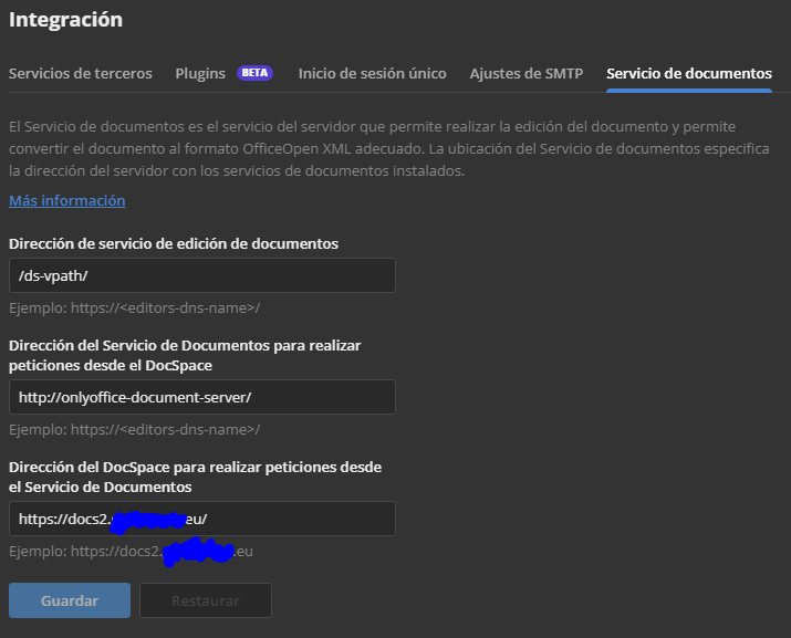

Switched to HTTPS the whole installation and same behaviour. Integration settings looks like this:
Any idea?

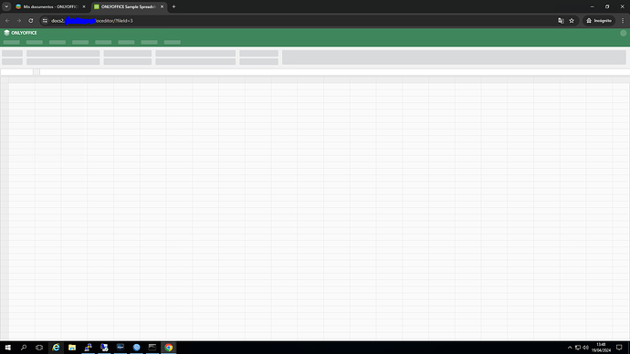

If I access DocSpace from my local network with my local DNS pointing to the nginx reverse proxy everything works fine. Document editor opens extremely fast and all works wonders. But if I try to do so on another local network (so external connection) Document editor hangs on this state for like 30-120s (or more) and (normally) finally loads the Document:
