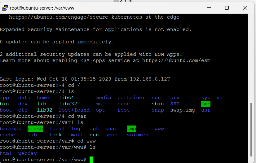

Right @Nikolas, but I don’t have that directory on my server ( */var/www/onlyoffice/WebStudio/):
Is it located inside the container? How should I proceed? I have the docker installation, running under Ubuntu server.
