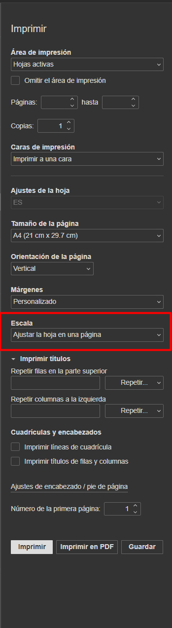

By default when you click print it appears in this option.
I need it to be set by default with the option “Fit the sheet on one page” since it is the only way that the footer appears when you print the document.

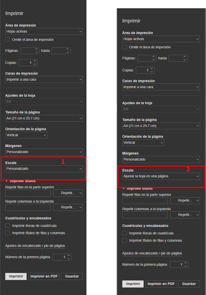

By default it loads the scale with this configuration option 1 and having to change the scale so that it prints well to the option “Fit the sheet on one page” option 2

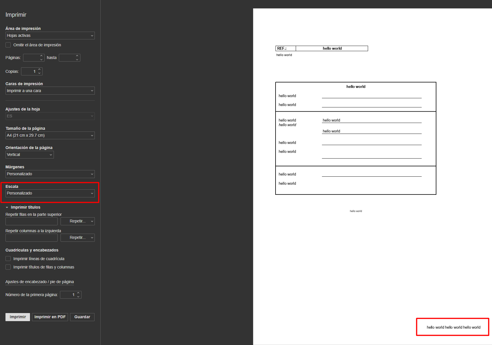

Do you have mentioned footer issue with this file? The preview shows the footer with all available scaling options.
When you click print and it shows the preview, it does show, but when you print it in PDF with the custom scaling, which is the default option, it does not show it to you.

But if you change the scaling option “Fit the sheet on one page” if it shows the footers
