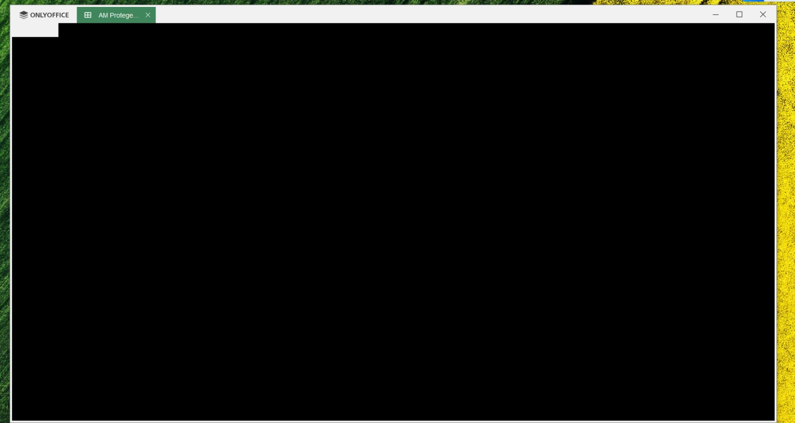

Black screen in the main console or at any document opening
Hello I am having this issue with a new installation on a new computer. All I get is a black screen in the main Console or any document I try to open.
I tried already to redo installation or reboot, install and launch as Admin, etc, nothing works.

Hello Nikolas. I appreciate your help. Here are more info as per your requests.
  1. Done, please watch here.
  2. Acer Nitro 5 laptop, 32gb RAM, Win 10 Home 22H2, one monitor connected via HDMI. Resolution 1920x1980. Scale I tested 125% and 100% with same results.
  3. Tried both. Both give same result. In the video is the EXE that runs.
  4. Debug mode also shows a black screen in the console :frowning:
  5. Issue presists when I resize or I move to the external monitor.

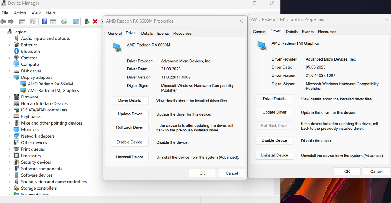

Alright, we’ve determined that the problem is related to the video kernel.
  1. Could you please confirm if you have the latest drivers installed for your video adapter? If the drivers are outdated, please update them.
  2. Please attach a similar screenshot.
To access Device Manager, press Win + R, then type devmgmt.msc and press Enter.
  1. Additionally, could you please provide a screenshot of your graphics settings?
System > Display > Graphics > Change default graphics setting
