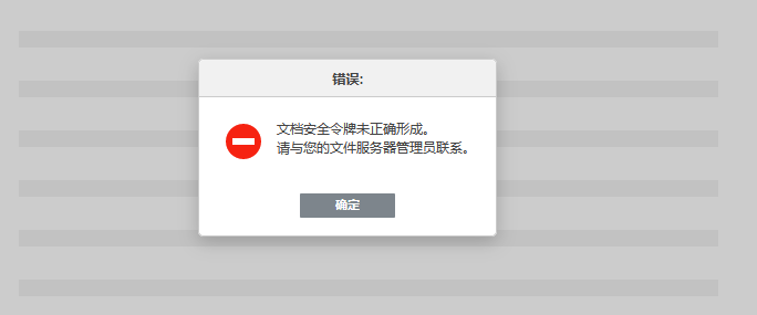

The previous ones have been handled properly,Now there is a new problem that appears when I use the network disk to call
微信截图_20230904142709
Is it a JWT issue? How can I close it?

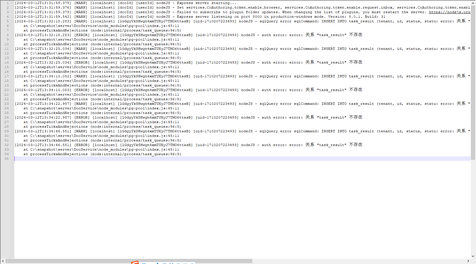

Hello @laowu
I believe we have to take a look at Document server logs when the situation is reproduced. Please provide us with them, for Windows they are located here: Program Files (x86)\Ascensio System SIA\DocumentServer\Log
[2023-09-04T09:53:16.366] [WARN] [localhost] [docId] [userId] nodeJS - Express server starting…
[2023-09-04T09:53:16.370] [WARN] [localhost] [docId] [userId] nodeJS - Failed to subscribe to plugin folder updates. When changing the list of plugins, you must restart the server. File system | Node.js v20.6.0 Documentation
[2023-09-04T09:53:16.777] [WARN] [localhost] [docId] [userId] nodeJS - Express server listening on port 8000 in production-windows mode. Version: 7.4.1. Build: 36
[2023-09-04T11:29:51.971] [WARN] [localhost] [701d1c434fe8eeba14d3] [userId] nodeJS - checkJwt error: name = JsonWebTokenError message = jwt must be provided token = undefined
[2023-09-04T11:29:59.518] [WARN] [localhost] [c0daa705d89380330ca0] [userId] nodeJS - checkJwt error: name = JsonWebTokenError message = jwt must be provided token = undefined
[2023-09-04T11:31:07.807] [WARN] [localhost] [ddc068b60ca741420e08] [userId] nodeJS - checkJwt error: name = JsonWebTokenError message = jwt must be provided token = undefined
[2023-09-04T11:39:59.333] [WARN] [localhost] [2000ffaa1d0dc42d774a] [userId] nodeJS - checkJwt error: name = JsonWebTokenError message = jwt must be provided token = undefined
[2023-09-04T11:41:58.192] [WARN] [localhost] [6e439c2b1853149aa315] [userId] nodeJS - checkJwt error: name = JsonWebTokenError message = jwt must be provided token = undefined
[2023-09-04T11:58:52.481] [WARN] [localhost] [41d4ab5ab0d9d1e08443] [userId] nodeJS - checkJwt error: name = JsonWebTokenError message = jwt must be provided token = undefined
[2023-09-04T11:58:57.774] [WARN] [localhost] [30bfb6bc4543ca3f6e30] [userId] nodeJS - checkJwt error: name = JsonWebTokenError message = jwt must be provided token = undefined
[2023-09-04T12:58:01.011] [WARN] [localhost] [172.16.106.15new__1_.docx11693798802072] [uid-1] nodeJS - error description: errorId = Update Version error
[2023-09-04T14:15:04.023] [WARN] [localhost] [172.16.106.15new__1_.docx11693798802072] [userId] nodeJS - checkJwt error: name = TokenExpiredError message = jwt expired token = eyJhbGciOiJIUzI1NiIsInR5cCI6IkpXVCJ9.eyJkb2N1bWVudCI6eyJkaXJlY3RVcmwiOiIiLCJmaWxlVHlwZSI6ImRvY3giLCJpbmZvIjp7Im93bmVyIjoiTWUiLCJ1cGxvYWRlZCI6Ik1vbiBTZXAgMDQgMjAyMyIsImZhdm9yaXRlIjpudWxsfSwia2V5IjoiMTcyLjE2LjEwNi4xNW5ld19fMV8uZG9jeDExNjkzNzk4ODAyMDcyIiwicGVybWlzc2lvbnMiOnsiY2hhdCI6dHJ1ZSwiY29tbWVudCI6dHJ1ZSwiY29weSI6dHJ1ZSwiZG93bmxvYWQiOnRydWUsImVkaXQiOnRydWUsImZpbGxGb3JtcyI6dHJ1ZSwibW9kaWZ5Q29udGVudENvbnRyb2wiOnRydWUsIm1vZGlmeUZpbHRlciI6dHJ1ZSwicHJpbnQiOnRydWUsInJldmlldyI6dHJ1ZSwicmV2aWV3R3JvdXBzIjpudWxsLCJjb21tZW50R3JvdXBzIjp7fSwidXNlckluZm9Hcm91cHMiOm51bGwsInByb3RlY3QiOnRydWV9LCJyZWZlcmVuY2VEYXRhIjp7ImZpbGVLZXkiOiJ7XCJmaWxlTmFtZVwiOlwibmV3ICgxKS5kb2N4XCIsXCJ1c2VyQWRkcmVzc1wiOlwiMTcyLjE2LjEwNi4xNVwifSIsImluc3RhbmNlSWQiOiJodHRwOi8vMTcyLjE2LjIwMC44MzoxMjM0L2V4YW1wbGUifSwidGl0bGUiOiJuZXcgKDEpLmRvY3giLCJ1cmwiOiJodHRwOi8vMTcyLjE2LjIwMC44MzoxMjM0L2V4YW1wbGUvZG93bmxvYWQ_ZmlsZU5hbWU9bmV3JTIwKDEpLmRvY3gmdXNlcmFkZHJlc3M9MTcyLjE2LjEwNi4xNSJ9LCJkb2N1bWVudFR5cGUiOiJ3b3JkIiwiZWRpdG9yQ29uZmlnIjp7ImFjdGlvbkxpbmsiOm51bGwsImNhbGxiYWNrVXJsIjoiaHR0cDovLzE3Mi4xNi4yMDAuODM6MTIzNC9leGFtcGxlL3RyYWNrP2ZpbGVuYW1lPW5ldyUyMCgxKS5kb2N4JnVzZXJhZGRyZXNzPTE3Mi4xNi4xMDYuMTUiLCJjb0VkaXRpbmciOm51bGwsImNyZWF0ZVVybCI6Imh0dHA6Ly8xNzIuMTYuMjAwLjgzOjEyMzQvZXhhbXBsZS9lZGl0b3I_ZmlsZUV4dD1kb2N4JnVzZXJpZD11aWQtMSZ0eXBlPWRlc2t0b3AmbGFuZz1lbiIsImN1c3RvbWl6YXRpb24iOnsiYWJvdXQiOnRydWUsImNvbW1lbnRzIjp0cnVlLCJmZWVkYmFjayI6dHJ1ZSwiZm9yY2VzYXZlIjpmYWxzZSwiZ29iYWNrIjp7InVybCI6Imh0dHA6Ly8xNzIuMTYuMjAwLjgzOjEyMzQvZXhhbXBsZS8ifSwic3VibWl0Rm9ybSI6ZmFsc2V9LCJlbWJlZGRlZCI6eyJlbWJlZFVybCI6Imh0dHA6Ly8xNzIuMTYuMjAwLjgzOjEyMzQvZXhhbXBsZS9kb3dubG9hZD9maWxlTmFtZT1uZXclMjAoMSkuZG9jeCIsInNhdmVVcmwiOiJodHRwOi8vMTcyLjE2LjIwMC44MzoxMjM0L2V4YW1wbGUvZG93bmxvYWQ_ZmlsZU5hbWU9bmV3JTIwKDEpLmRvY3giLCJzaGFyZVVybCI6Imh0dHA6Ly8xNzIuMTYuMjAwLjgzOjEyMzQvZXhhbXBsZS9kb3dubG9hZD9maWxlTmFtZT1uZXclMjAoMSkuZG9jeCIsInRvb2xiYXJEb2NrZWQiOiJ0b3AifSwiZmlsZUNob2ljZVVybCI6IiIsImxhbmciOiJlbiIsIm1vZGUiOiJlZGl0IiwicGx1Z2lucyI6eyJwbHVnaW5zRGF0YSI6W119LCJ0ZW1wbGF0ZXMiOlt7ImltYWdlIjoiIiwidGl0bGUiOiJCbGFuayIsInVybCI6Imh0dHA6Ly8xNzIuMTYuMjAwLjgzOjEyMzQvZXhhbXBsZS9lZGl0b3I_ZmlsZUV4dD1kb2N4JnVzZXJpZD11aWQtMSZ0eXBlPWRlc2t0b3AmbGFuZz1lbiJ9LHsiaW1hZ2UiOiJodHRwOi8vMTcyLjE2LjIwMC44MzoxMjM0L2V4YW1wbGUvadocservice—W1hZ2VzL2ZpbGVfZG9jeC5zdmciLCJ0aXRsZSI6IldpdGggc2FtcGxlIGNvbnRlbnQiLCJ1cmwiOiJodHRwOi8vMTcyLjE2LjIwMC44MzoxMjM0L2V4YW1wbGUvZWRpdG9yP2ZpbGVFeHQ9ZG9jeCZ1c2VyaWQ9dWlkLTEmdHlwZT1kZXNrdG9wJmxhbmc9ZW4mc2FtcGxlPXRydWUifV0sInVzZXIiOnsiZ3JvdXAiOiIiLCJpZCI6InVpZC0xIiwibmFtZSI6IkpvaG4gU21pdGgifX0sImhlaWdodCI6IjEwMCUiLCJ0b2tlbiI6IiIsInR5cGUiOiJkZXNrdG9wIiwid2lkdGgiOiIxMDAlIiwiaWF0IjoxNjkzODAwMDAzLCJleHAiOjE2OTM4MDAzMDN9.Vj-1W1wf54Z-KRIcvvAILktHVKlwZm1h9ZH-g0BiPK8
[2023-09-04T14:19:58.776] [WARN] [localhost] [002111f2502b47dd1ef7] [userId] nodeJS - checkJwt error: name = JsonWebTokenError message = jwt must be provided token = undefined
[2023-09-04T14:24:39.310] [WARN] [localhost] [ee18acaa0516fbbe3a8e] [userId] nodeJS - checkJwt error: name = JsonWebTokenError message = jwt must be provided token = undefined
[2023-09-04T14:50:59.999] [WARN] [localhost] [a20e08fdeee09bc077ca] [userId] nodeJS - checkJwt error: name = JsonWebTokenError message = jwt must be provided token = undefined
[2023-09-04T15:04:55.533] [WARN] [localhost] [ae67fcf4d0b83ad3b159] [userId] nodeJS - checkJwt error: name = JsonWebTokenError message = jwt must be provided token = undefined
[2023-09-04T15:10:15.595] [WARN] [localhost] [6fc5d3a1834df0ca46f0] [userId] nodeJS - checkJwt error: name = JsonWebTokenError message = jwt must be provided token = undefined
[2023-09-07T08:35:59.126] [WARN] [localhost] [61947c1f1d9edc644db9] [userId] nodeJS - checkJwt error: name = JsonWebTokenError message = jwt must be provided token = undefined
Do you check integrated example? Please compare JWT secret between these files, it should match on both sides:
