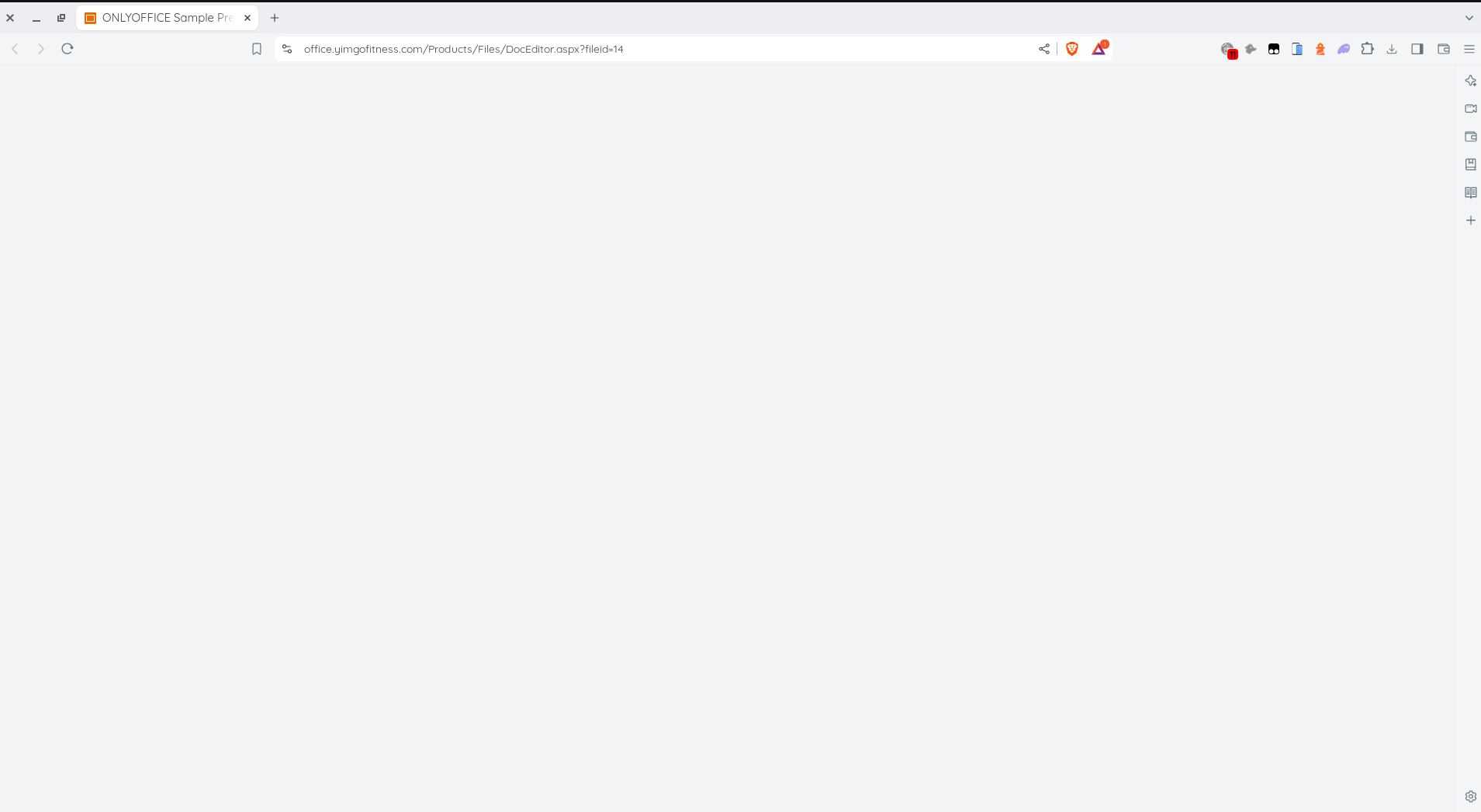

Videos and audio are displayed fine in the file browser, but “editable” files like powerpoints, word or excel open up a blank page. When I download them I can see the real content, but the web editor (also the official app editor) display a completely blank document, not even showing the editor.
As said, the editor is not displayed at all, neither the file. But when downloaded I can see it’s content.
This is how it looks in the web/app editor

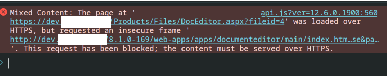

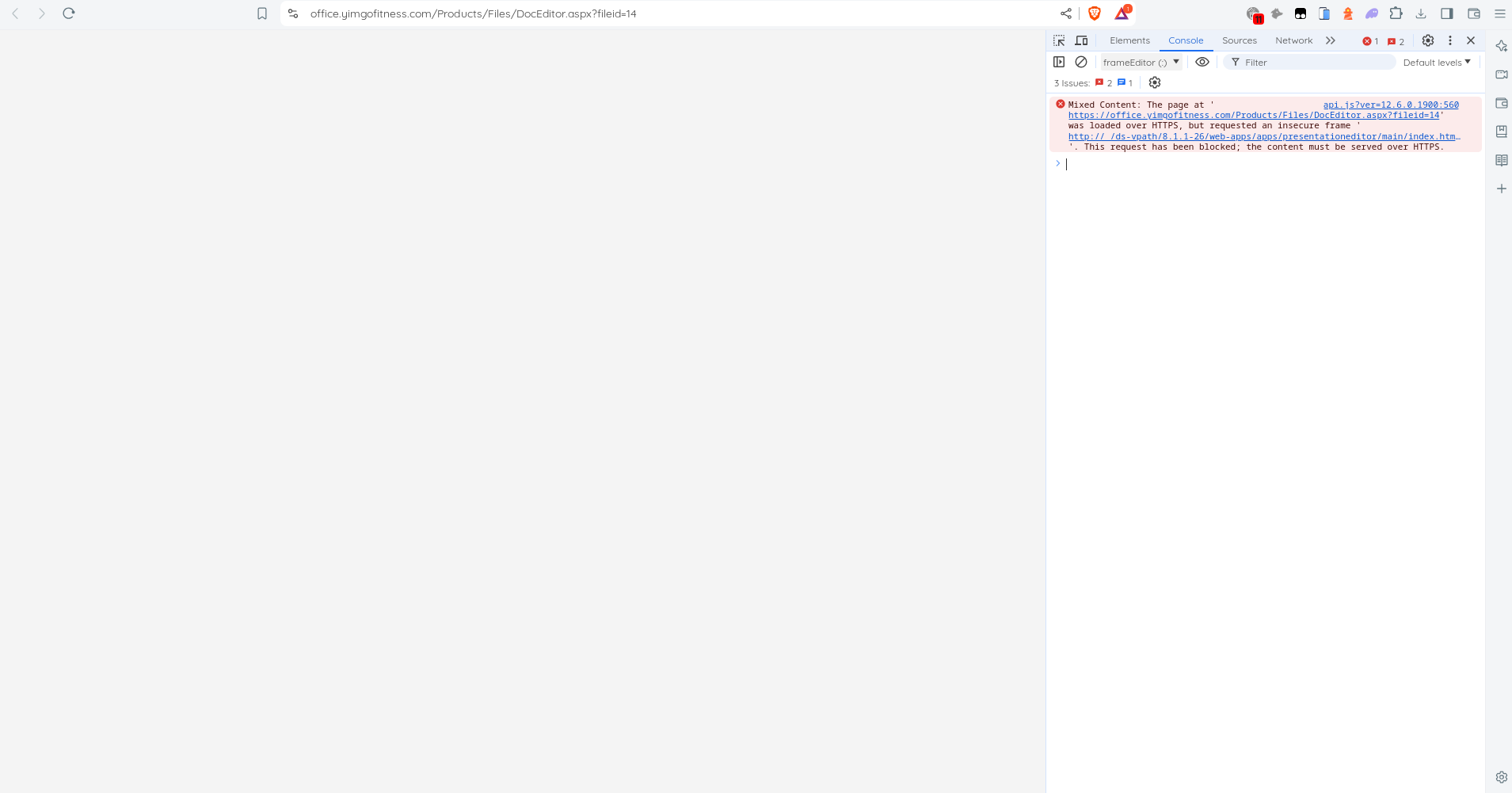

This is what happens in the console.

Mixed Content: The page at
Regarding the “Mixed Content” error, this typically occurs when data is transferred from an HTTPS service to an HTTP service. This transfer is insecure, and most browsers will block it. Often, this issue is related to your proxy settings and network configuration.
