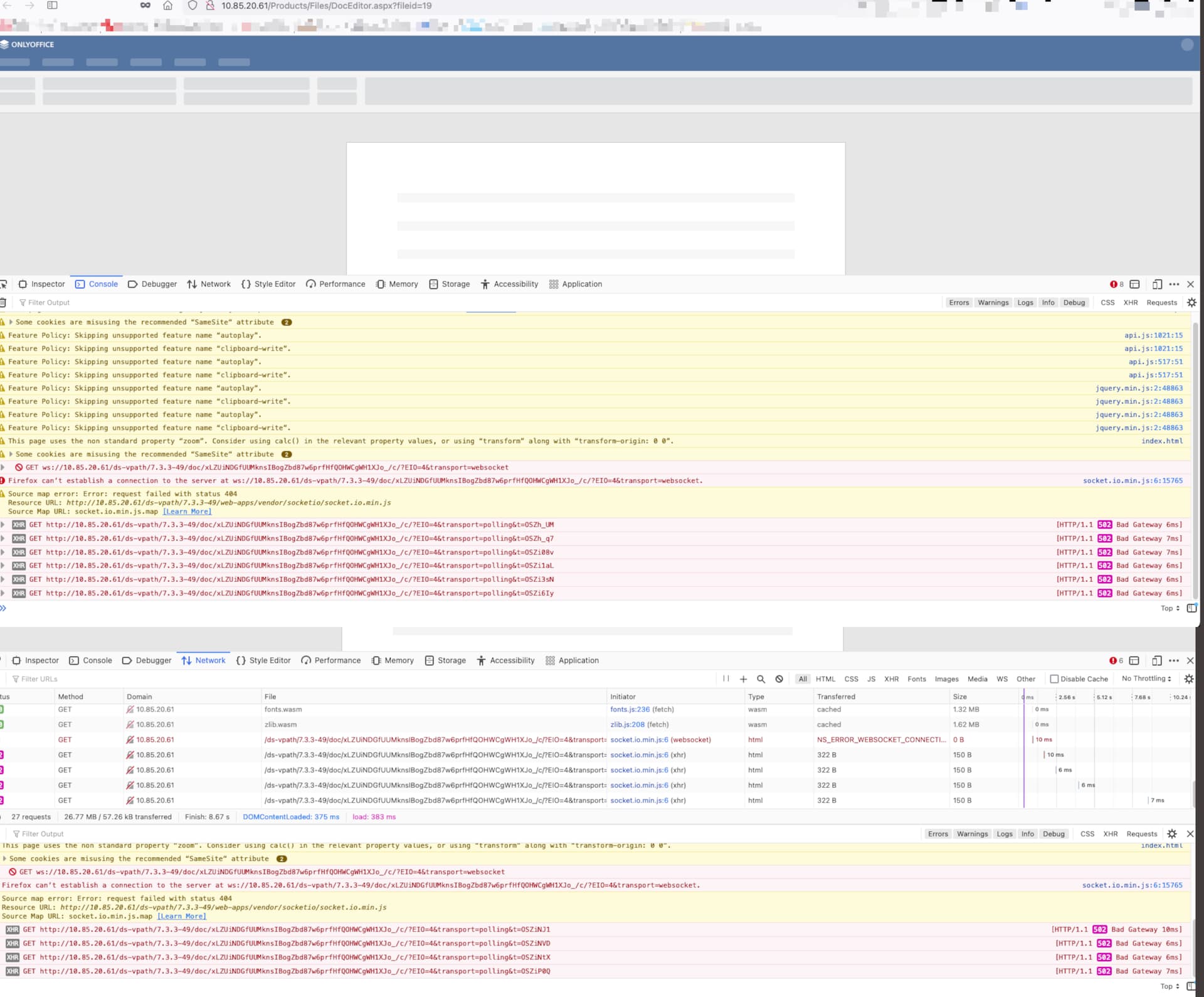

  2. To get better understanding please provide screenshots of browser’s console Network and Console tabs.:
To do these screenshots please follow this scenario:
2.1 Open any document in the editor to reproduce the issue;
2.2 Open browser’s console (F12 in Chrome/Firefox/Edge);
2.3 Reload the page;
2.4 Make screenshots of Network and Console tabs of browser’s console.

Below you will find the screenshots you requested

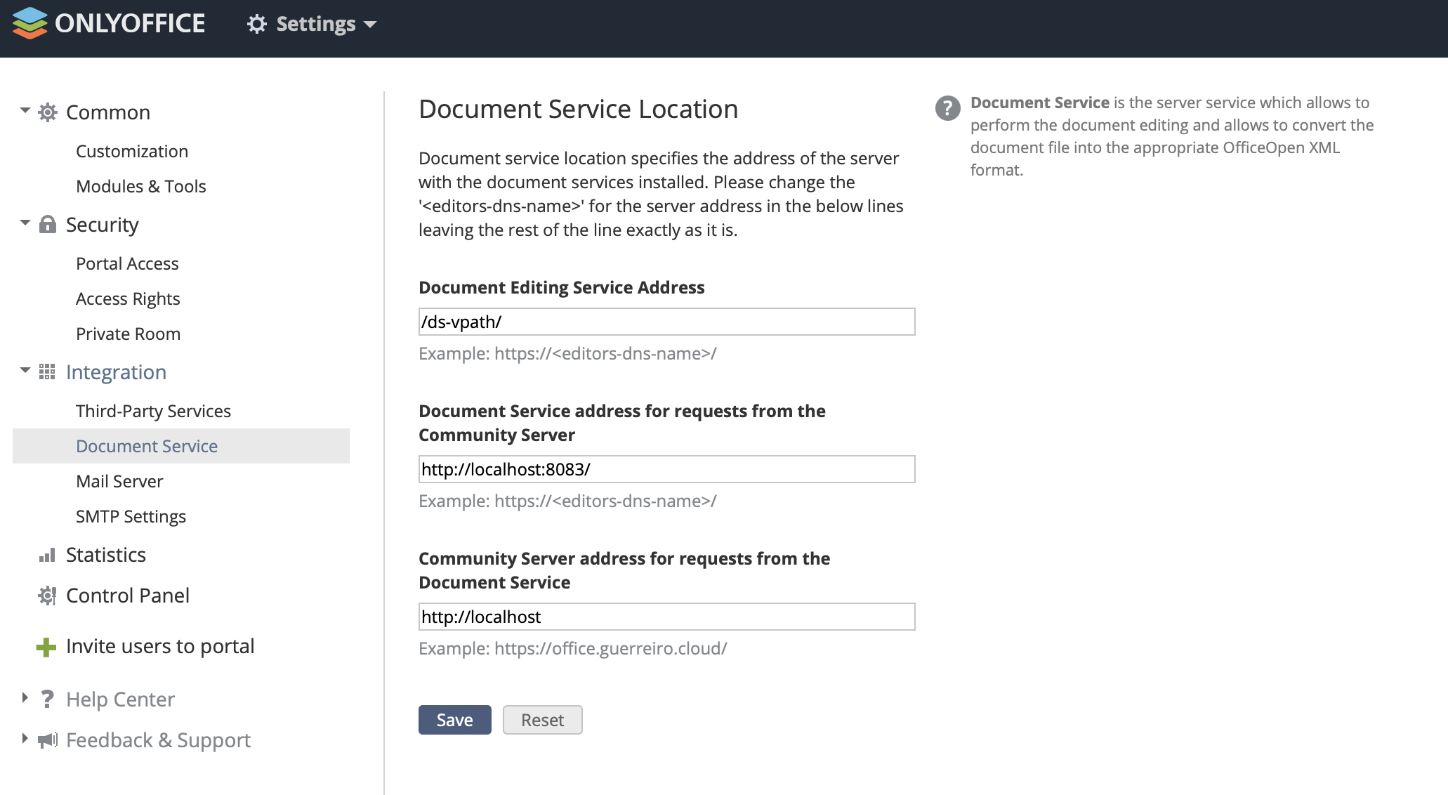

Screenshot of the settings for integration with the document server:
settings > Document service > Document service location

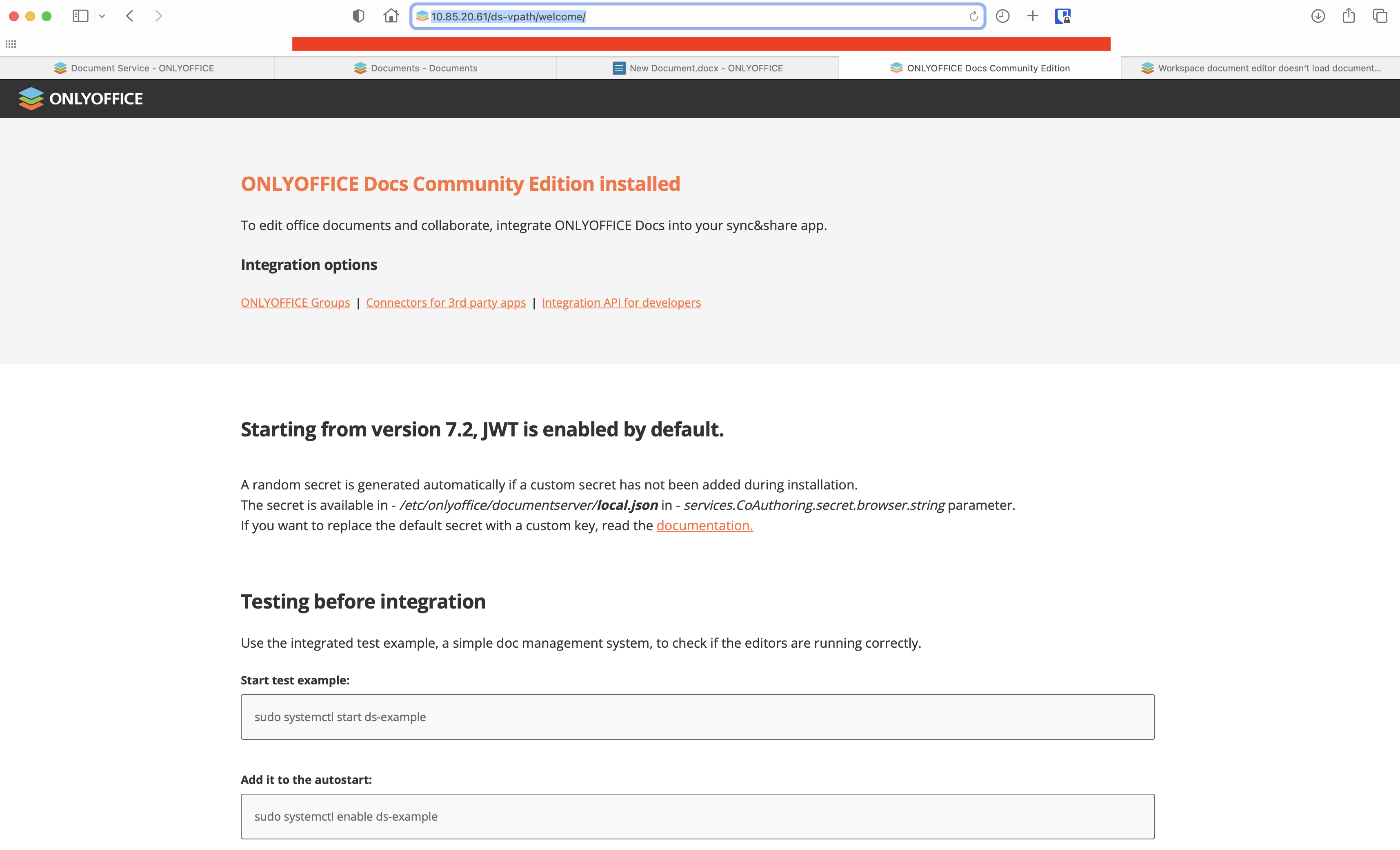

And I tried to open the document-server page on my browser and it opened.
