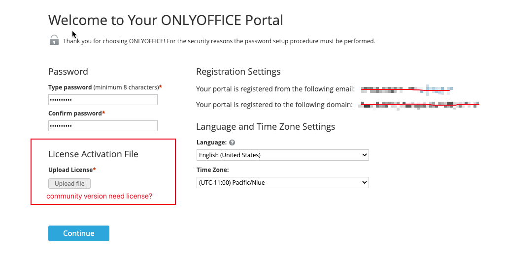

Workspace community need license?
Do you want to: Report a bug
For feature suggestions, describe the result you would like to achieve in detail: boston@u1s1.biz
For bug reports, provide the steps to reproduce and if possible a minimal demo of the problem: Workspace community need license?
Community Server/Control Panel version: 12.5.2-637/3.5.0-516

Hi @boston,

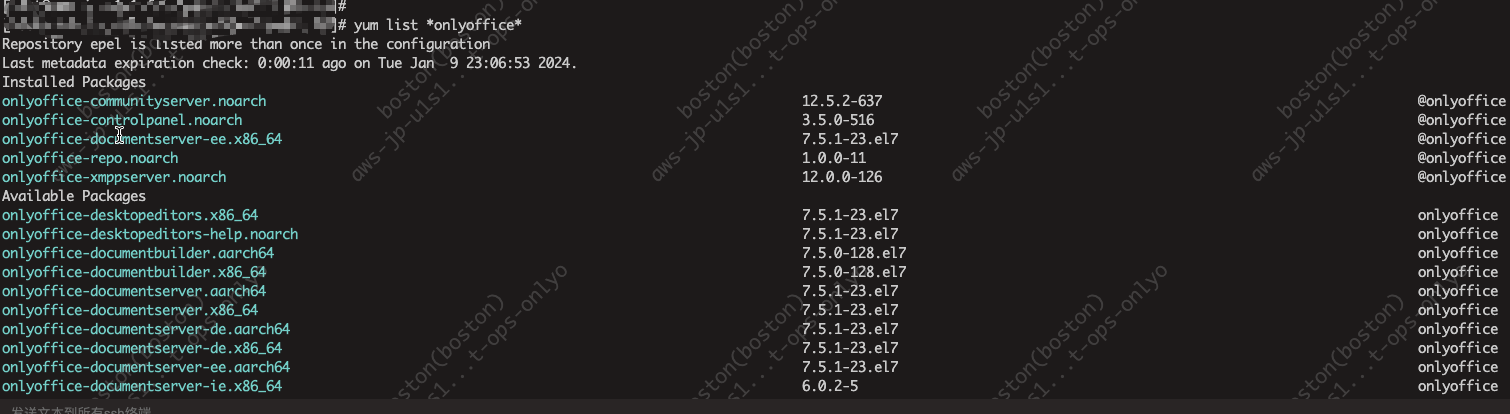

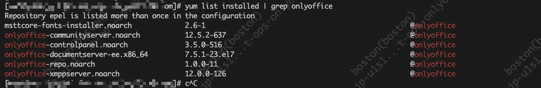

Workspace Community Edition should not require a license file. Please provide the output of the command yum list installed | grep onlyoffice
It seems you have installed ONLYOFFICE Workspace Enterprise Edition because the Document Server package on your server is onlyoffice-documentserver-ee.
