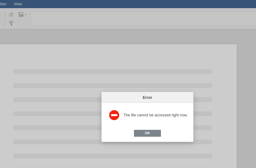

Hi,
I have installed OnlyOffice Docs V7.4.1 and enabled Wopi in default.json. But when i try to create new document on wopi page (document server example) i get this error
Can anyone please know how to solve this? Thanks.

Hello, although I am not in the same deployment environment as the original questioner, I have also encountered the issue of “The file cannot be accessed right now”.
My log shows that
2025/01/17 03:06:30 [error] 1371#1371: *32 open() “/var/www/onlyoffice/documentserver/web-apps/vendor/socketio/socket.io.min.js.map” failed (2: No such file or directory), client: 172.17.0.1, server: , request: “GET /8.2.0-789a9259906be7e3e2a8f2e32ceba725/web-apps/vendor/socketio/socket.io.min.js.map HTTP/1.1”, host: “localhost:8080”
[2025-01-17T03:06:34.857] [ERROR] [localhost] [yc1359] [uid-1737081735974] nodeJS - dnsLookup error: hostname = http Error: getaddrinfo ENOTFOUND http
at GetAddrInfoReqWrap.onlookup [as oncomplete] (node:dns:71:26)
[2025-01-17T03:06:34.857] [WARN] [localhost] [yc1359] [uid-1737081735974] nodeJS - checkIpFilter error: url = http://http://localhost:8080
If you can identify the problem, I would greatly appreciate it :blush:
Hello @She
The connection between Document Server and your app tries to use ‘http’ as domain name that seems incorrect. Please try to check your DNS settings, Document Server doesn’t know what ‘http’ domain is.
