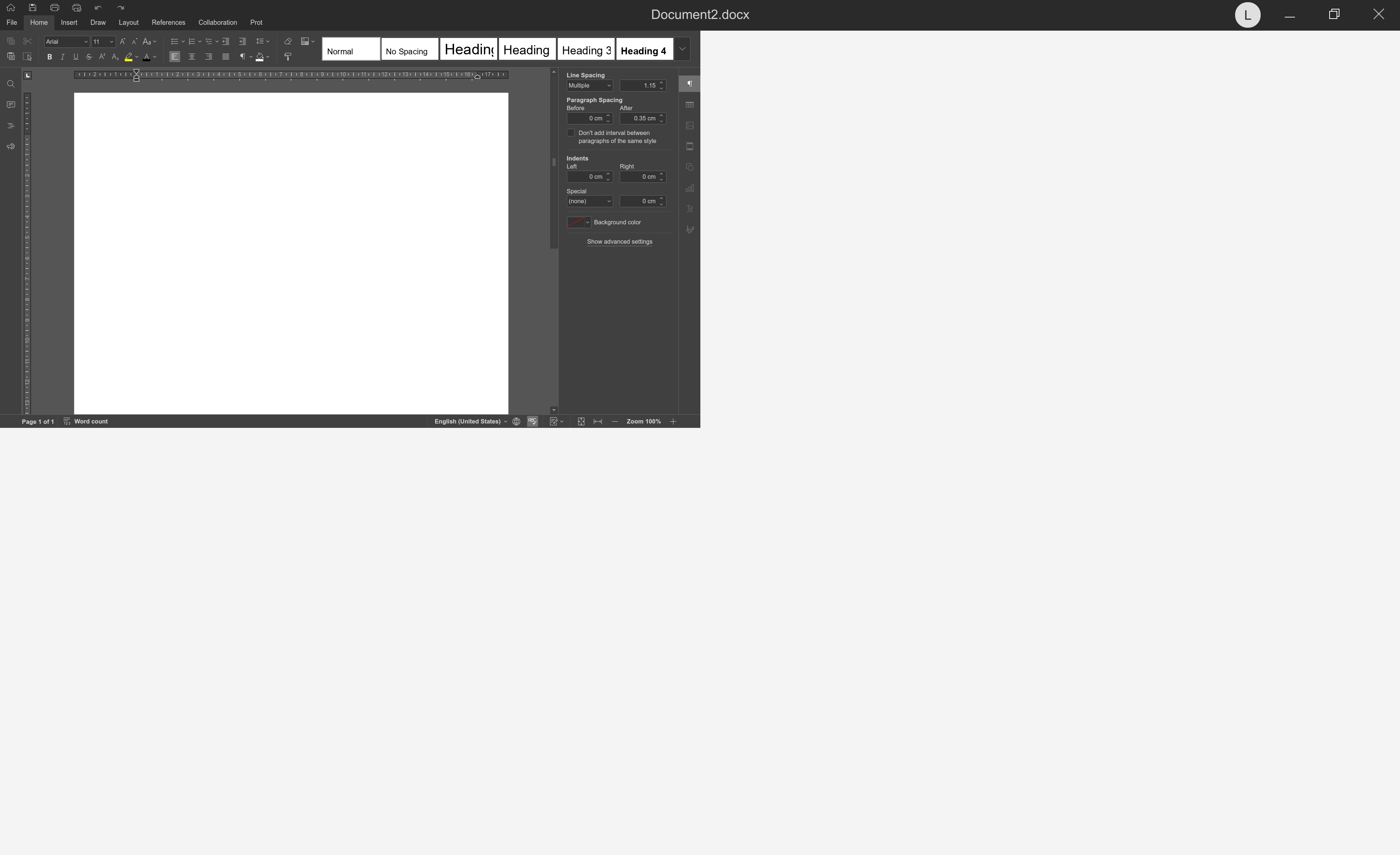

I’m calling out 4k multi-screen desktops because it works fine on a single 1080p screen.
All apps (doc, ss, pp) work the same way including the initial open screen.
As you can see the app does not use the entire window that is called out from the window manager. And the usable space will scale proportionally to the window size, never using the whole window.
The computer is a Dell XPS laptop using GeForce RTX 3060 laptop GPU (v 525.125.06 drivers)
What’s going on here?

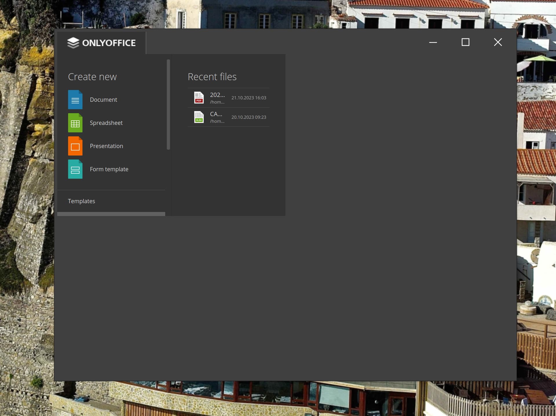

I included the desktop background so you can see the issue more clearly.
The application calls up a window of a certain size (dark gray area), but only uses a small portion of that window. If you resize the dark gray area the used space scales with it and never uses the whole thing. It’s as if the scaling math is wrong somewhere.
Additionally, if you grab the top control bar to move the window, as soon as the mouse moves, the application window jumps down and to the right by about the same proportion that the application window is off.

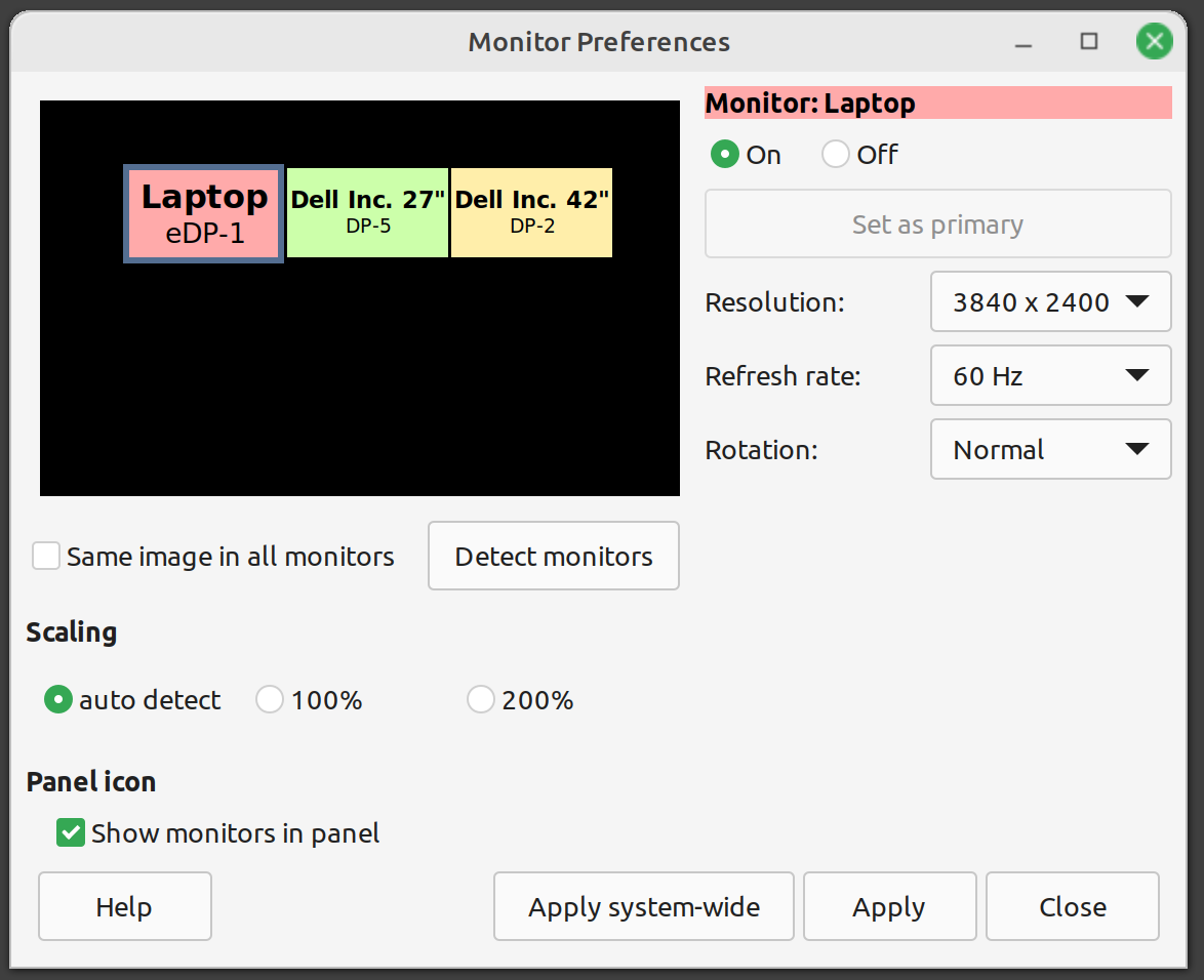

  1. Model type
    eDP-1 = Dell XPS-17 - 9720
    DP-2 = Dell P2723QE
    DP-5 = Dell U4320Q
2&3) Display sizes
~$ xrandr
Screen 0: minimum 320 x 200, current 11520 x 2400, maximum 16384 x 16384
eDP-1 connected primary 3840x2400+0+0 (normal left inverted right x axis y axis) 366mm x 229mm diag 431.7mm
DP-2 connected 3840x2160+7680+96 (normal left inverted right x axis y axis) 941mm x 529mm - diag 685mm
DP-5 connected 3840x2160+3840+96 (normal left inverted right x axis y axis) 597mm x 336mm - diag 1079.5mm
-also-
~$ xrandr --listmonitors
Monitors: 3
0: +*eDP-1 3840/366x2400/229+0+0 eDP-1
1: +DP-2 3840/941x2160/529+7680+96 DP-2
2: +DP-5 3840/597x2160/336+3840+96 DP-5
  1. Auto for each monitor
