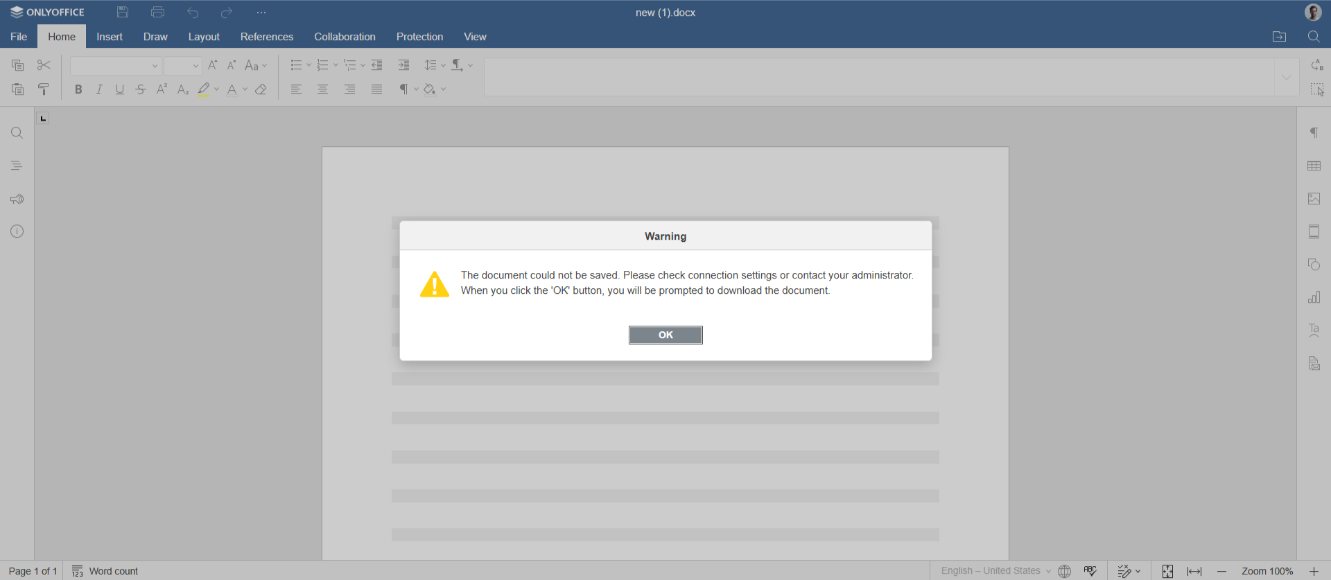

i created docker image and run as per your installation guides but i getting error while open editor and upload and open document ,please give me solution asap ,i atteched screenshot below
Hello there.
Please post your compose files for Nextcloud and Onlyoffice containers. Redact sensitive information if necessary.
Do your use a proxy? If so, please post your config regarding access to the NC and OO containers.
@rohan Please create a new topic for this issue, as it is unrelated to the original discussion. There provide the following info:
  1. Document Server logs from /var/log/onlyoffice/documentserver (inside the container).
  2. What is the OS on which you are running Document Server?
  3. What do you integrate Document Server with?
