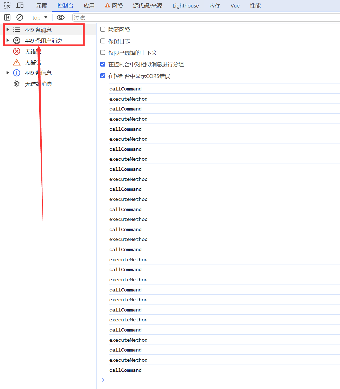

When the plugin enables the initOnSelectionChanged configuration, executing both executeMethod and callCommand causes an infinite loop of execution
Document Server version: 7.1.1
When I trigger the event initOnSelection Changed using the following code, the execute Method and call Command will loop infinitely.
Why is this happening? Is there any way to make them execute only once.
 window.Asc.plugin.init = function () {
      this.executeMethod(
        "GetCurrentContentControlPr", [], function (obj) {
          console.log("executeMethod");
      this.callCommand(() => {
        console.log("callCommand");

I have solved this problem and updated the version to 8.2.1. The new version does not have this bug.
